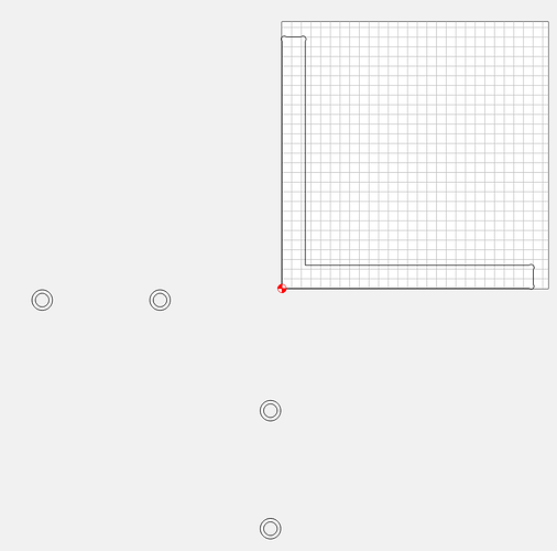

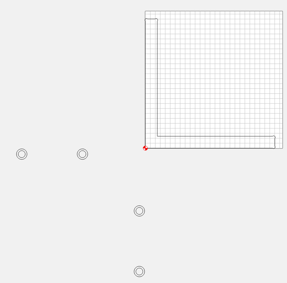

I was opening the files from a Cut Rocket project, Carbide3D Corner Square Pocket, and on both files the holes were off the board.
They work fine in V5

Jeffery
Confirmed. I have the same issue and can open it just fine in 5

Work-around is to open in the old version, export to SVG, then reimport in the new version and reassign the Toolpaths.
Having to muck with the toolpaths is a PITA…
I made easy realignment by:
  1. Open the file
  2. Ungroup the objects
  3. Regroup just the holes (keep them selected)
  4. Flip Horizontal and Vertical
  5. Add the Legs to the selection
  6. Align Centers
    Voila!

I think we found the problem. The fix will be in the next release.
