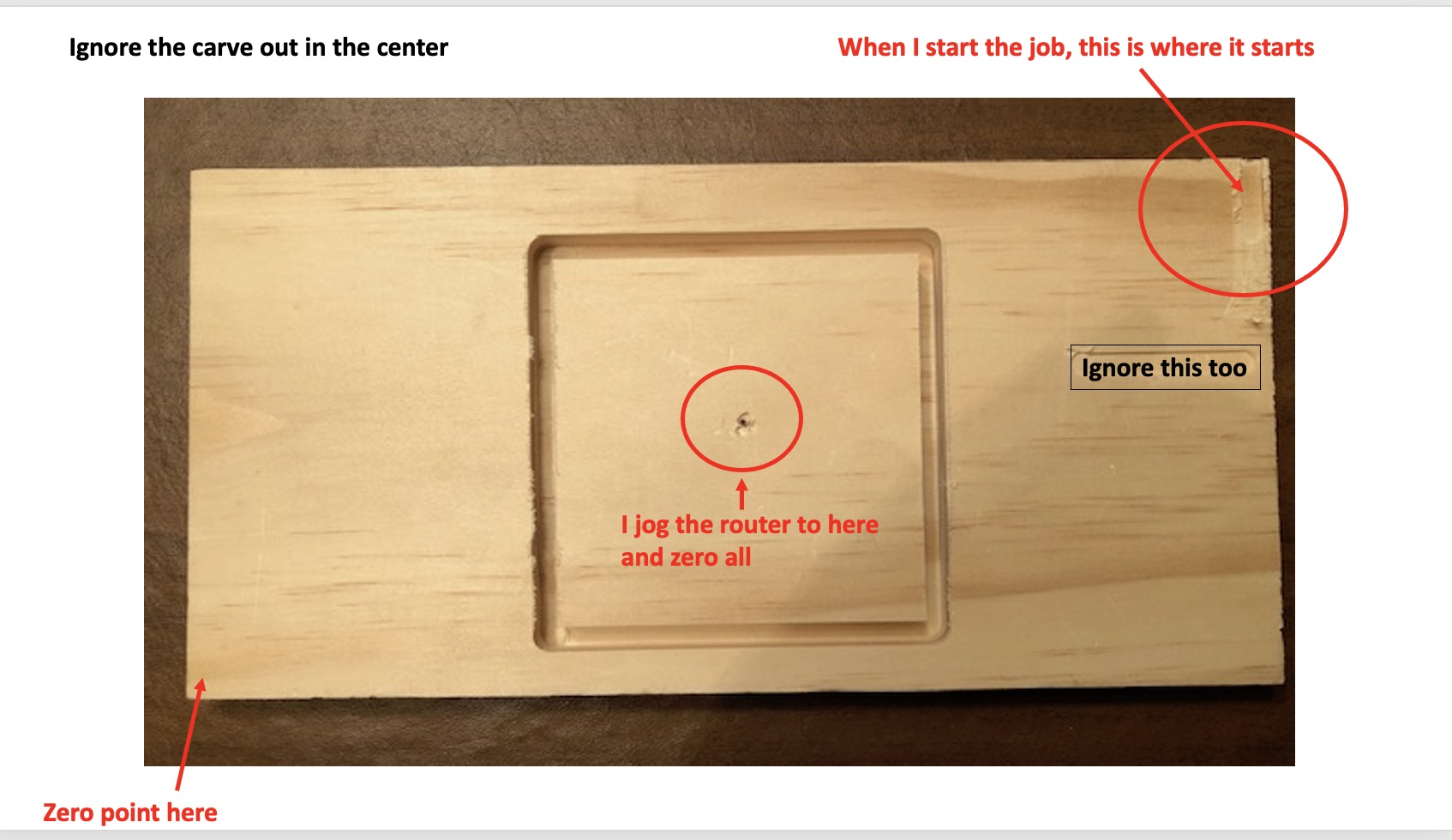

I’m getting closer but I don’t understand the lower portion of your response, specifically the zero point. How does that impact where the job starts? Based on the example, I am setting the router in the middle of the board. Doesn’t that dictate where the job will begin? How does the zero point move the starting point over a few inches?

Think of it this way: the zero point is just a reference to match the design (from Carbide Create) to the physical world. You set it in the lower left corner of the work area in CC, and you then set it some a specific location on the machine : after that the machine will move relative to that point. If a line in your design is 4 inches to the right of the zero in CC, it will be cut 4 inches to the right of the physical location you set your zeroes to on your machine, simple as that. In your example, the machine needs to cut a T that is placed a few inches to the right of the zero reference, so that’s where it will go upon starting the job, it has no reason to go to the zero point you set, this is just a reference and there is nothing to cut there.

i want to make sure i’m describing this correctly so here is an image to help explain what i’m experiencing!
screenimage|690x399
is that what i should be encountering/
thanks!
If you selected the lower left corner as your toolpath zero point in CC then that is where you would jog your router to to set your X, Y, Z zero in CM.
Thanks Ed.E!!
thought the picture might help … that was the part i was missing. i think i finally understand it now although i’m sure there are plenty of challenges ahead.
