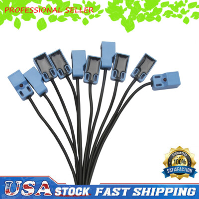

Is there an after market source for the proximity sensors that are used on these machines? Im still waiting on C3D to get back to me to replace one. I was thinking if I can buy them in bulk to have on hand when one fails. They seems to fail more often than I would like. I hate to be stuck trying to do a project waiting on C3D to respond.

found that out…this time I book marked them for future use. Im pretty sure I have my issue narrowed down to a Z axis limit switch. Its kinda funny but I did call the TS phone line and got put in the Que yesterday. I still have not heard anything. It would have been nice to confirm my suspicion but I feel pretty good about it. ordered from C3D and also ordered limit switches from Ebay. You can get 10 for like 20 bucks. I just hope they fit this application. If not it’s only 20 dollars…nice to have them in house when you need them.
You could swap that proximity switch for another one to see if the problem follows the location or the switch.
Thats what I did and the issue followed the switch…
Bought some of the above…I hope they will work. If not it was only 22 dollars for 10. It will be nice to have spares.
