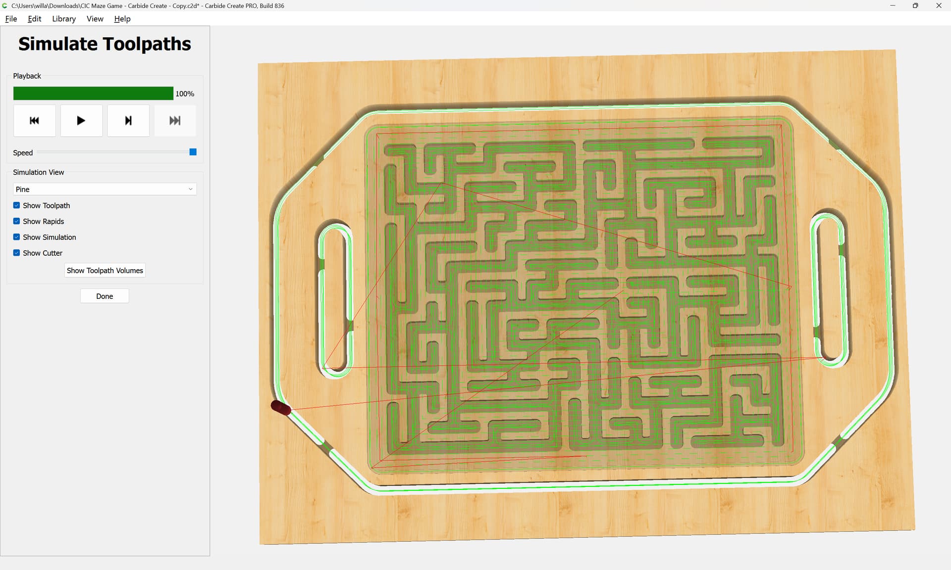

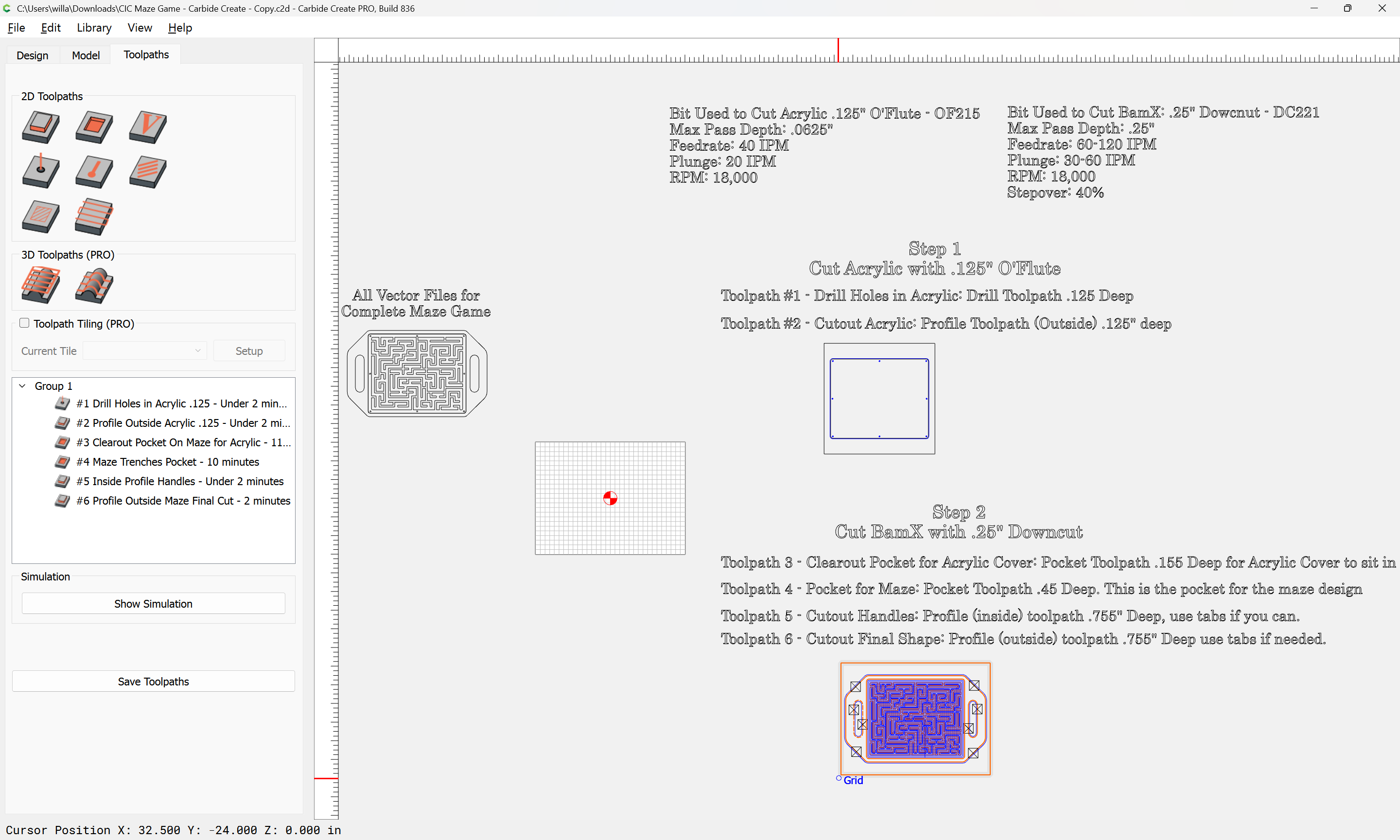

i just purchased i c2d file from CIC workshop, (maze file) when i got to toolpaths ,it is completely different then what i am used to , there are several images when you click on show stimulation the image is vertical in the top left corner, i got ready to preview it carbide motion and it said that it would hit the wall, please see file , and let me know what might wrong

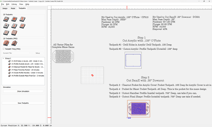

Your toolpaths are not on your gridline piece. You need to copy/paste the maze to your gridline piece and reassign the toolpaths to the appropriate vectors in the grid. Disable the acrylic toolpaths until you are ready to cut the acrylic and then do the same thing for the acrylic piece, i.e. reassign the vectors and enable the acrylic toolpaths and disable the maze toolpaths. Hope that makes sense.
Just acrylic
Maze Just Acrylic.c2d (2.2 MB)
BamX
Max Just BAM X part.c2d (2.2 MB)
I separated them into two files for you.

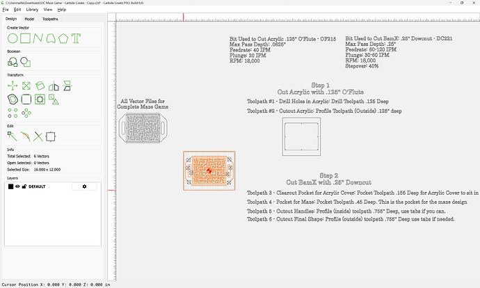

The file when opened:
Select the geometries which have toolpaths:
n
and move them into the Stock area:
