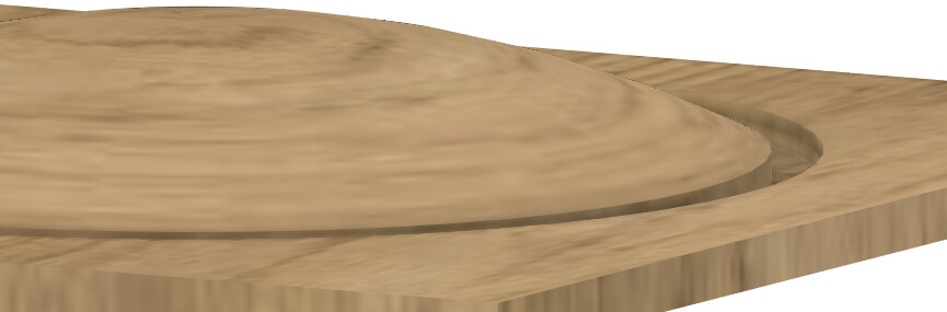

I cant. But imagine a wooden, rectangular stock. Then you carve a 3d half sphere over it and around the half sphere, a ‘ring’ or ‘channel’ whose walls have a 90’degree angle.
Like this?
Couldn’t you just create a separate vector to generate a pocket? Or profile, depending on need?
I would opt for a ball mill for finishing. If I understand, you’re carving a 2d+ relief, maybe a dome of some kind, concave or convex. The ball mills will usually offer a cleaner finish.
What you need to use in Vcarve Desktop is the Moulding Toolpath. It will create that dome for you. Then you run a profile or pocket toolpath to get that groove.
