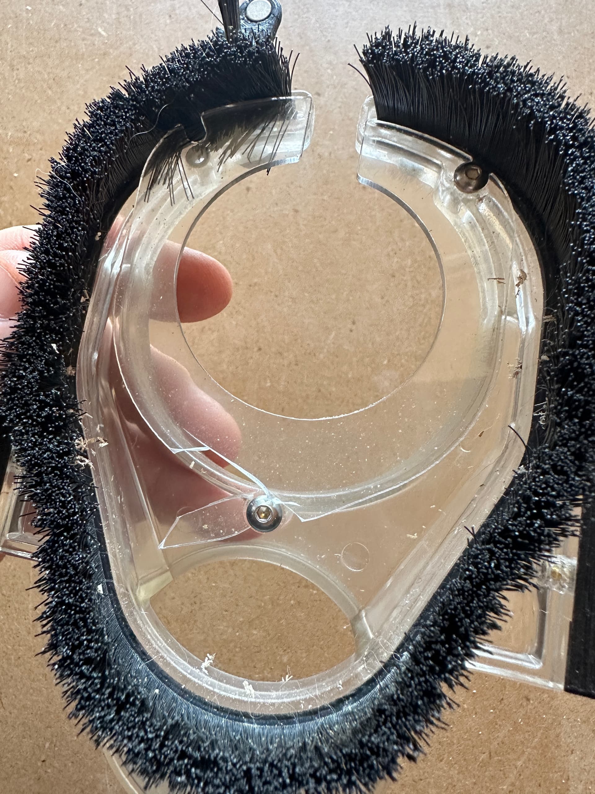

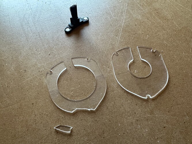

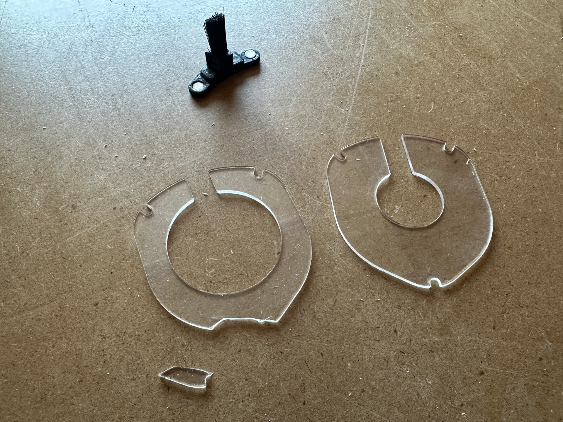

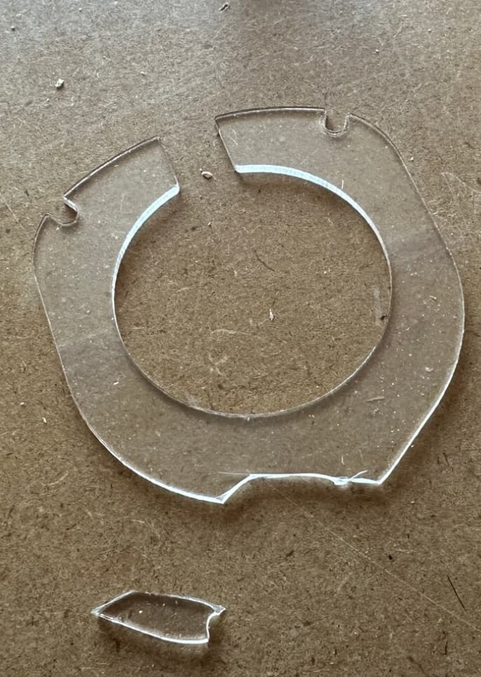

So, I’ve had my suckit dust boot since it’s creation all those years ago for my shapeoko 3 XXL and although it’s had it’s quirks - semi (imo) design flaws- it’s always worked for me. I’ve always just had the bigger opening shroud attached to the underside but it finally cracked. (photo for reference) I’ll attempt to repair it.
MY QUESTION:

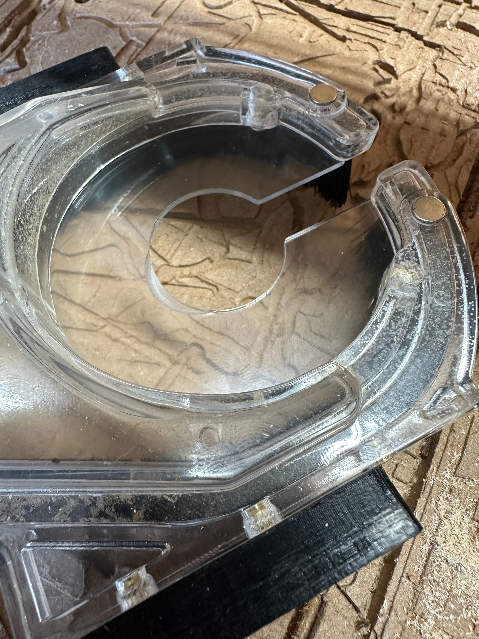

What exactly is the other shroud for? (see photo) When I purchased it all those years ago they gave me two of the smaller opening shrouds and only one of the larger opening.

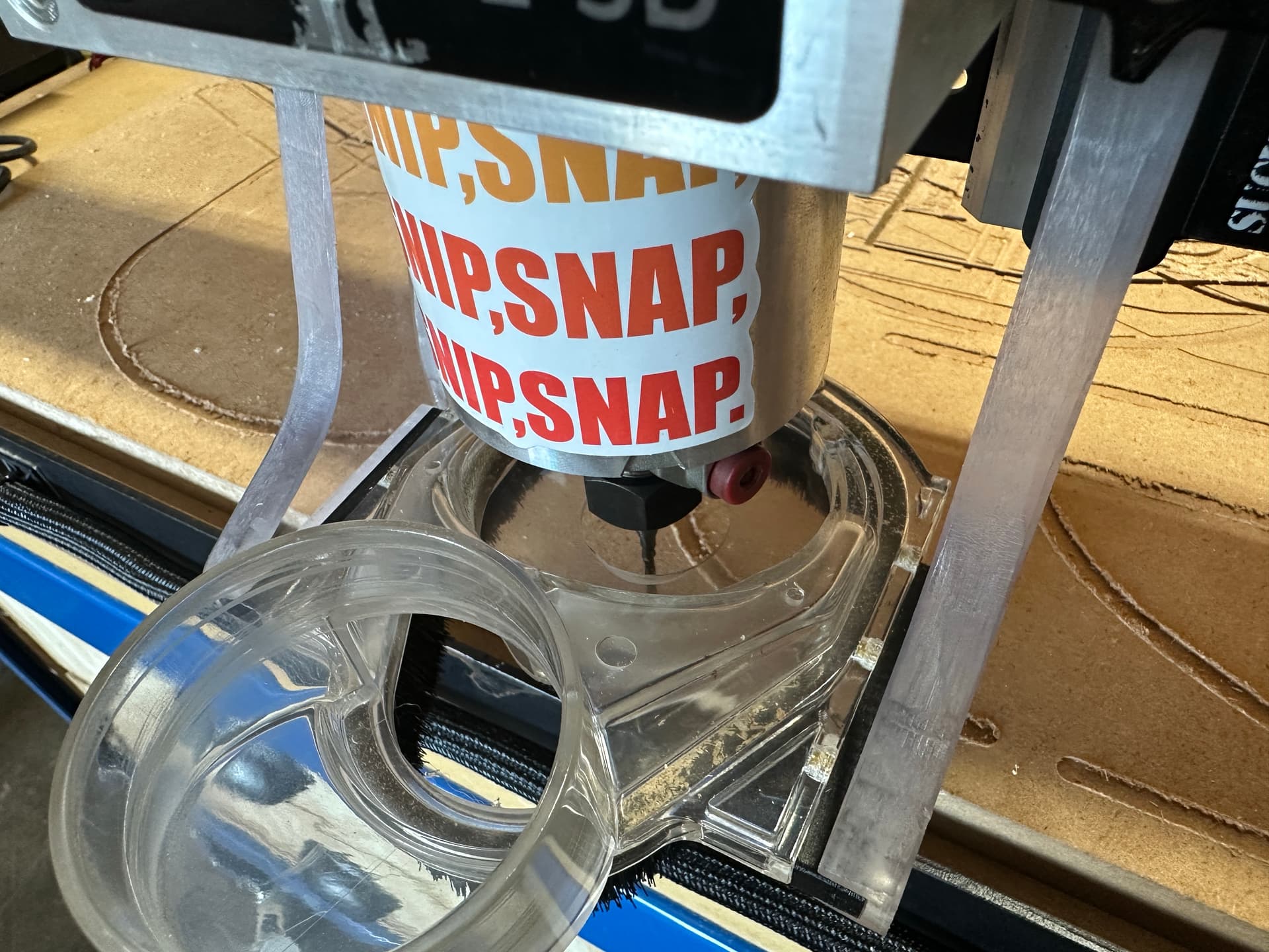

As you can see they do fit but if the cut goes pretty deep you can see how the collet of the makita router will rub into that shroud with the smaller opening.

If you are looking for another one of these parts:
You can use the undamaged one to make a template for cutting new ones.
Trace the undamaged one with a 0.3mm or 0.5mm pencil and then scan it (preferred) or take a picture from directly above it with a small ruler so you can get the proper scale.
Then you can use CC to trace it and then modify it to have any size opening you want.
EDIT: I use the small opening for longer 1/4" bits where the spindle doesn’t drop down through the hole. The smaller hole keeps more wood chips inside the boot than the large hole.
I use the larger hole for my small bits because the spindle needs to get close to the wood when the end mill is only 1/8 shank and 0.0150" cutting diameter.
