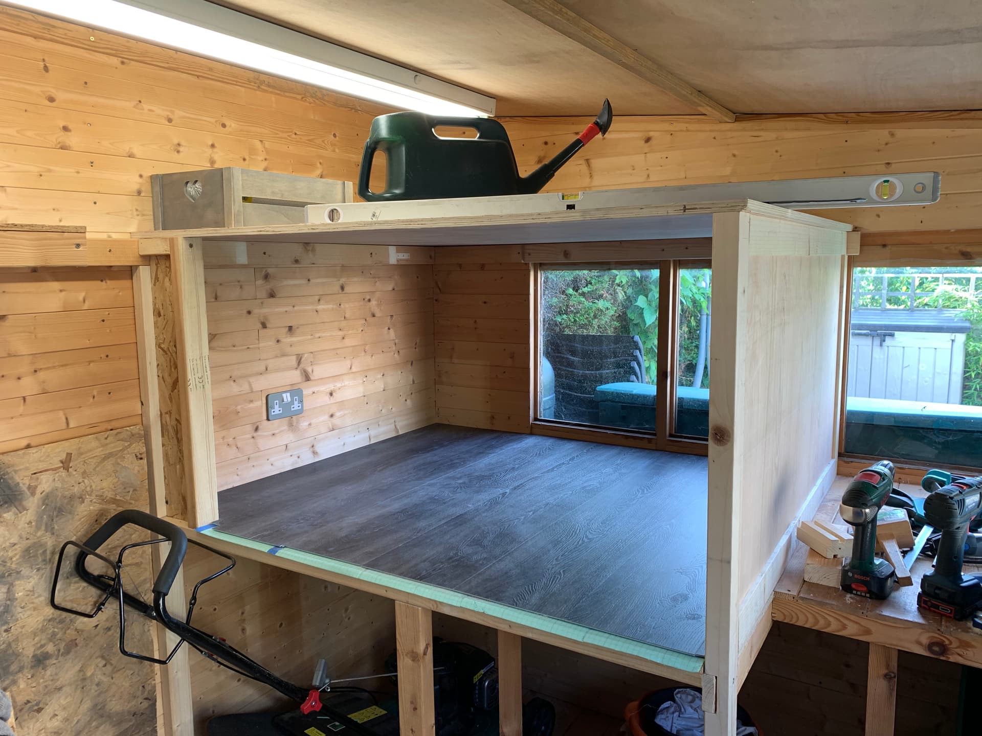

I had the same issue with the workbench in my garden shed, so extended part of it forward, like this:
I’ve since removed the enclosure, preferring amore effective dust extraction, and reduced the depth by about three inches so my Shapeoko sits flush with the edge of the workbench, as I was hoping to cut the edges of boards to produce fancy dovetail joints.
