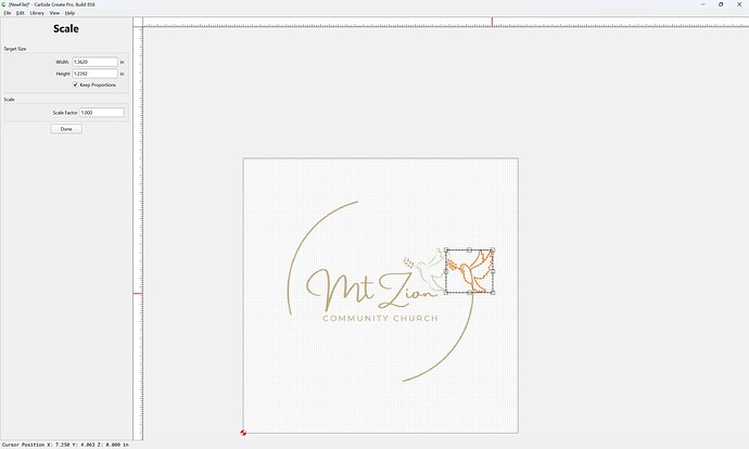

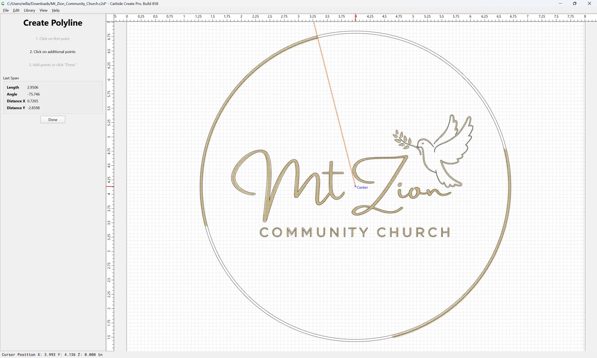

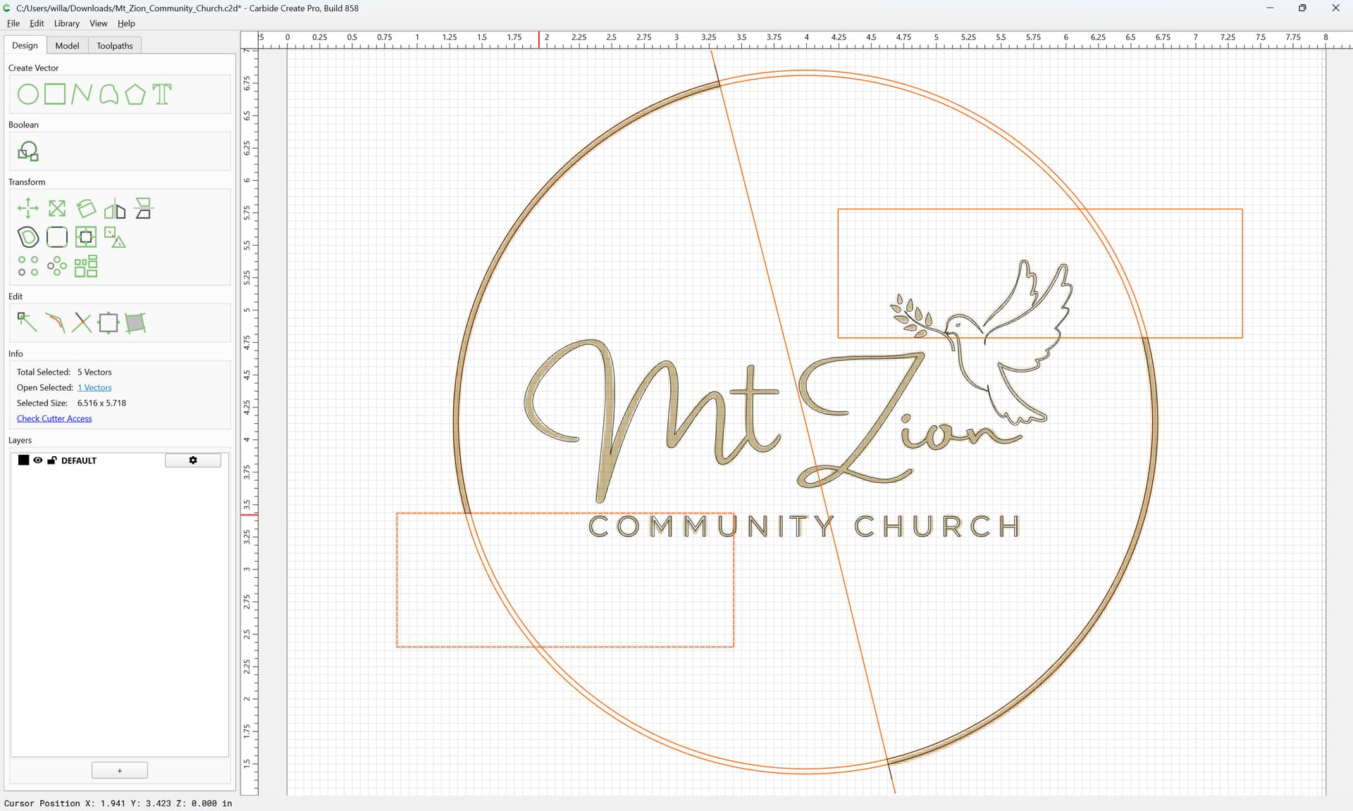

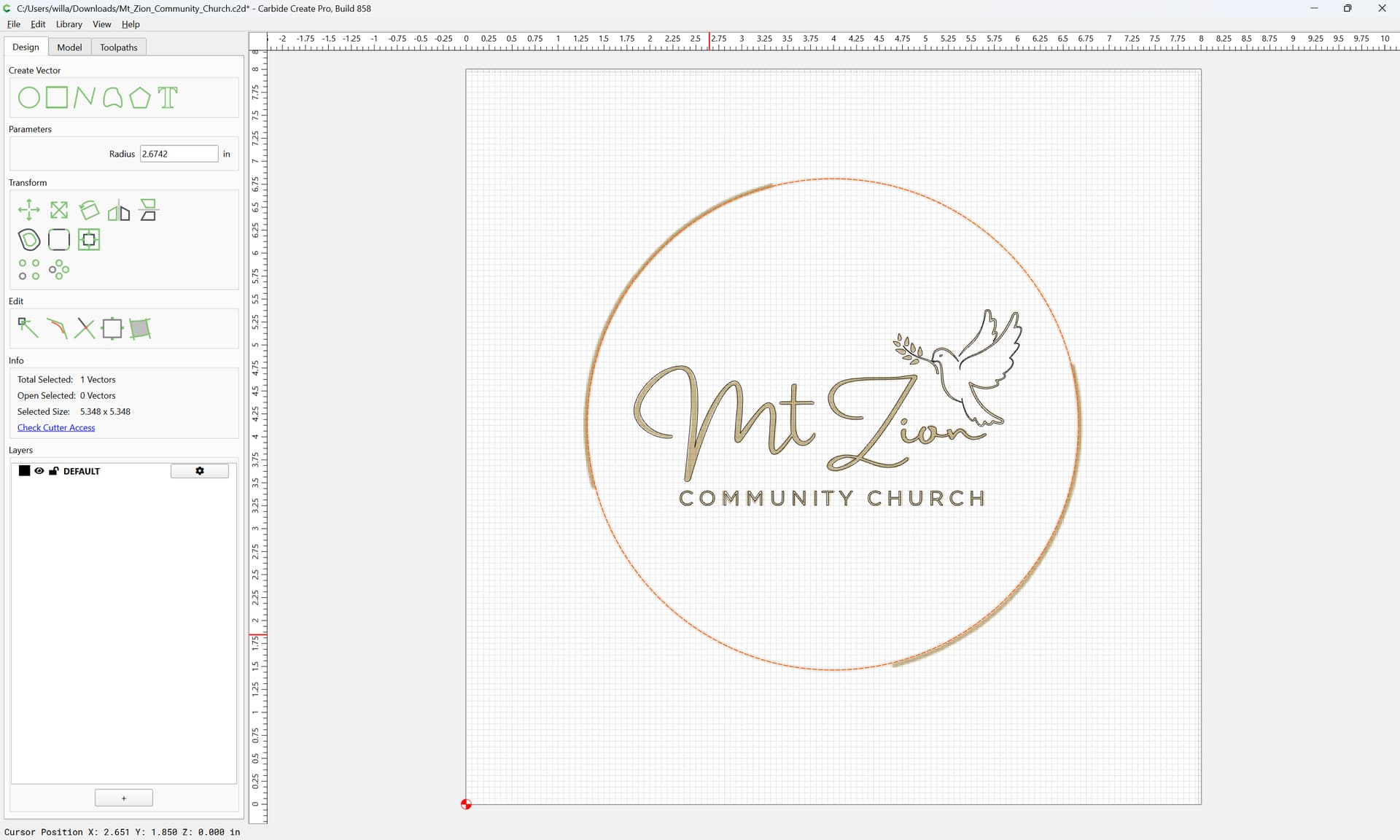

as requested on support…

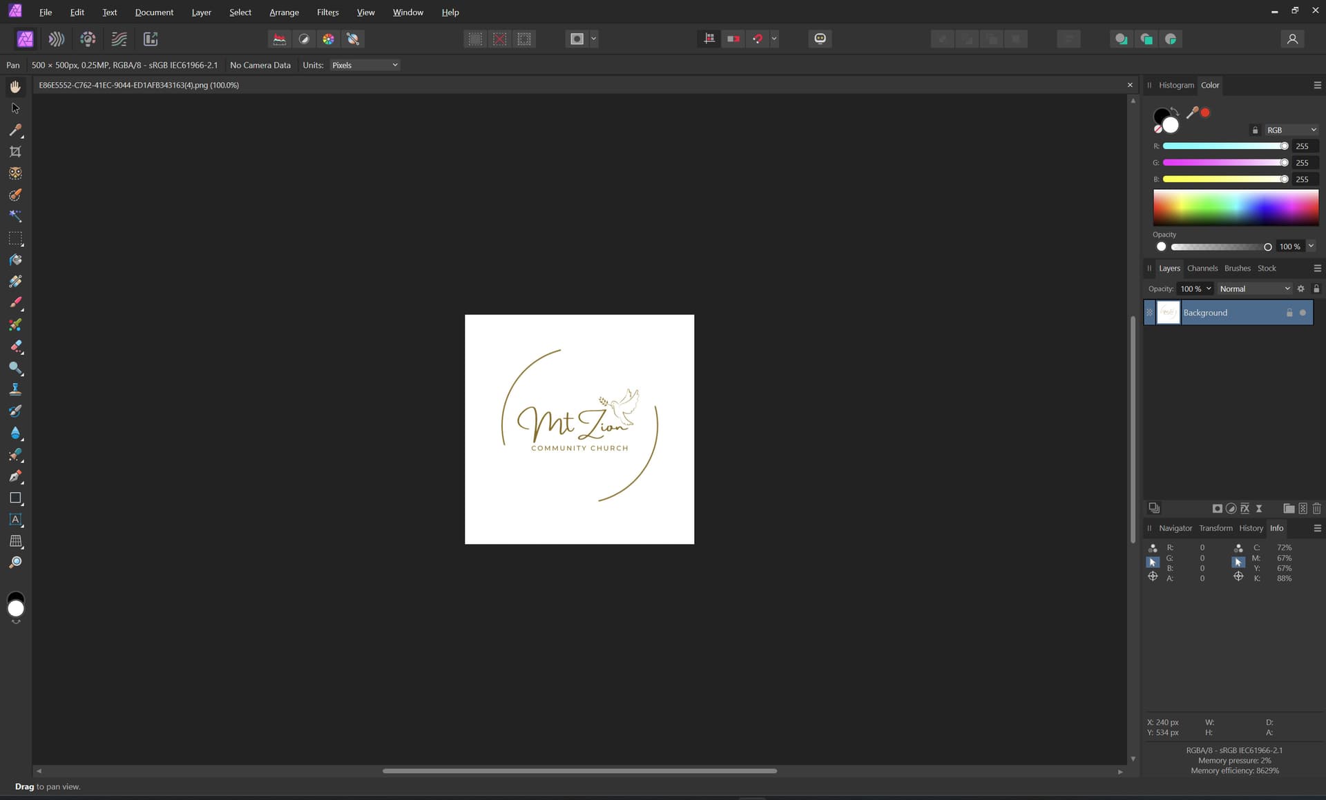

I also attached the download for the email logo file that I got from my church.

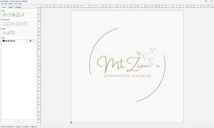

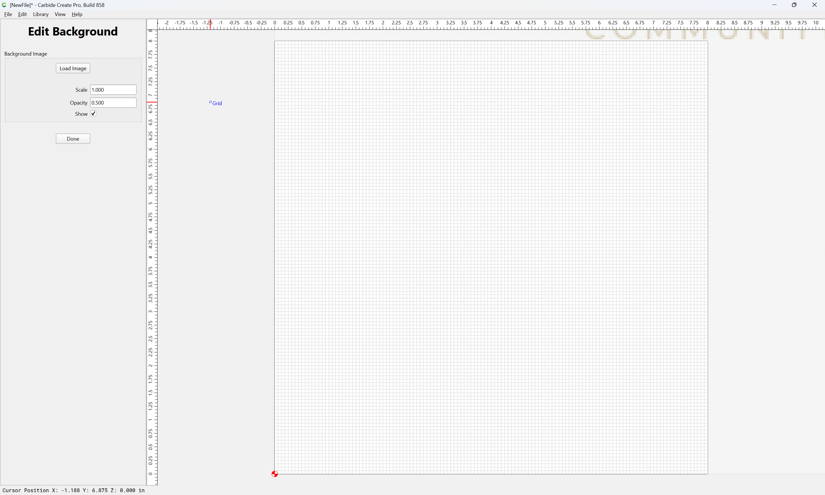

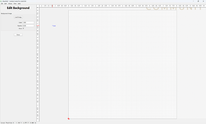

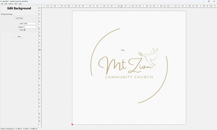

where the image is:

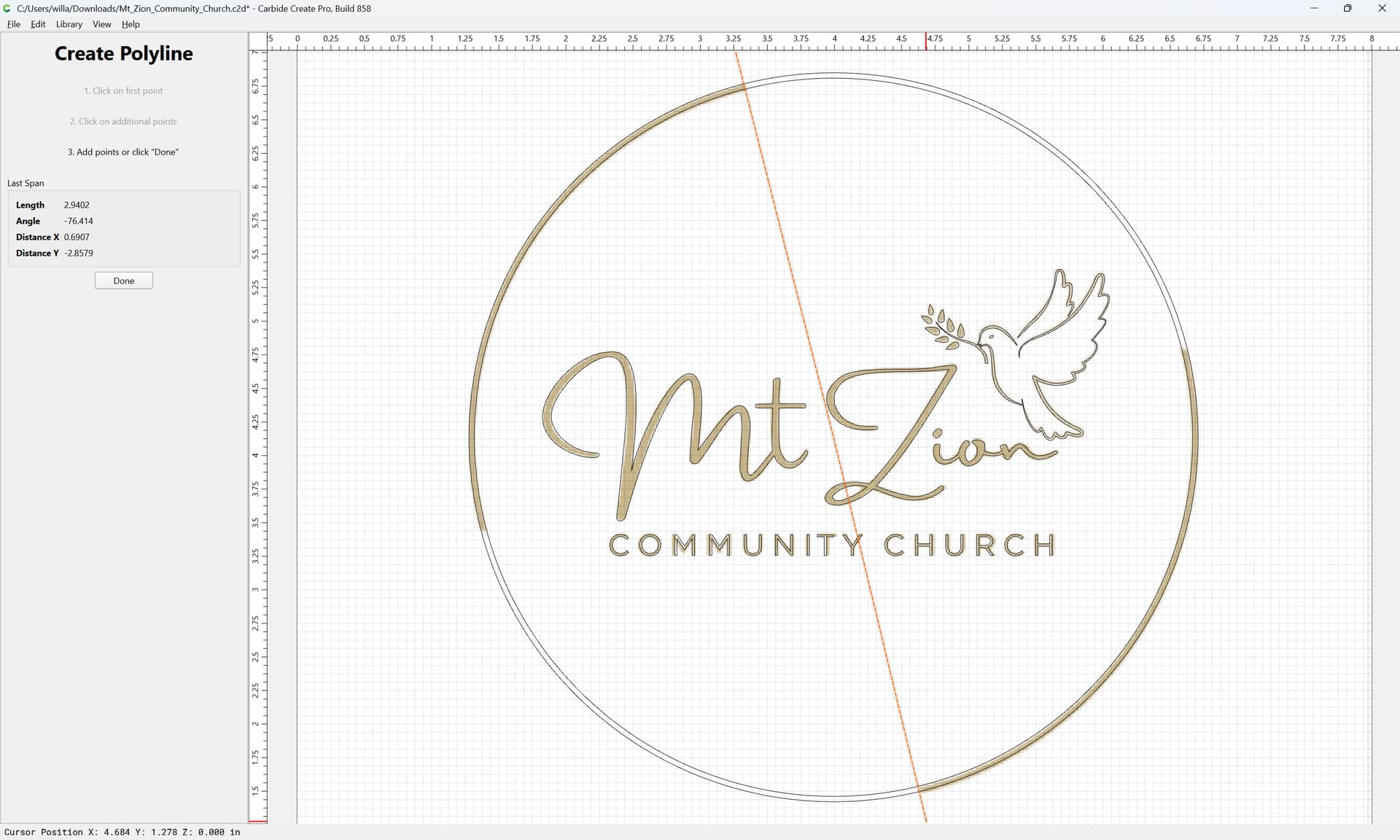

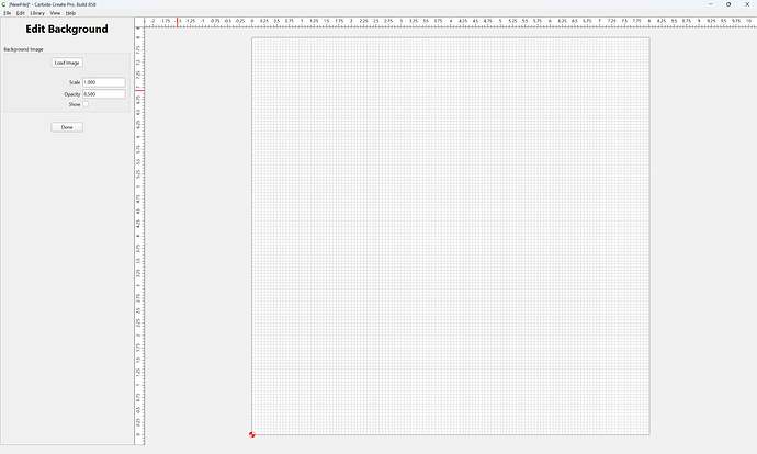

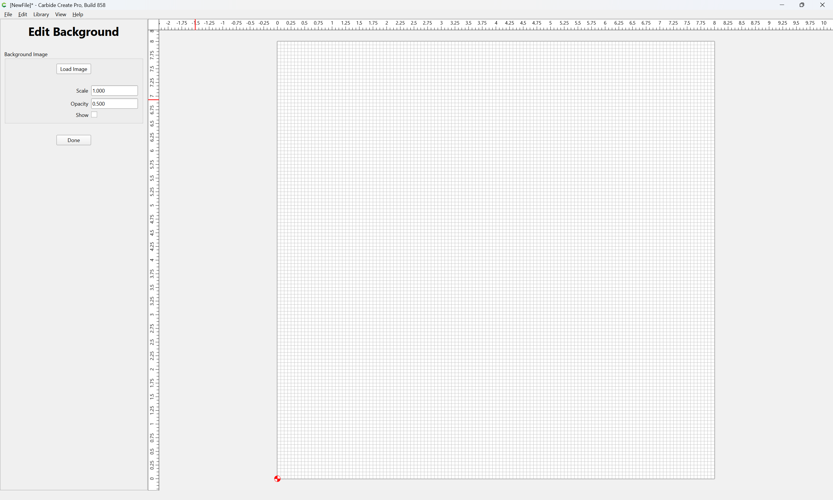

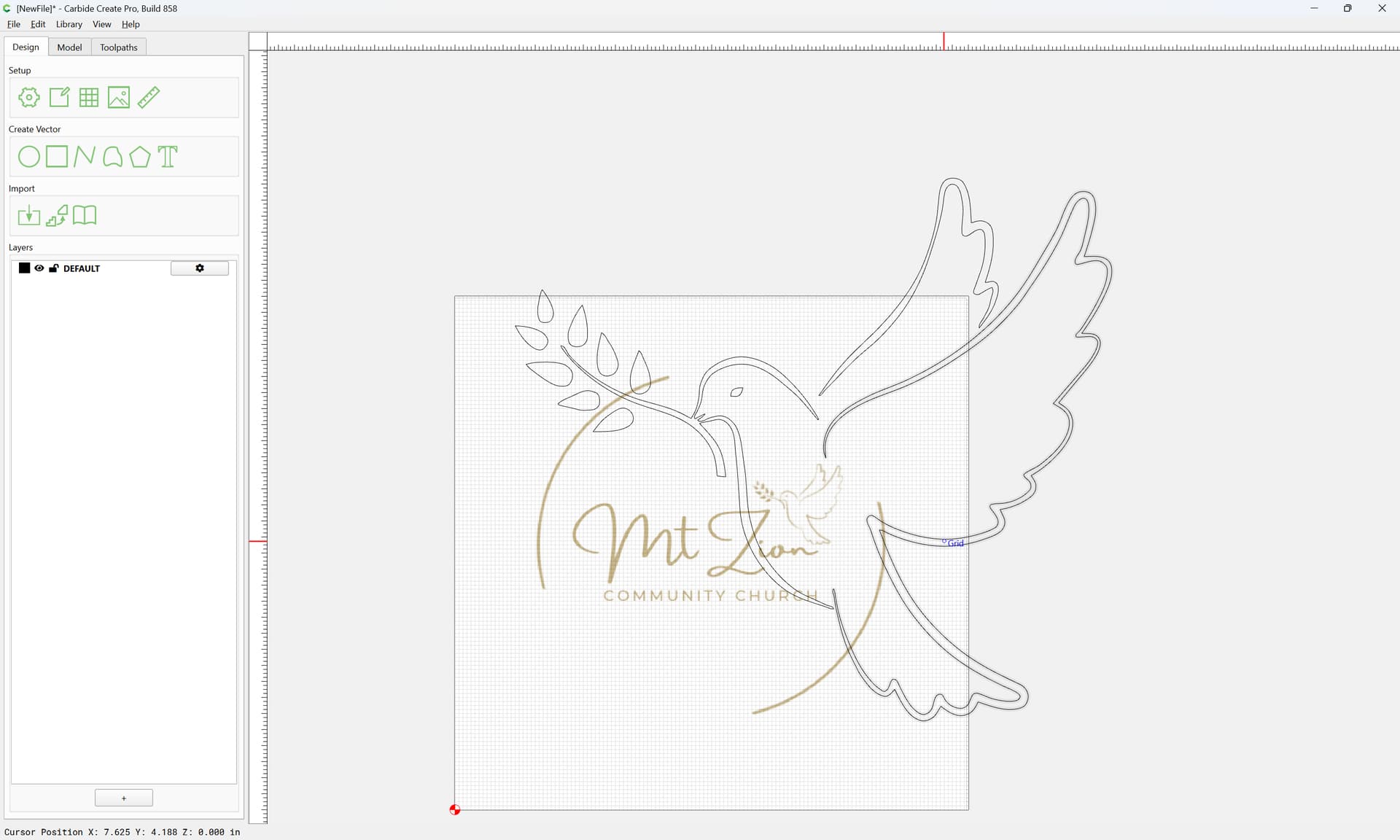

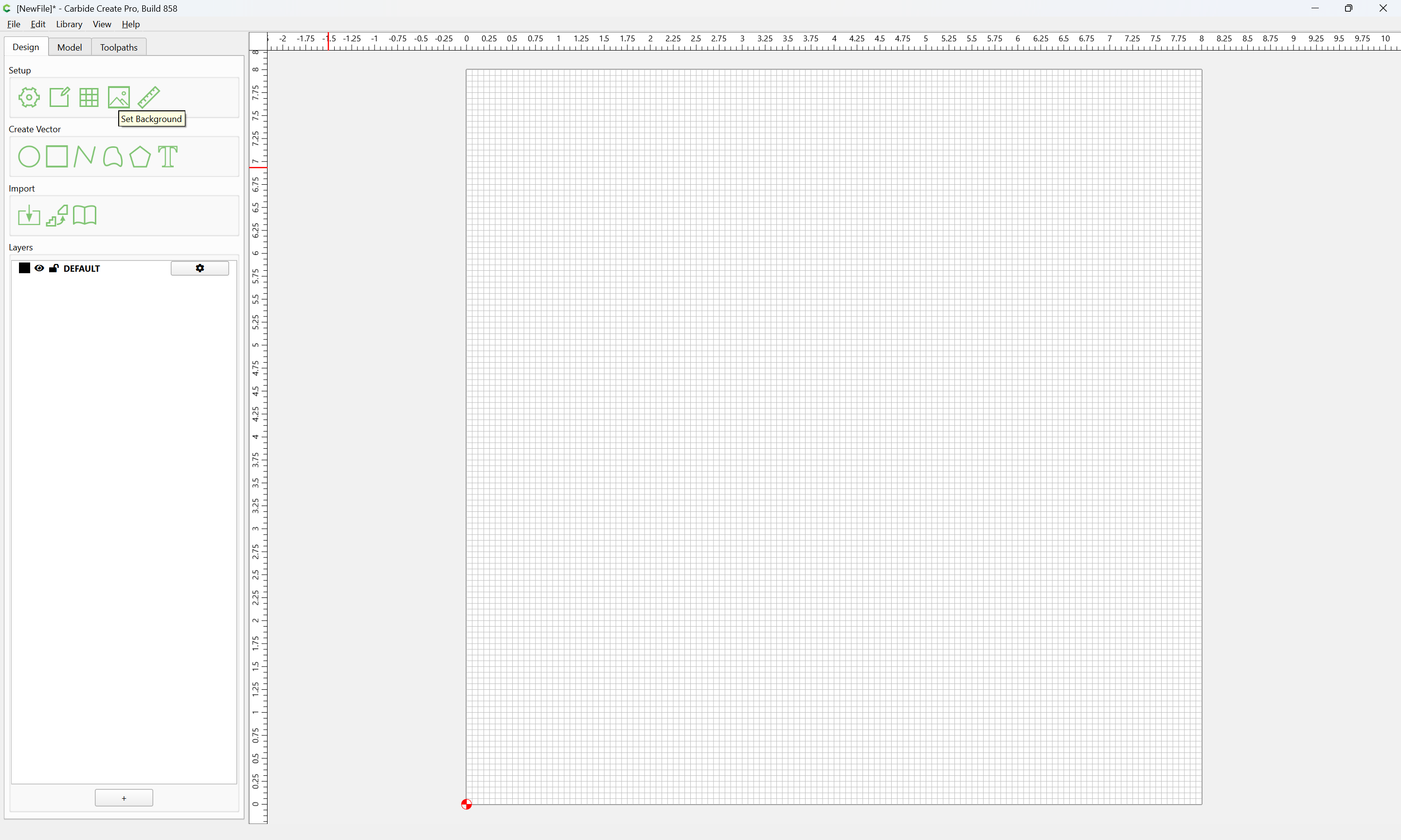

We will re-draw this by importing the pixel image into a Carbide Create file
Set Background
Load Image
adjusting until one arrives at:
where we begin re-drawing…
WillAdams
(William Adams (Carbide 3D))
2

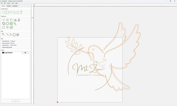

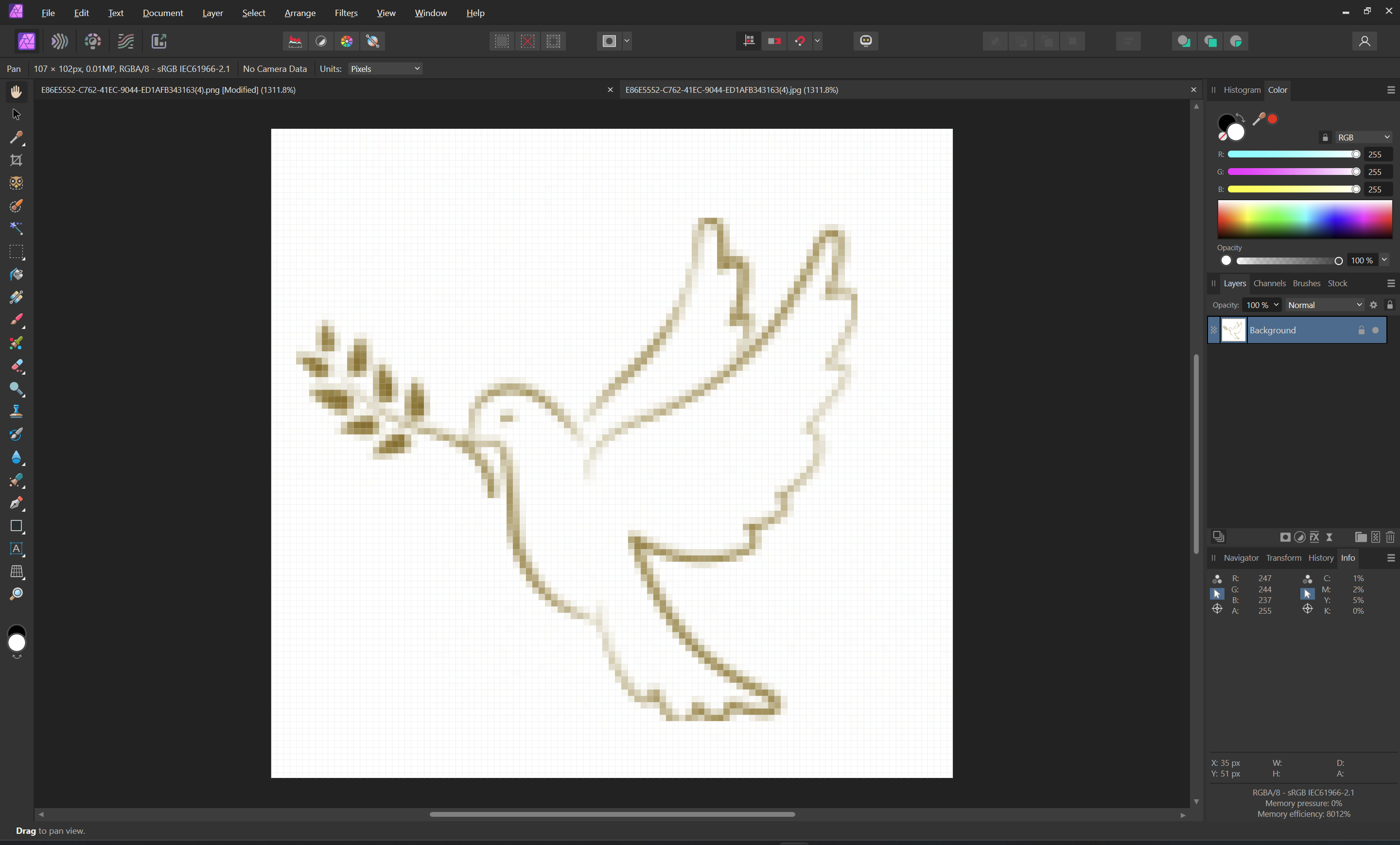

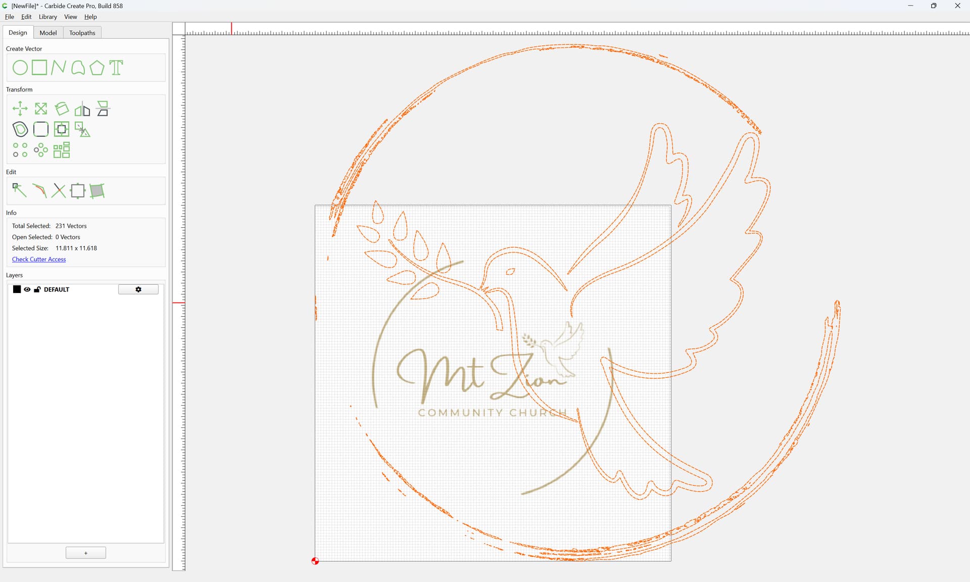

Done

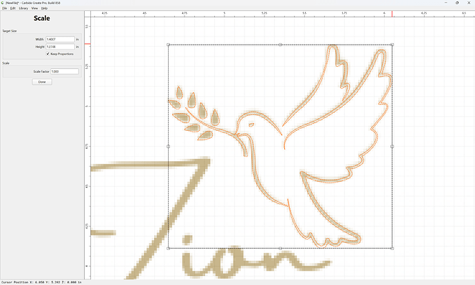

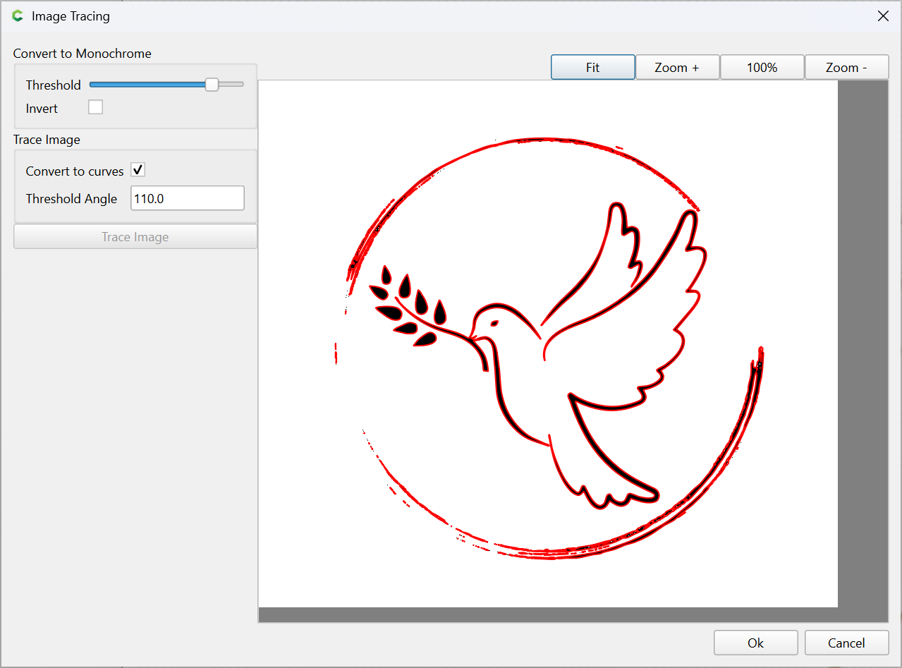

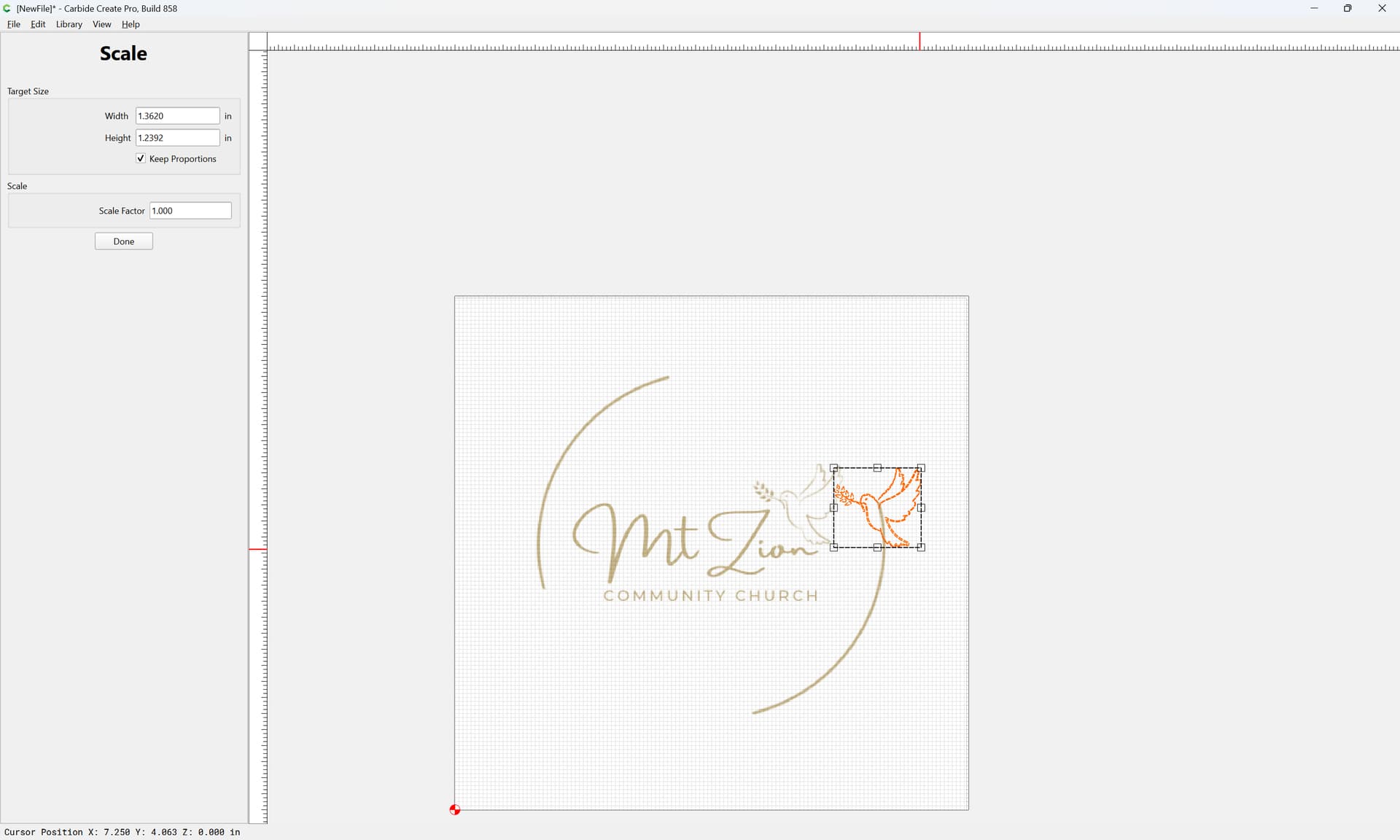

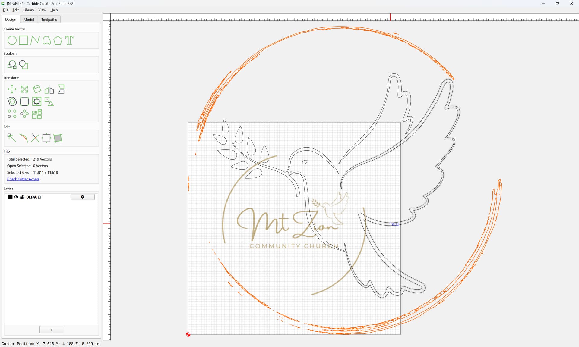

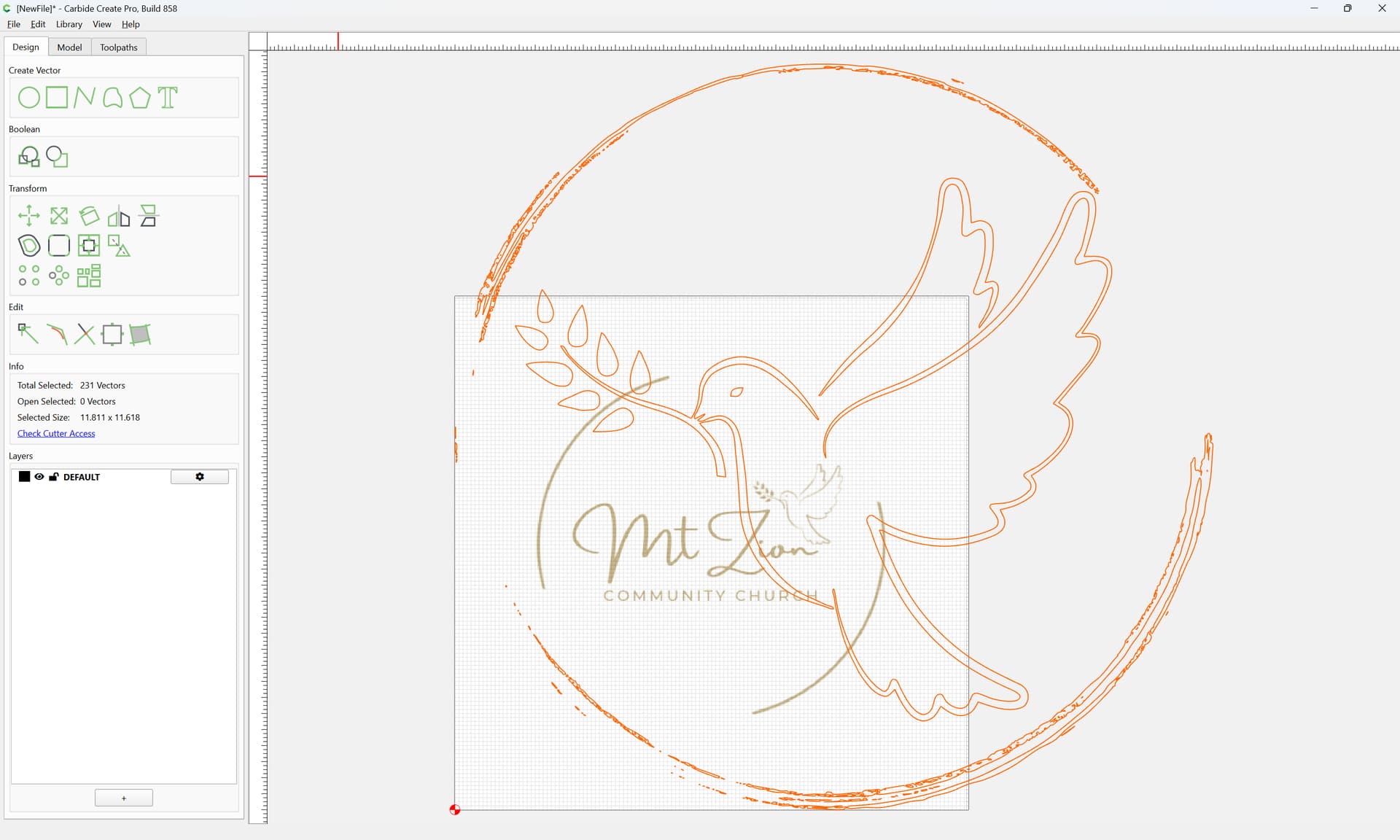

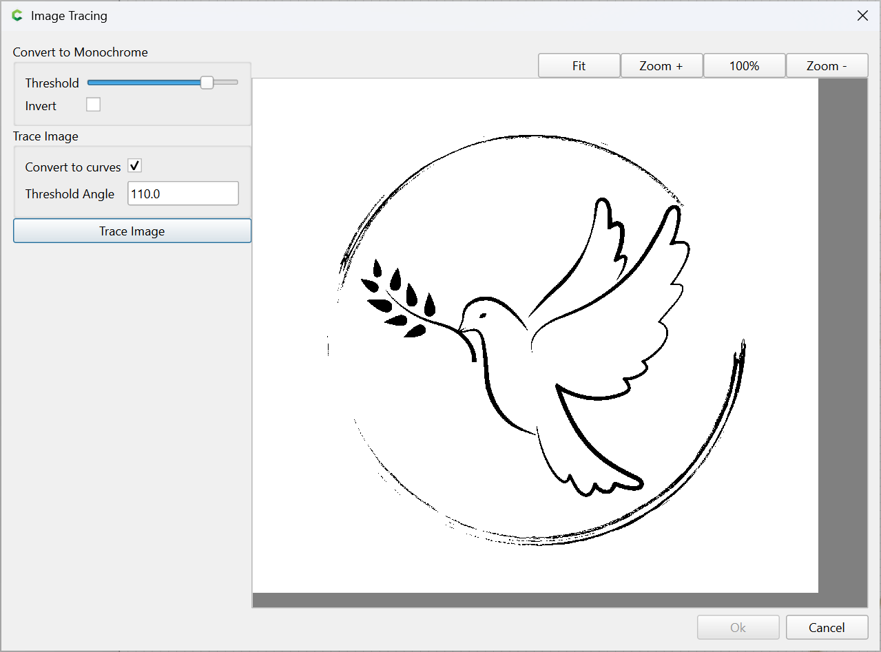

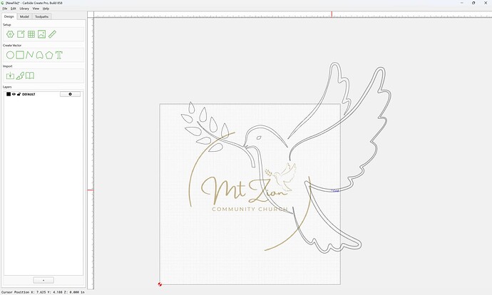

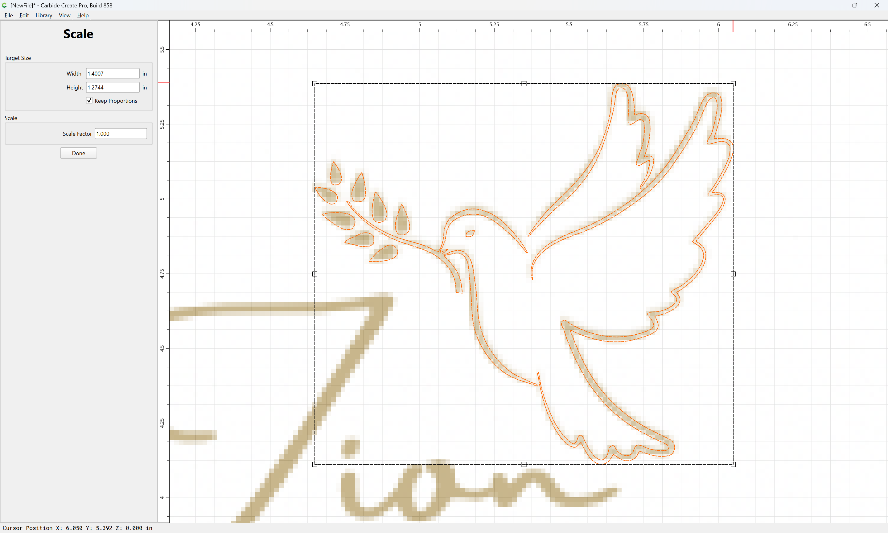

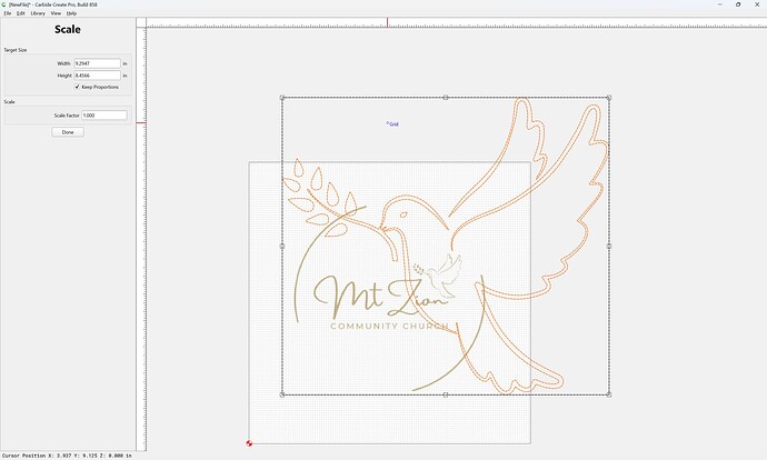

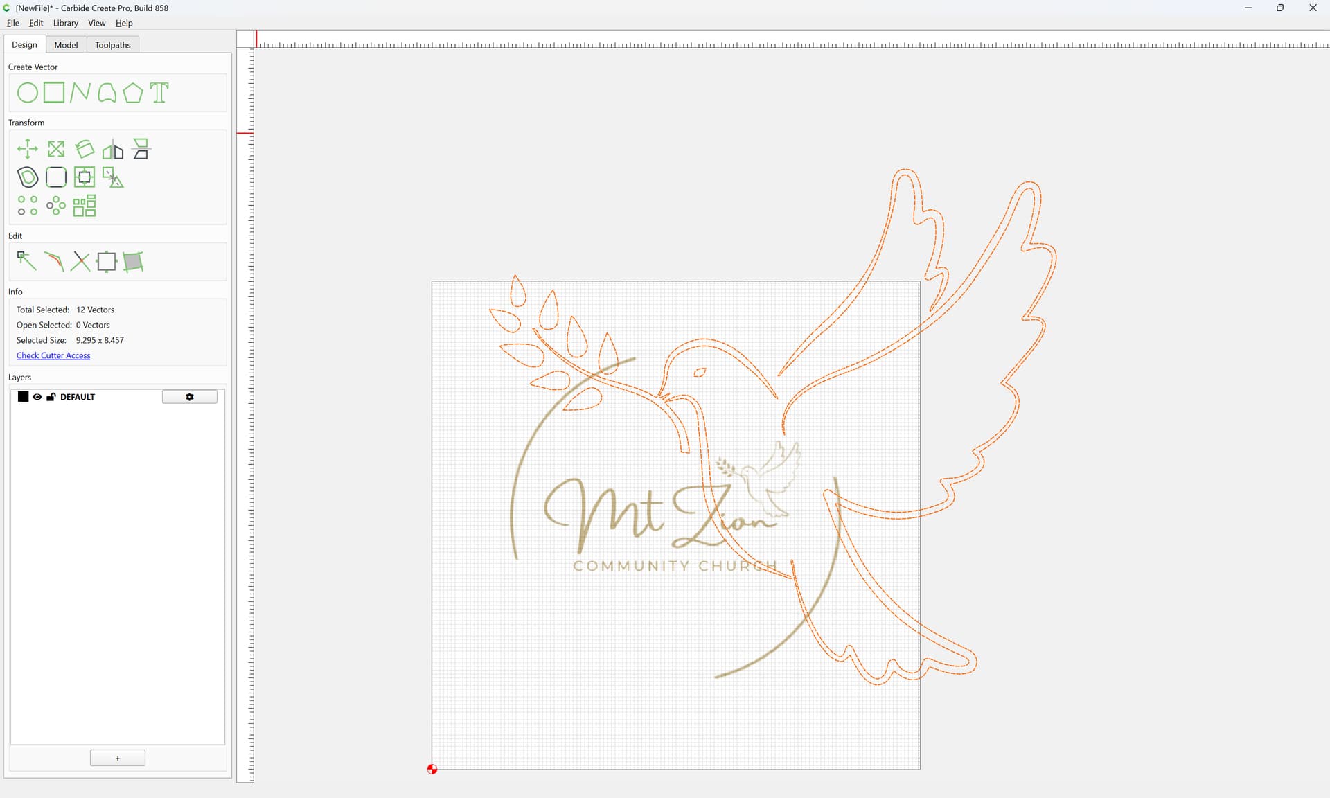

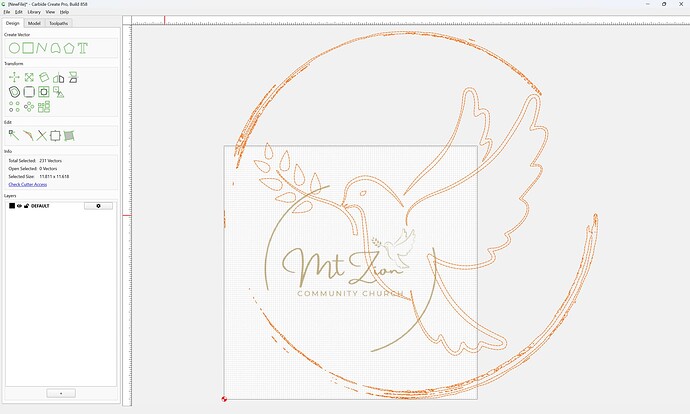

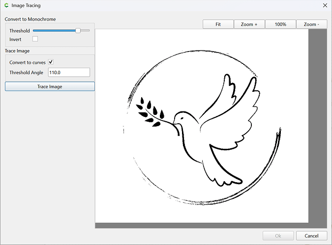

Look for a higher resolution version and import that:

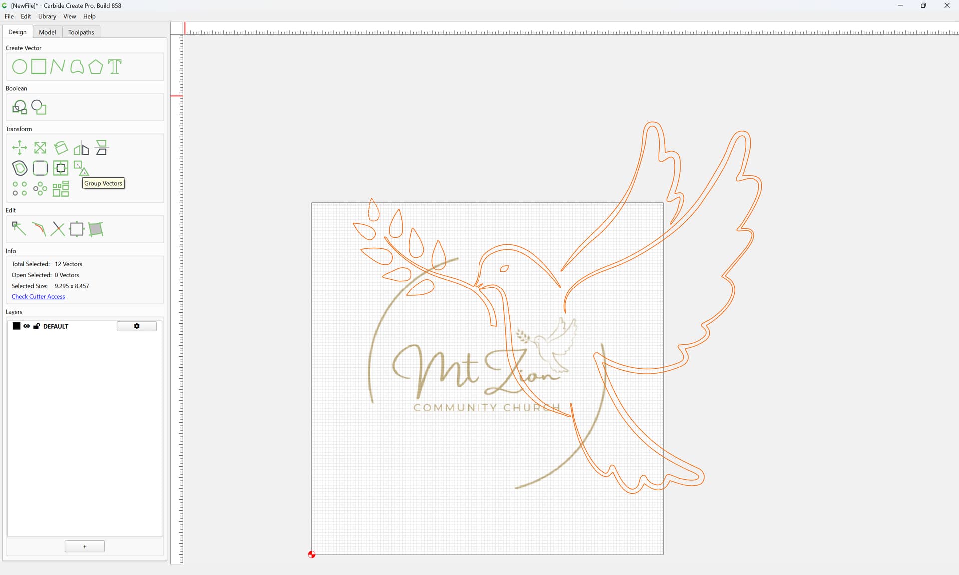

Ungroup Vectors
Deselect what one wants to keep:
and delete it:

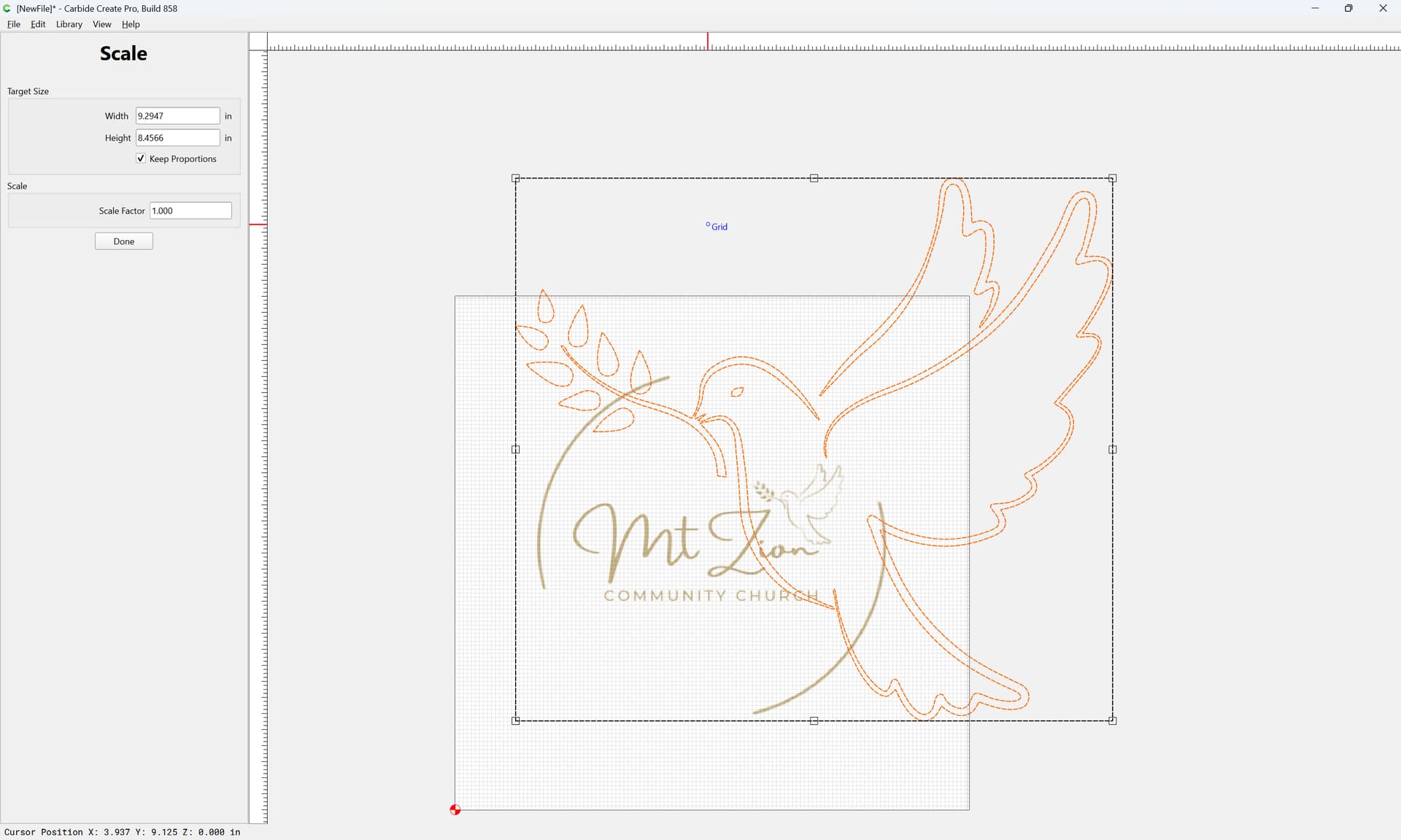

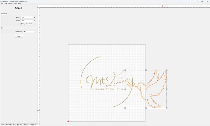

Then select:
Group Vectors;
scale and arrange:
WillAdams
3

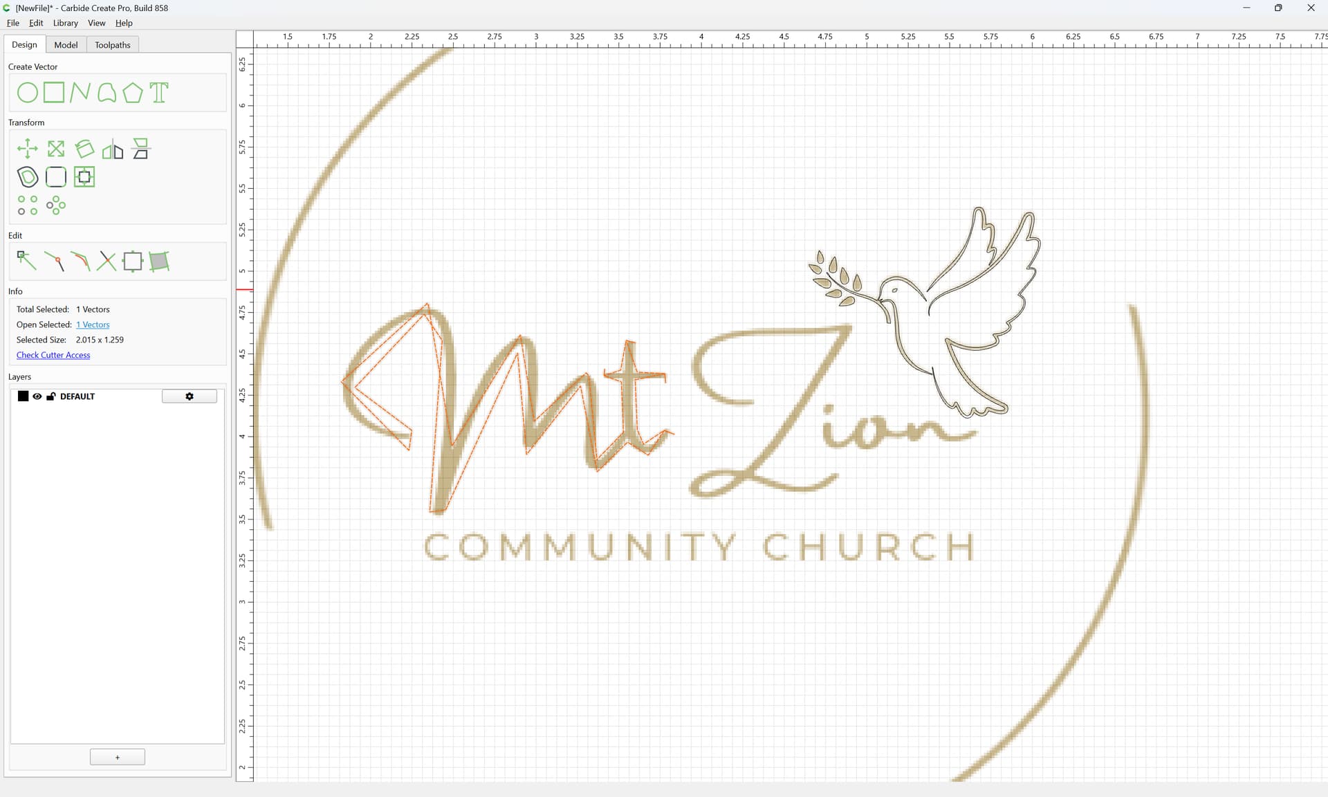

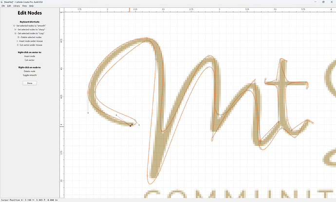

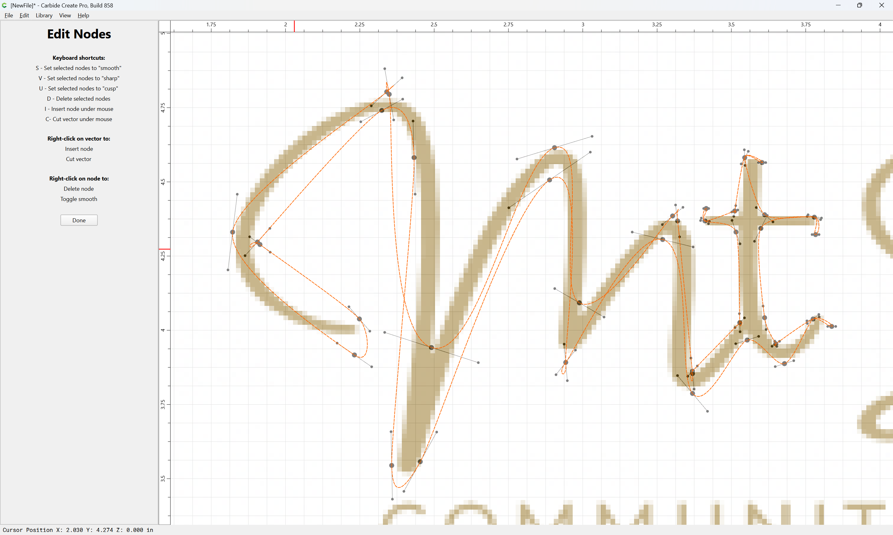

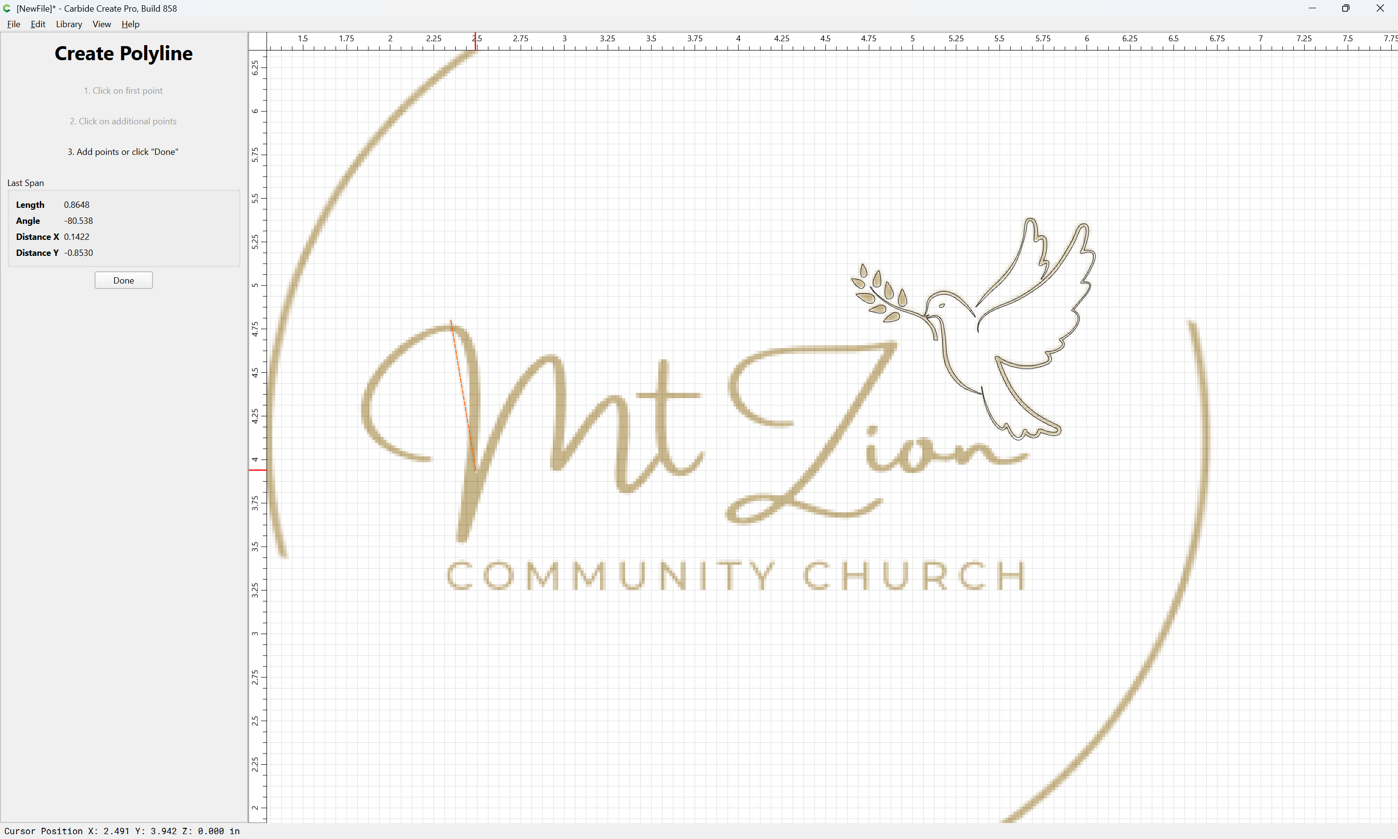

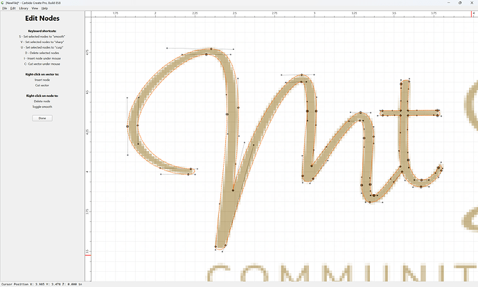

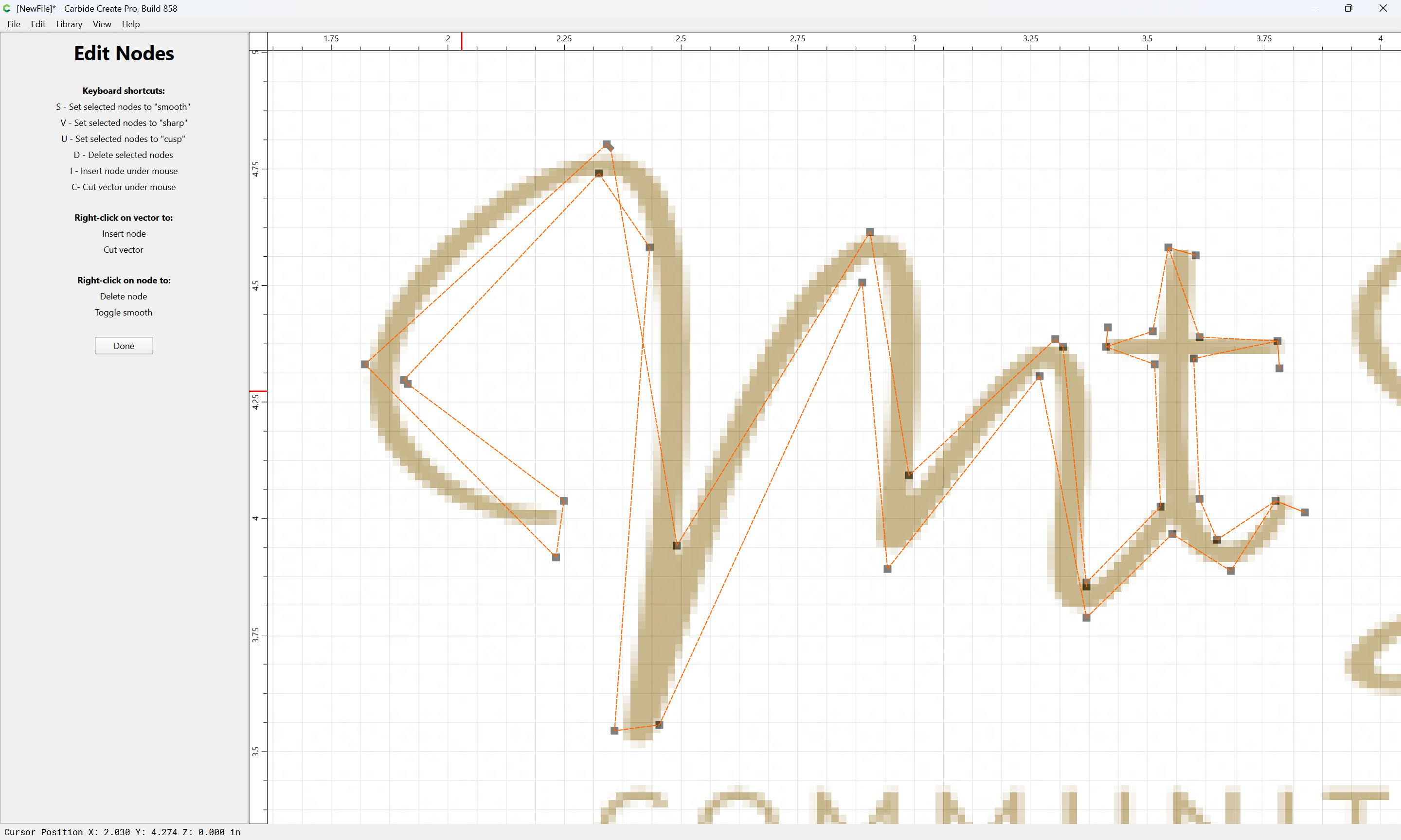

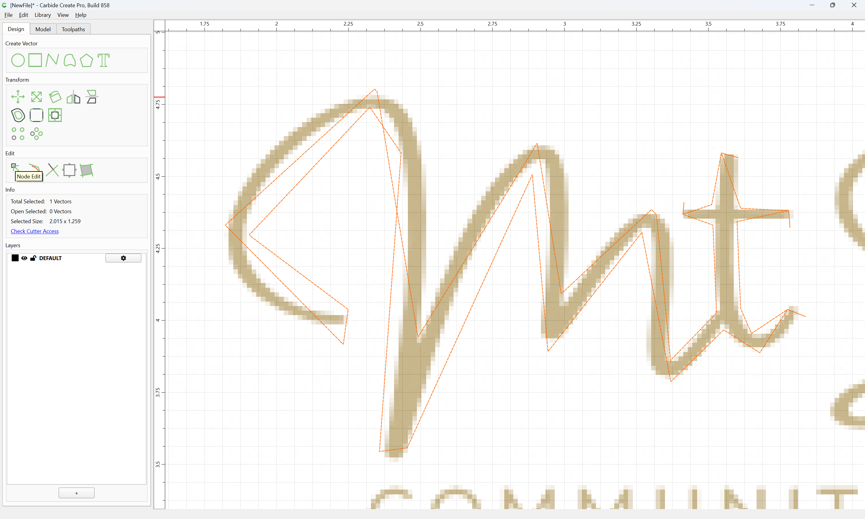

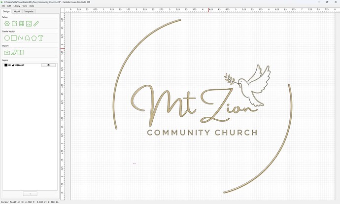

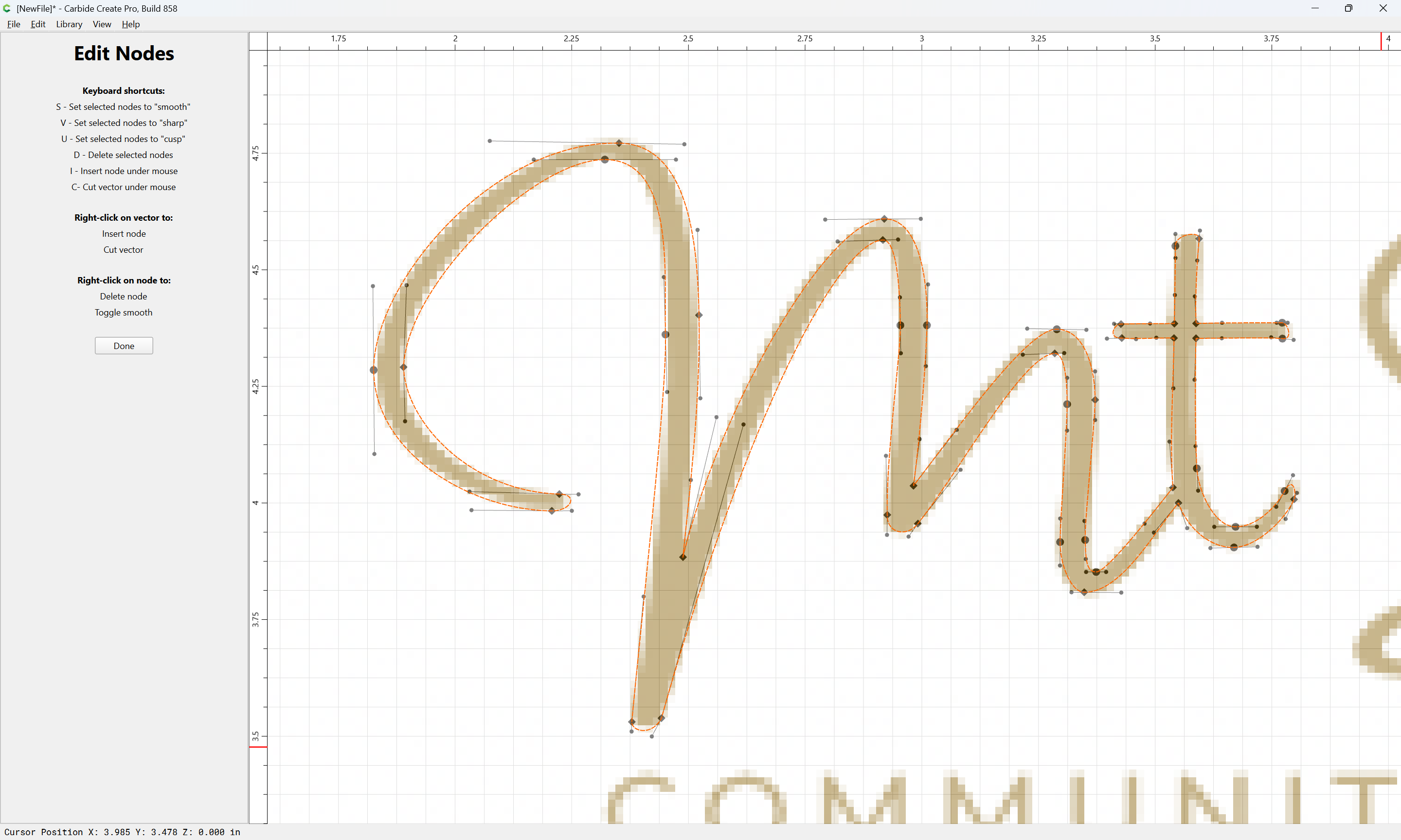

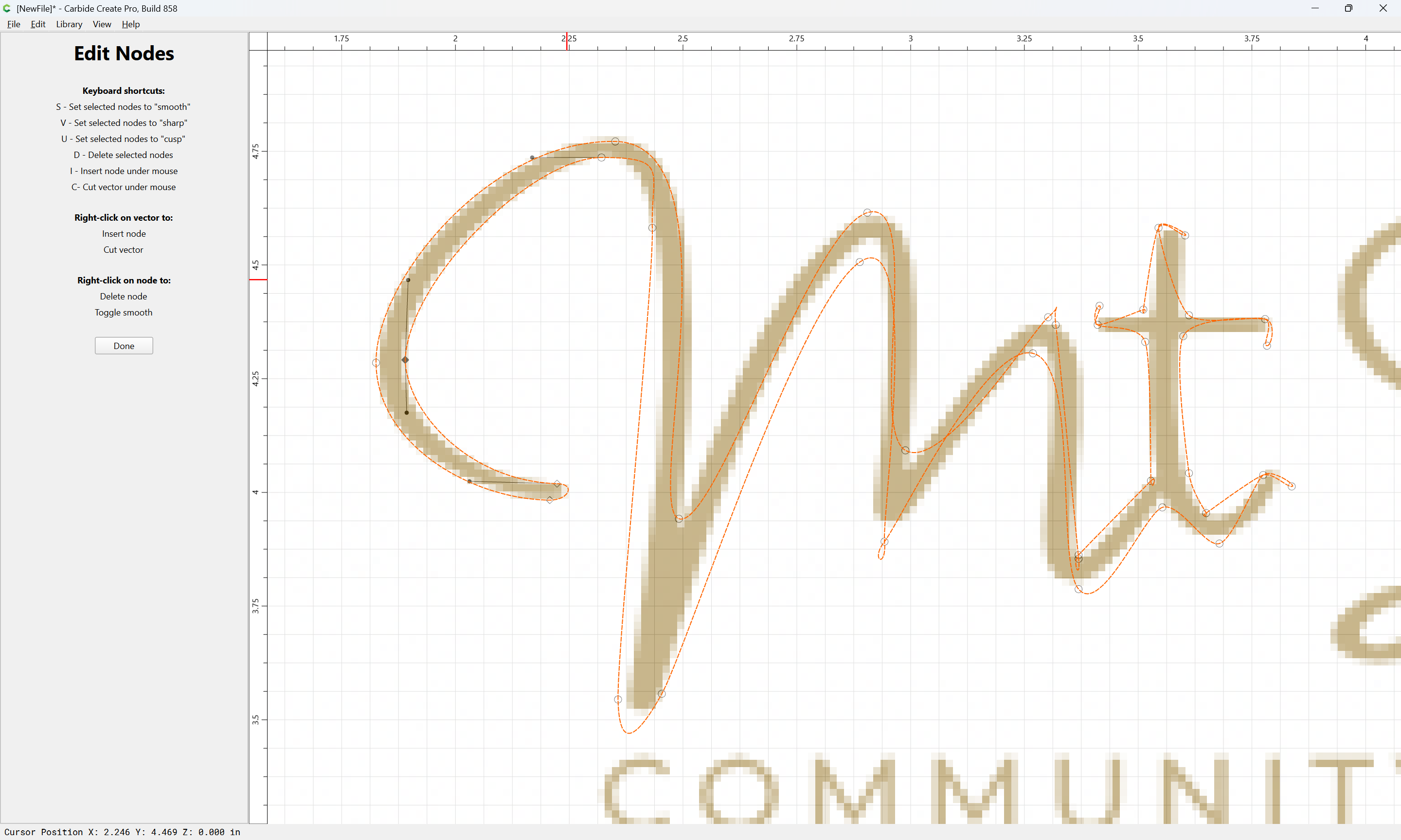

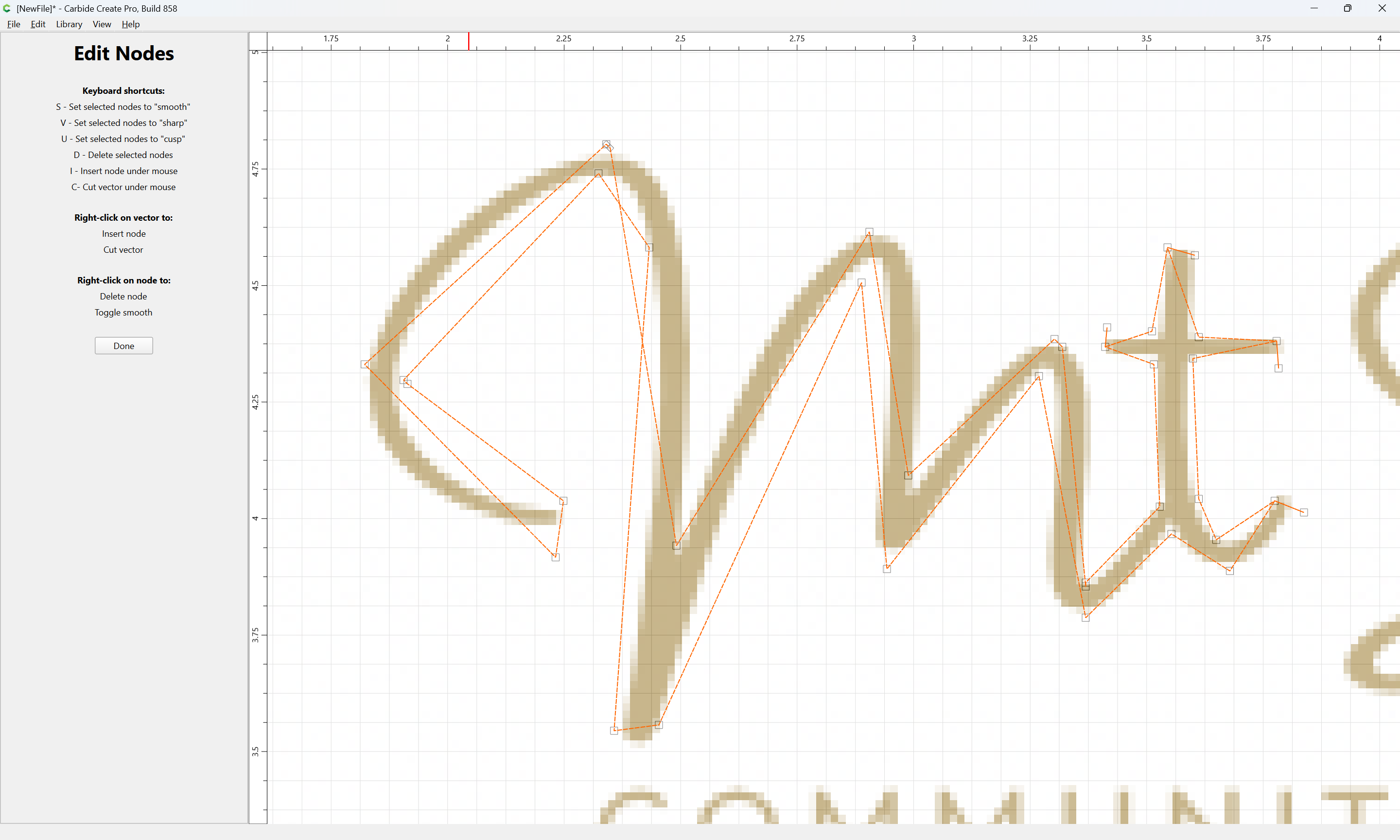

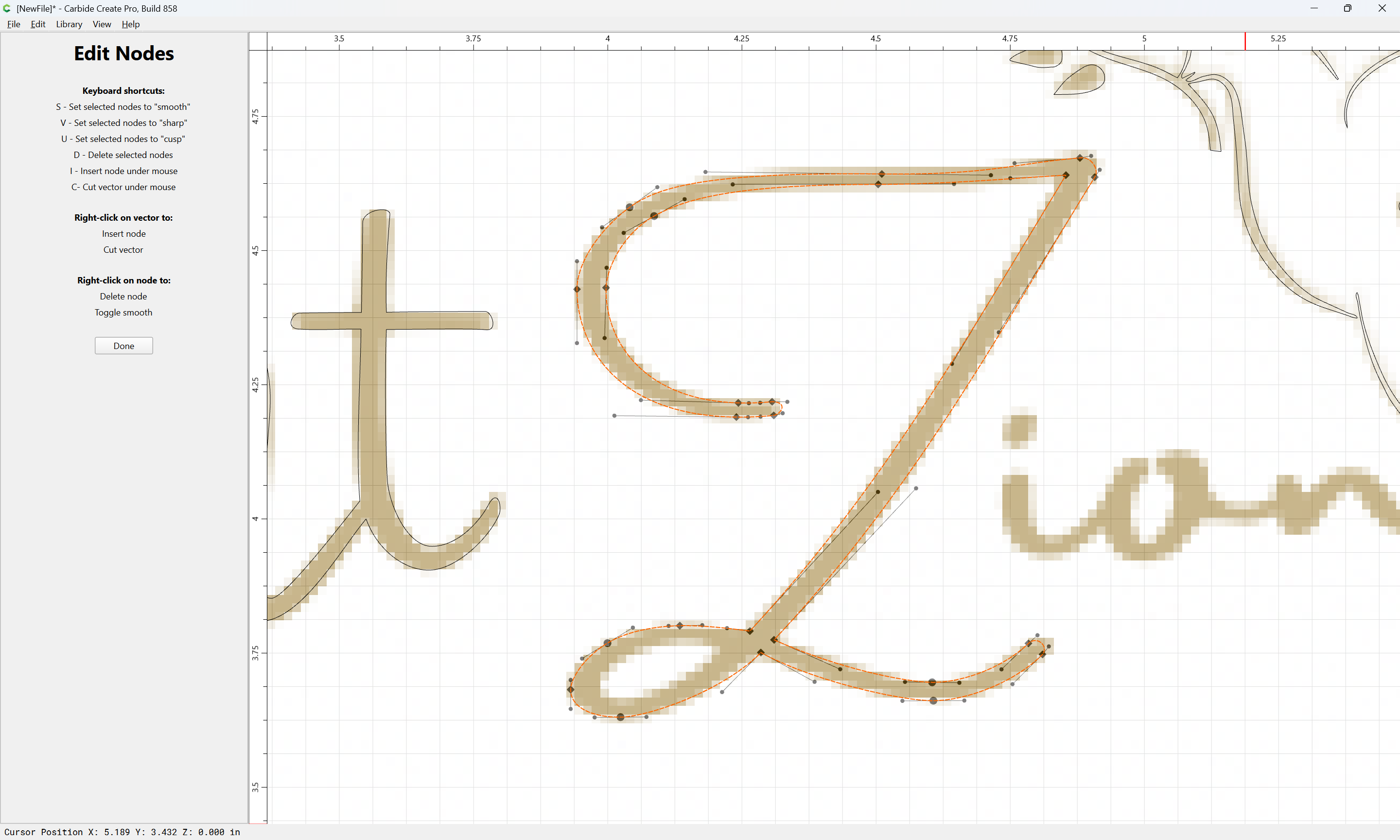

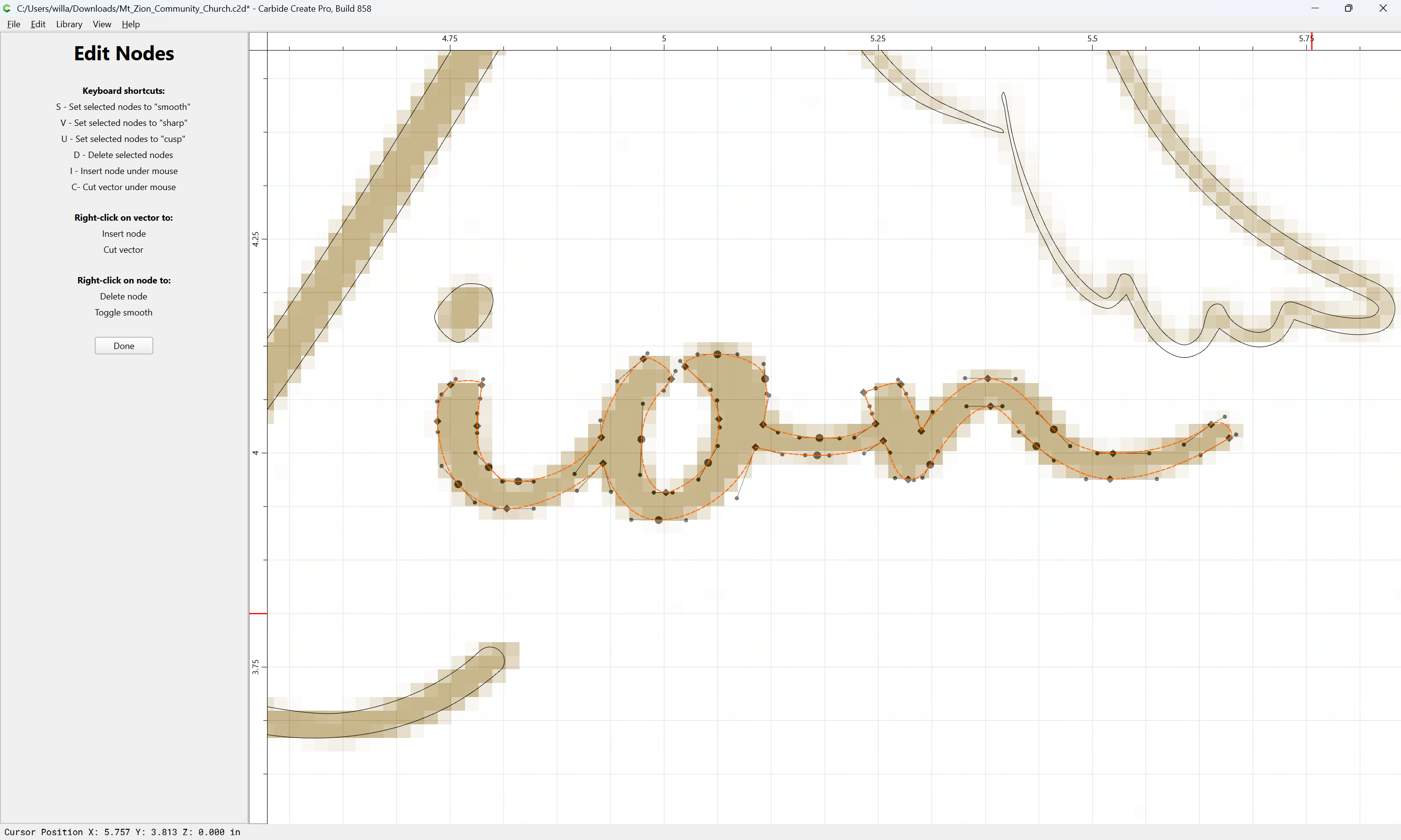

For the text, we simply re-draw, starting with a polyline, placing points where they should be (extrema and points of inflection):
Go into Node Edit mode:
Select everything:
s (to smooth)
then adjust for placement of the various nodes.
If need be, convert to Cusp:
and position accordingly.
Repeat for the balance of the text.
WillAdams
4

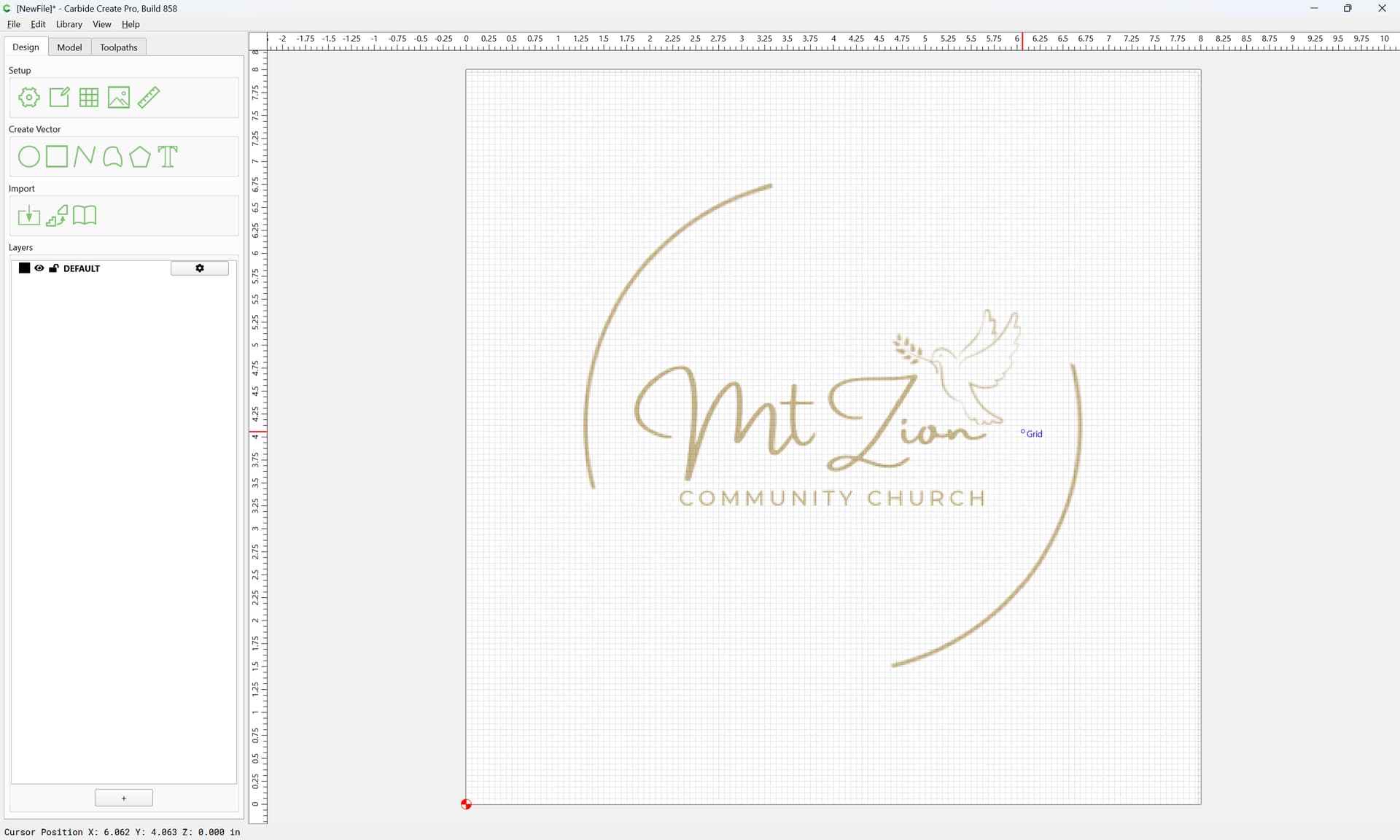

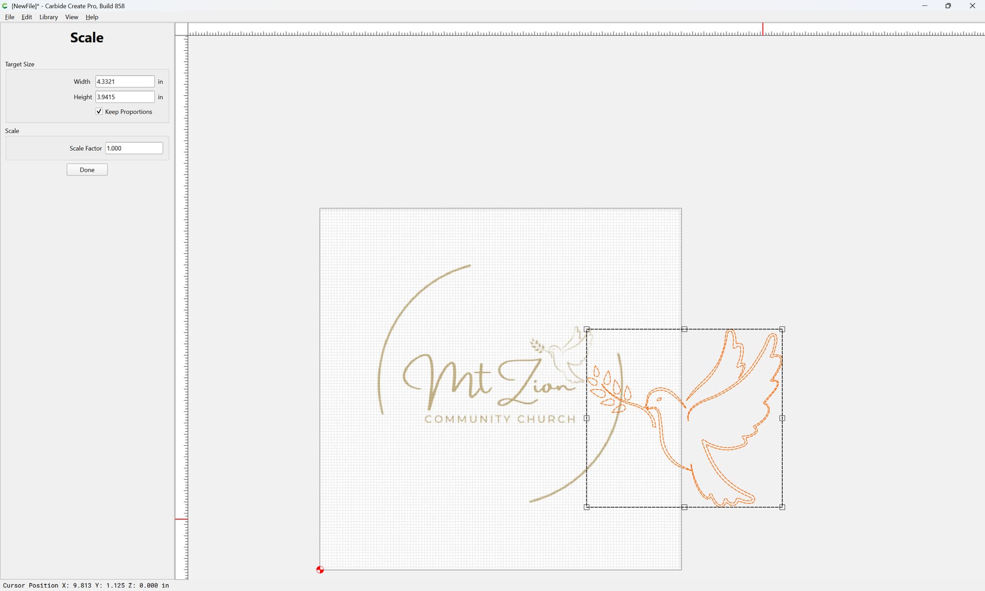

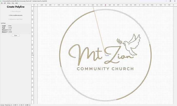

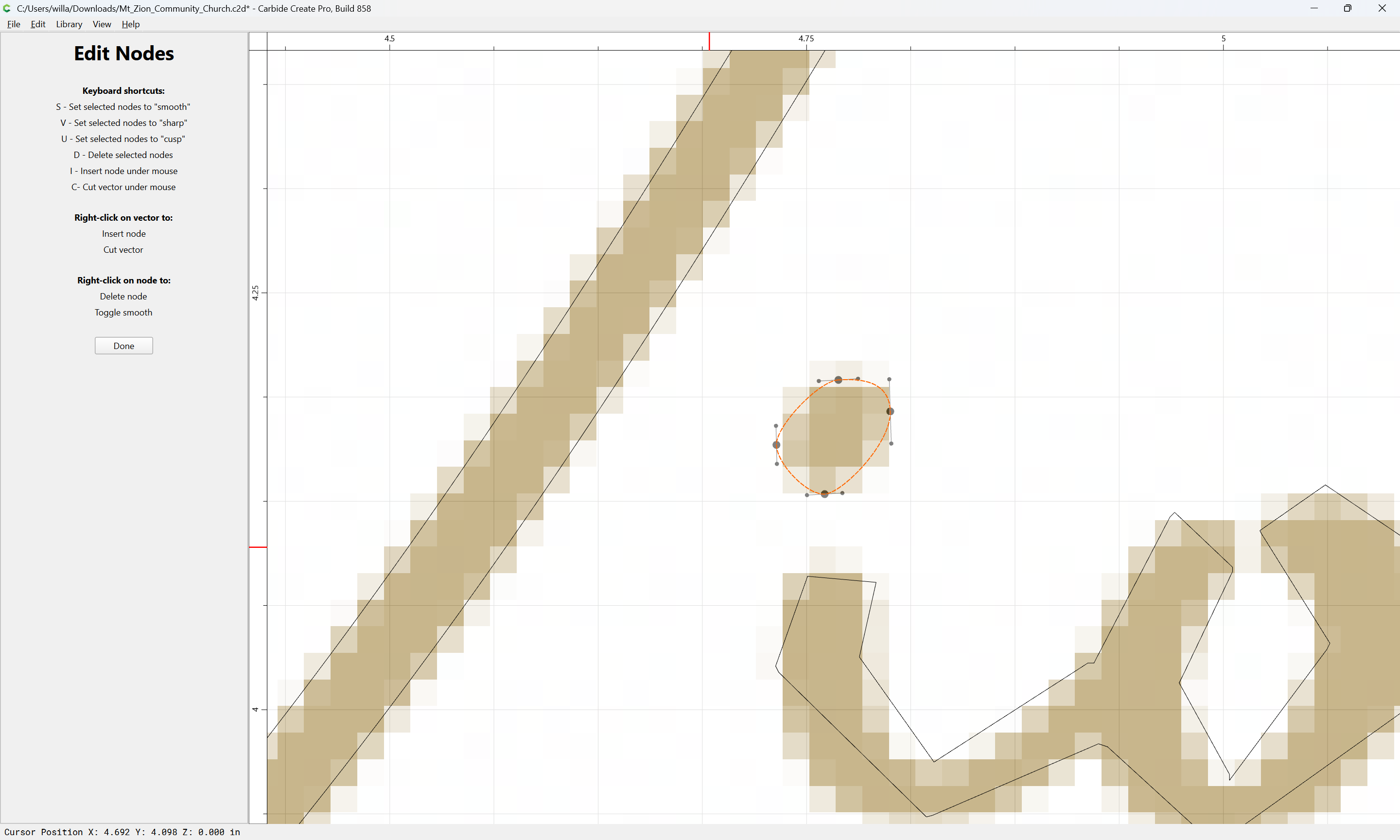

Given the limited number of pixels, some assumptions must be made:
Eventually, one makes enough guesses to arrive at:
WillAdams
5

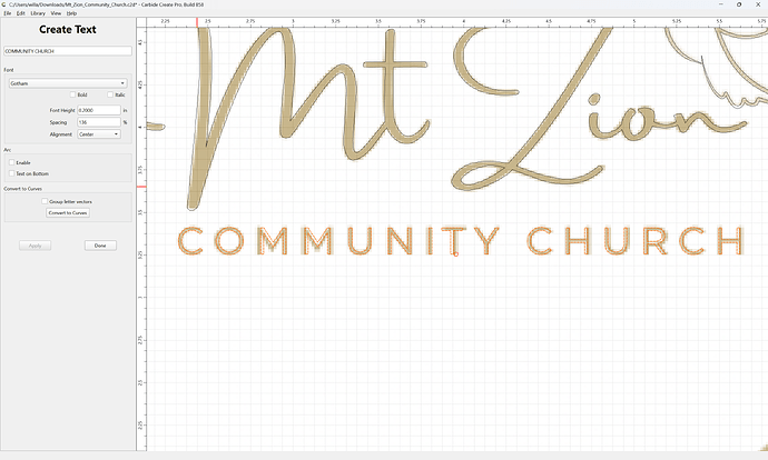

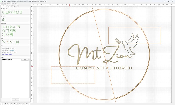

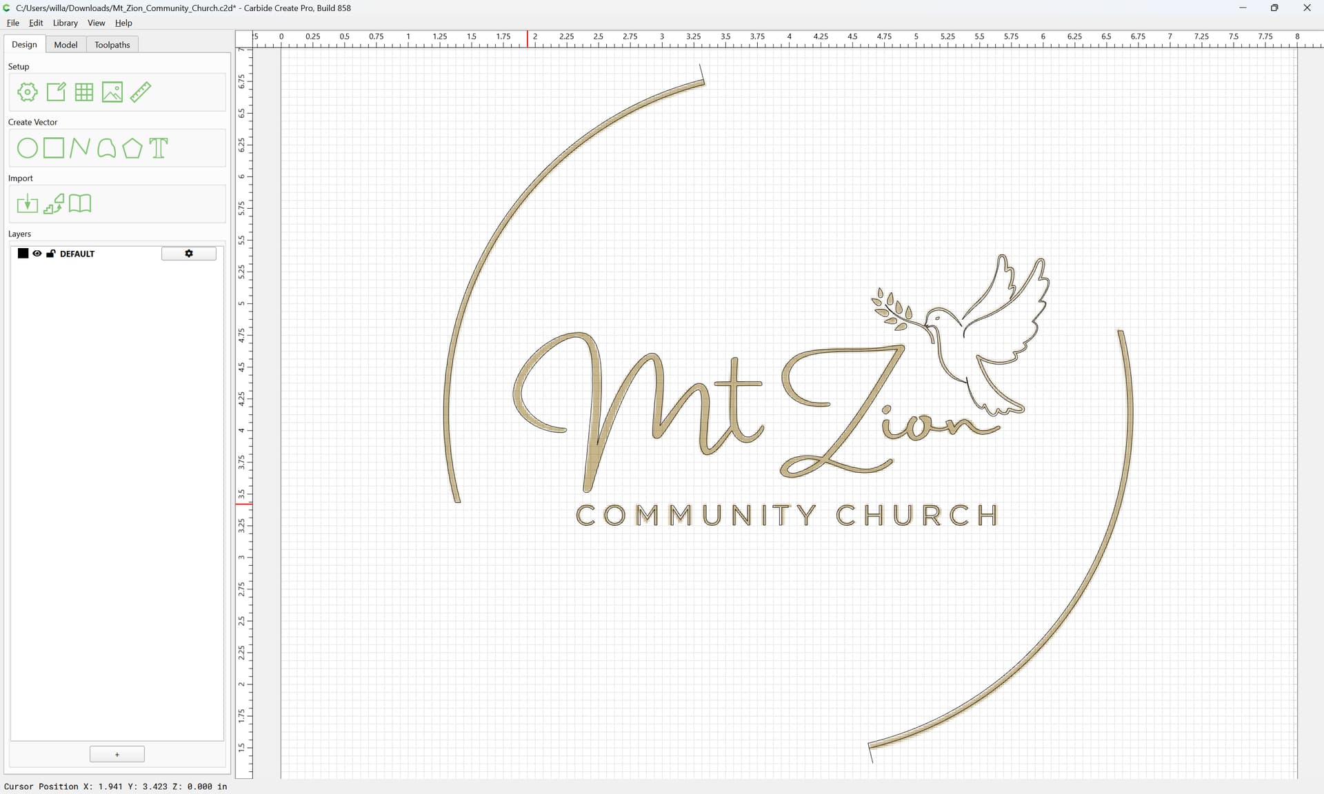

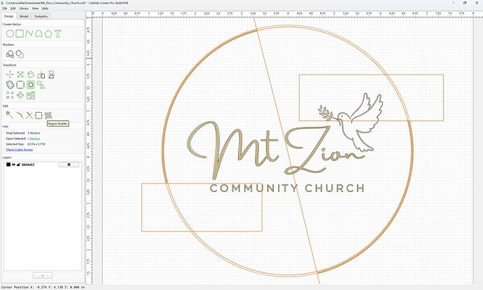

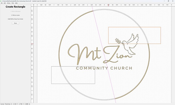

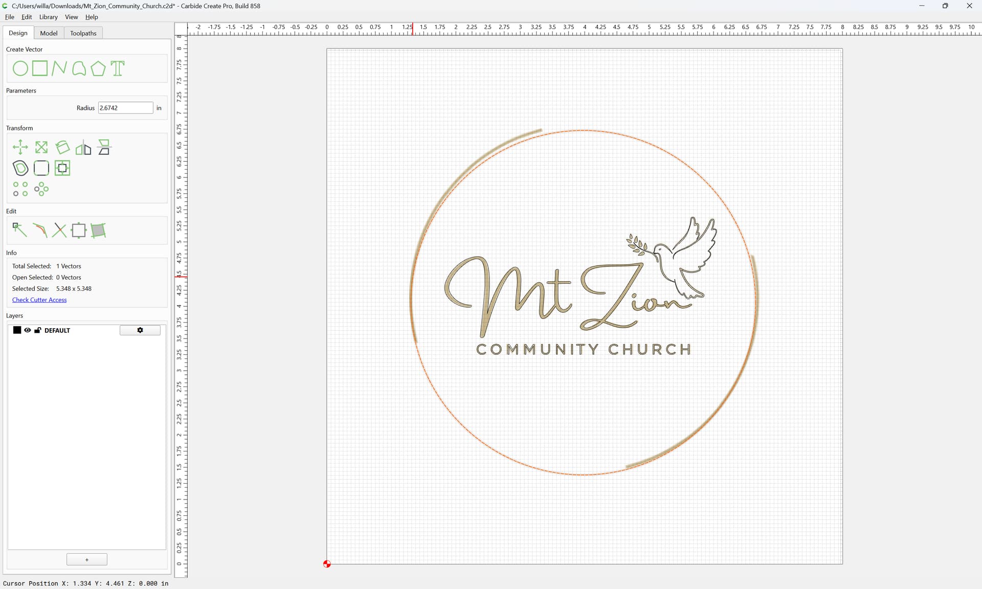

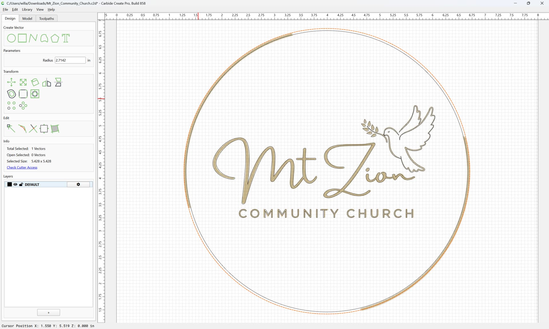

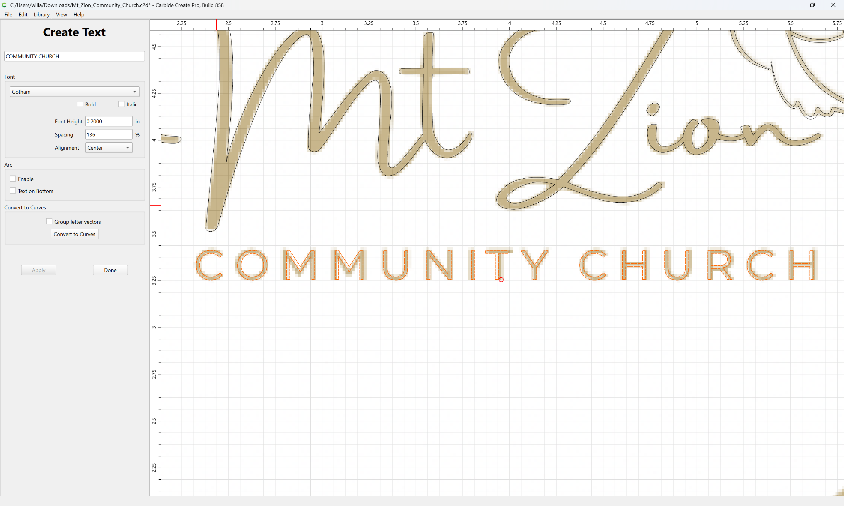

Where possible, re-set the text in the correct font:

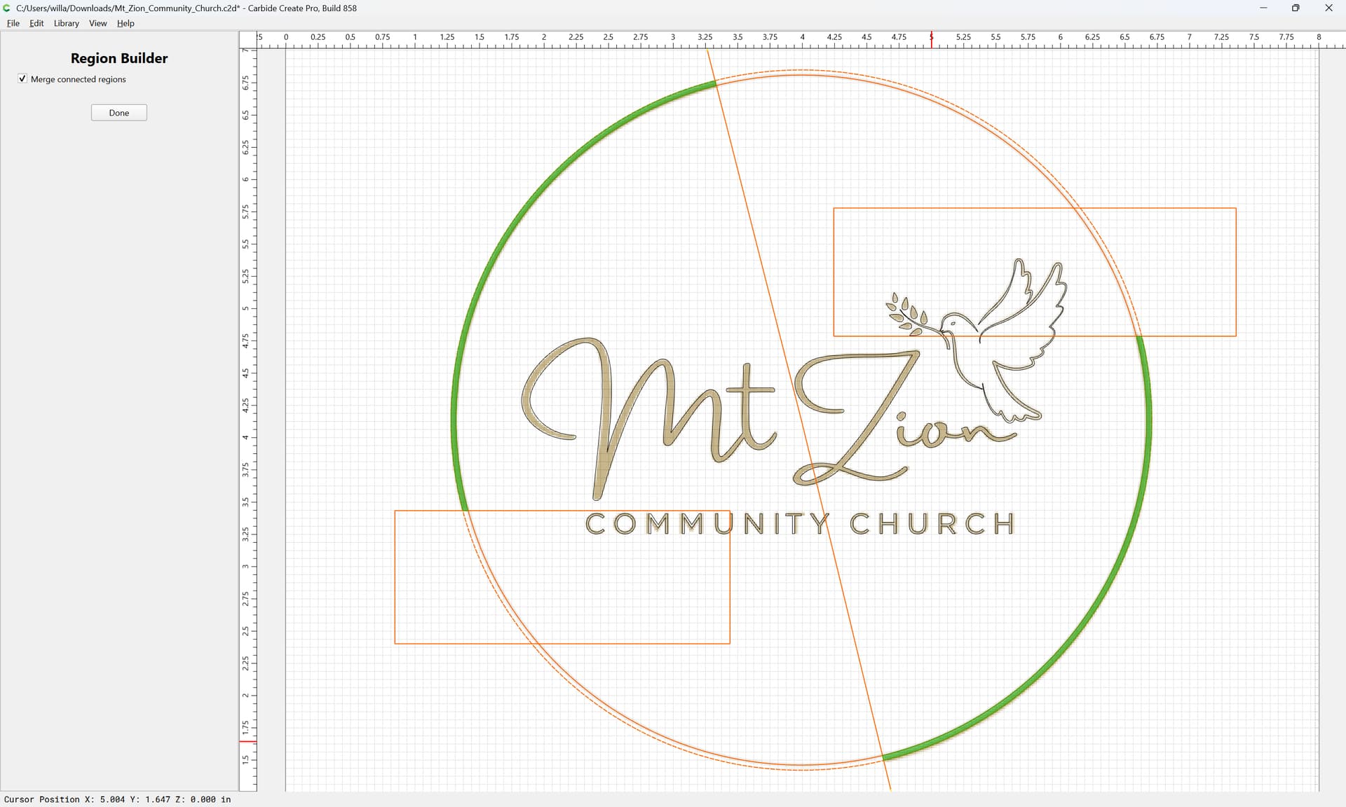

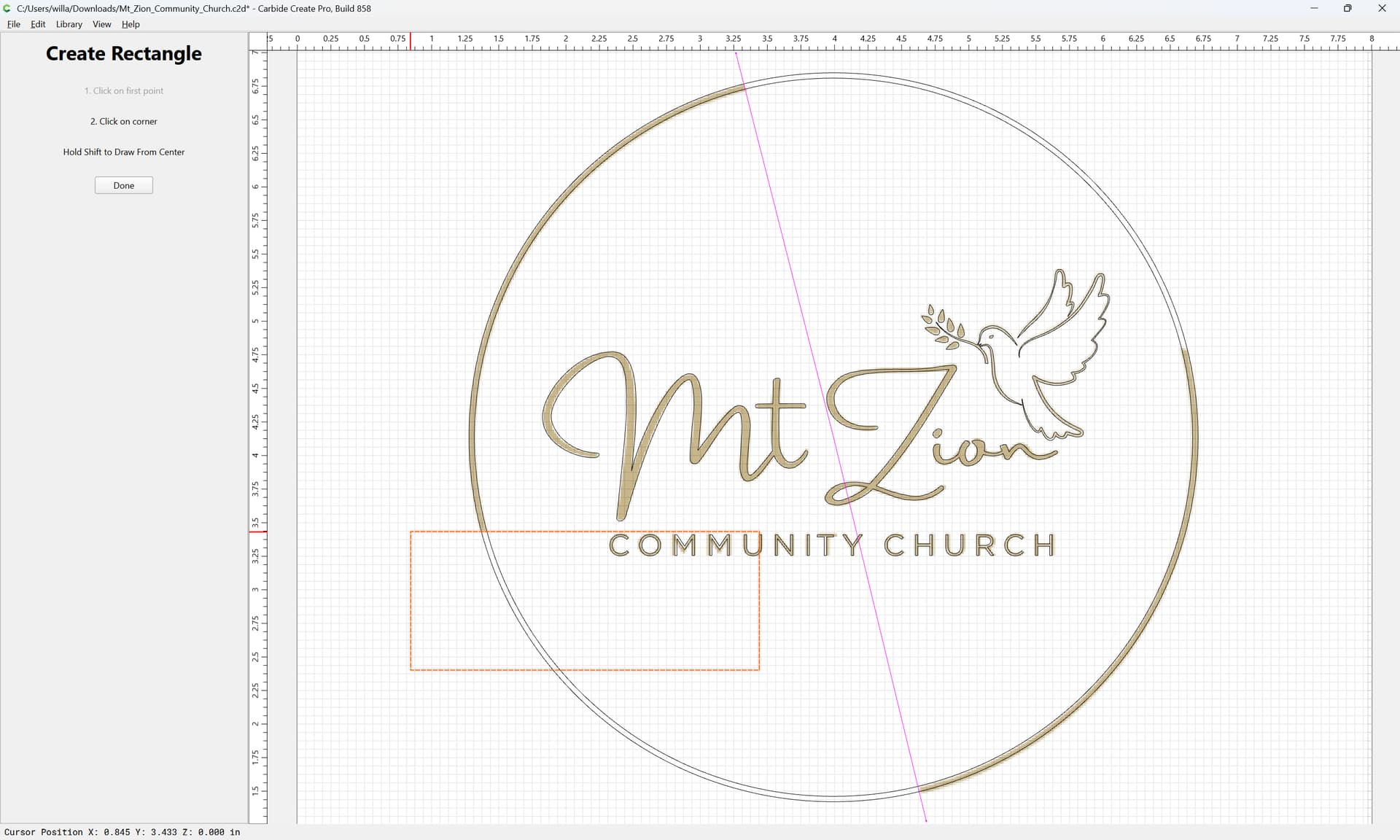

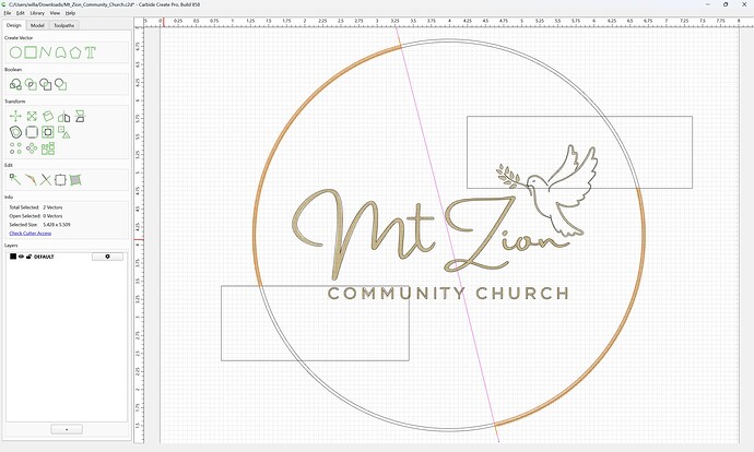

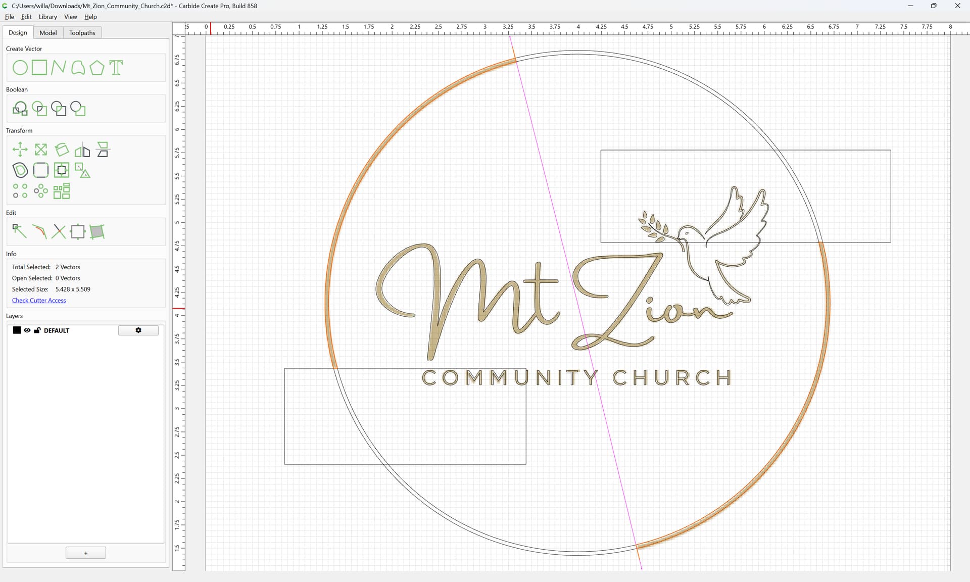

For the balance of the design, draw circles:
and adjust there position and size until things line up:

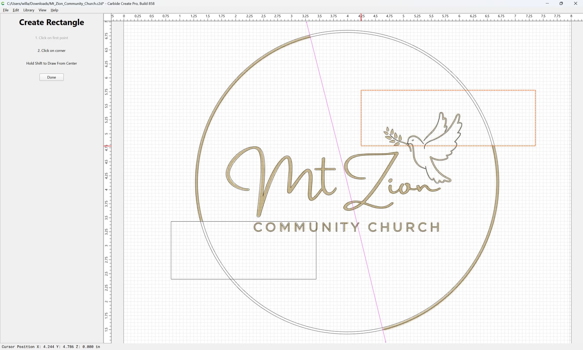

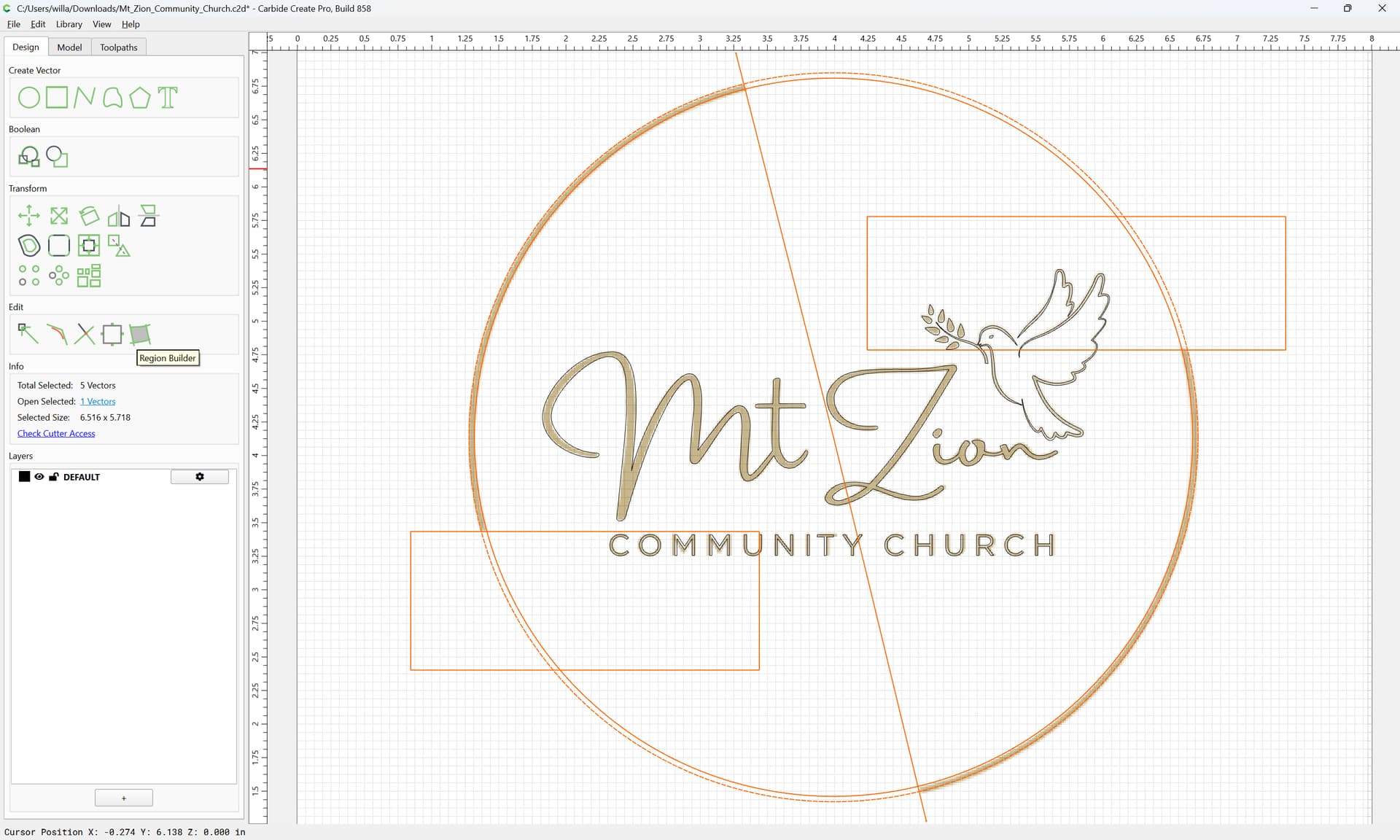

Then draw geometry which cuts things off where and how seems indicated by the available pixels:
Select the geometry in question:
and use Region Builder to define what one wants:
Yes

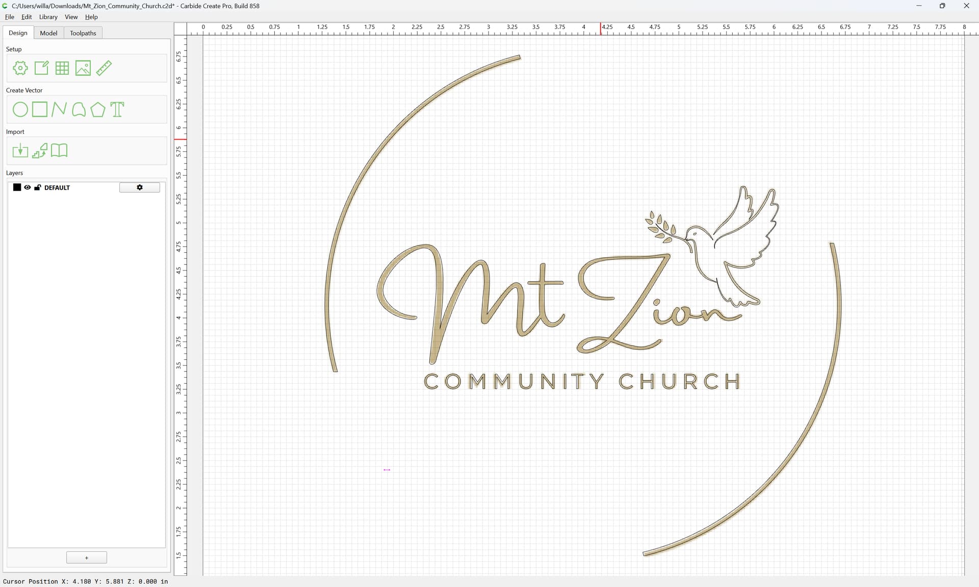

Done
Select
and delete what is not wanted
Resulting in:
