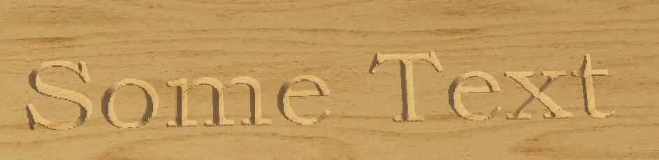

For #2, I think you are looking for V Carve toolpath ( for cases where the V bit is wide enough for all the features), or Advanced VCarve toolpath.
What’s the difference you say?
  • VCarve
  • VCarve, depth is too small
  • Advanced VCarve, no clearing bit
  • Advanced VCarve with clearing bit.
    Screenshot 2023-01-17 013012

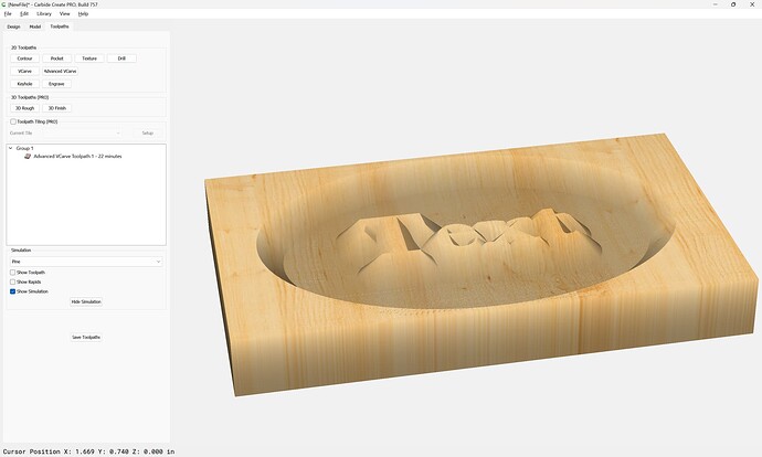

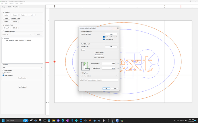

  1. This would be an Advanced V carving:

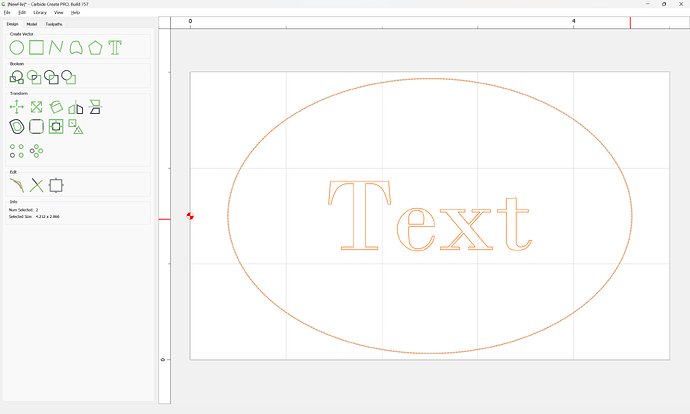

OK, so after creating and placing the text you want, make sure it is selected (it will be orange), and switch to the ‘Toolpaths’ tab on the left. Hit the VCarve button, and tell it 'Use Current Selection".
After that, in the ‘Tool’ section hit Edit and select a V Bit. Once you do, just accept the default values for feeds and speeds.
For a VCarve, change the Max Depth field to ‘t’, a special value that means “the thickness of the stock”. Hit OK, then you can 'Show Simulation" to see what it looks like.
Here is the CC file:
Text VCarve.c2d (108 KB)
In Advanced V-Carve, if you want the Vee bit to do all the clearing, just choose a clearing tool that’s too big to cut anything. :wink:

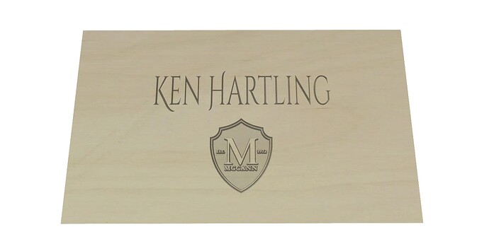

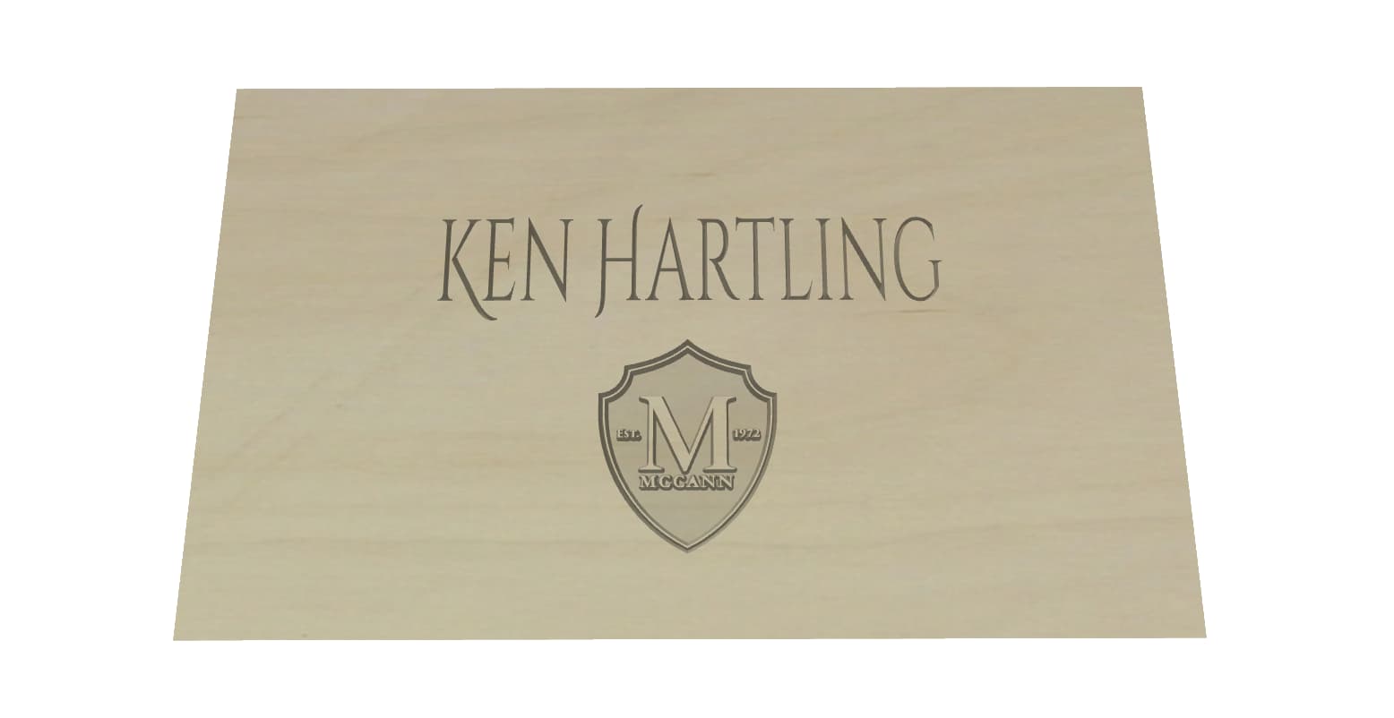

If the “2 stage carving” is only available in the Pro version of CC, how do you do it in the free version? I am unclear as to how I know the cut is complete judging by the Simulation view.
I included an example to see how one would go about cutting this in CC. Again, thank you for the help and replies everyone! Much appreciated!
That would be done as a pair of “Advanced V carving” toolpaths as shown above.
If you export the design as an SVG and post it here we can walk through doing it with you.
