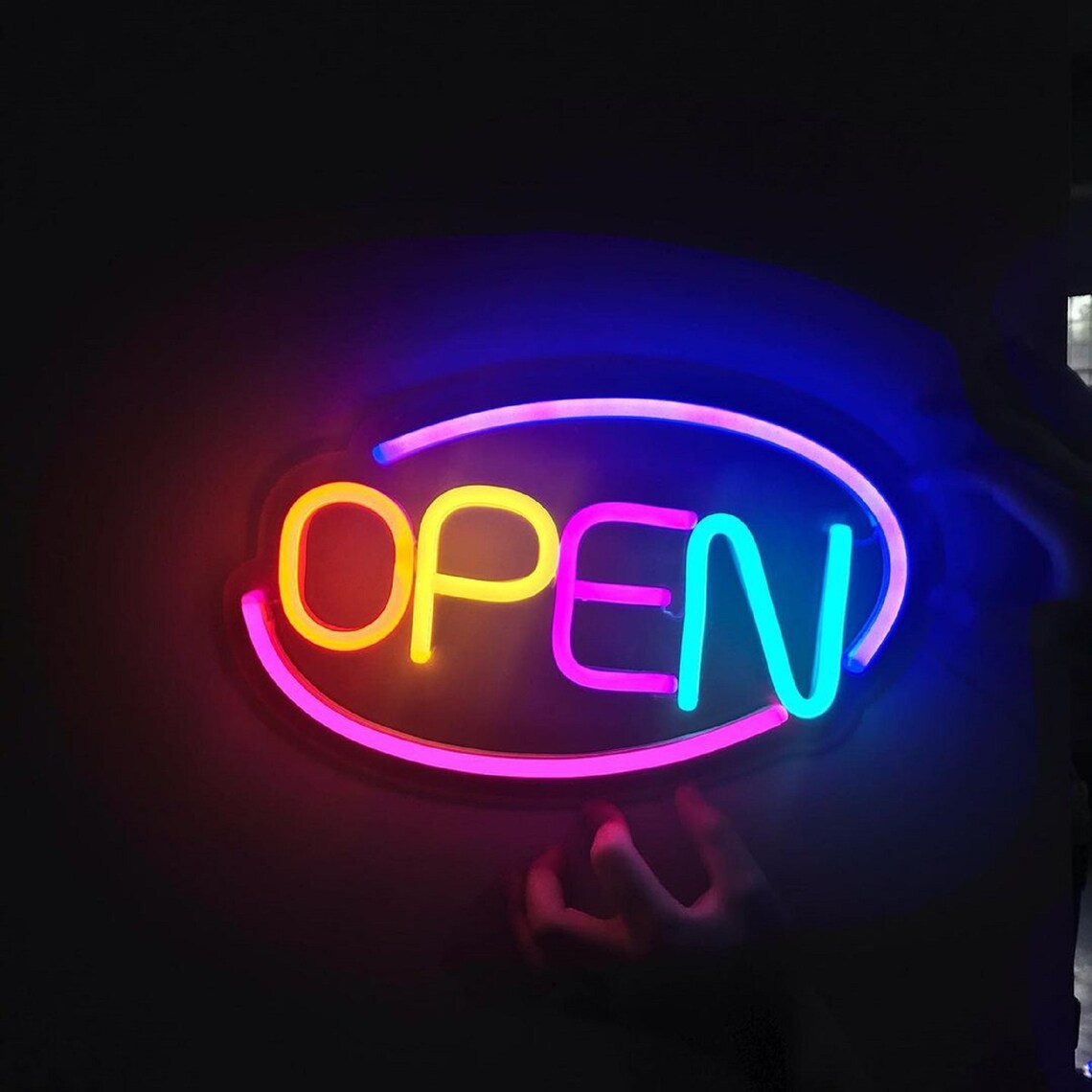

hi everyone hope you are all ok.
i am looking at putting a rebate in perspex for some neon flex led 5mm wide 2mm deep so how can i do it with carbide ?
probably need a font with a single line would probably do ? or just a single line to follow path ?
thanks marko
I wouldn’t bother trying to find a font for that, looks straight forward enough to simply model in a vector program. If you can find a mill the desirable size you could do it as a “contour” where you just follow single lines. Otherwise, create the outline of the letters and do a “pocket” cut. You can probably do this in Carbide Create but dedicated vector programs are better suited.
