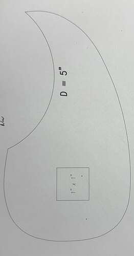

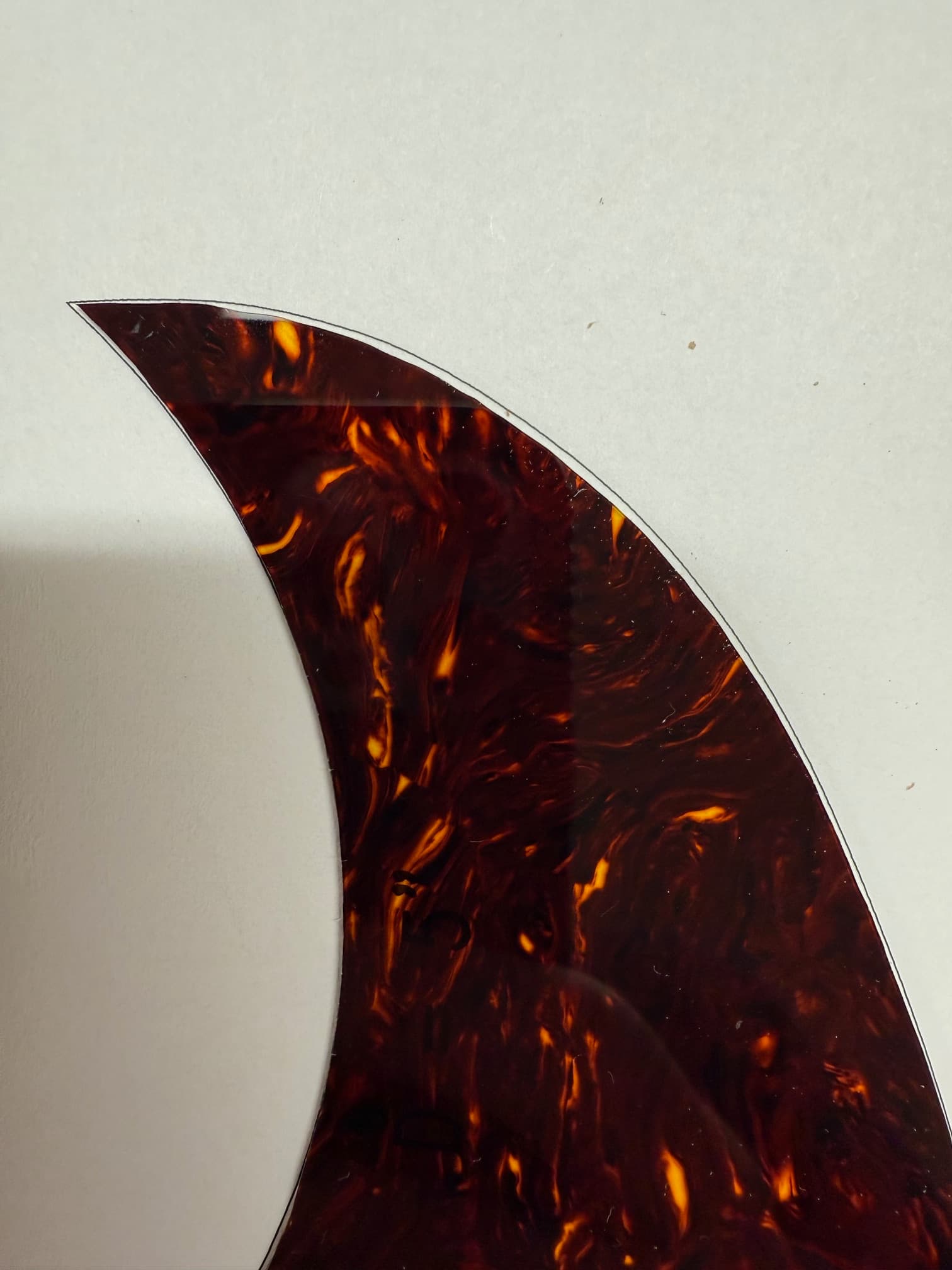

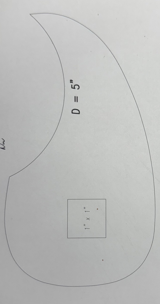

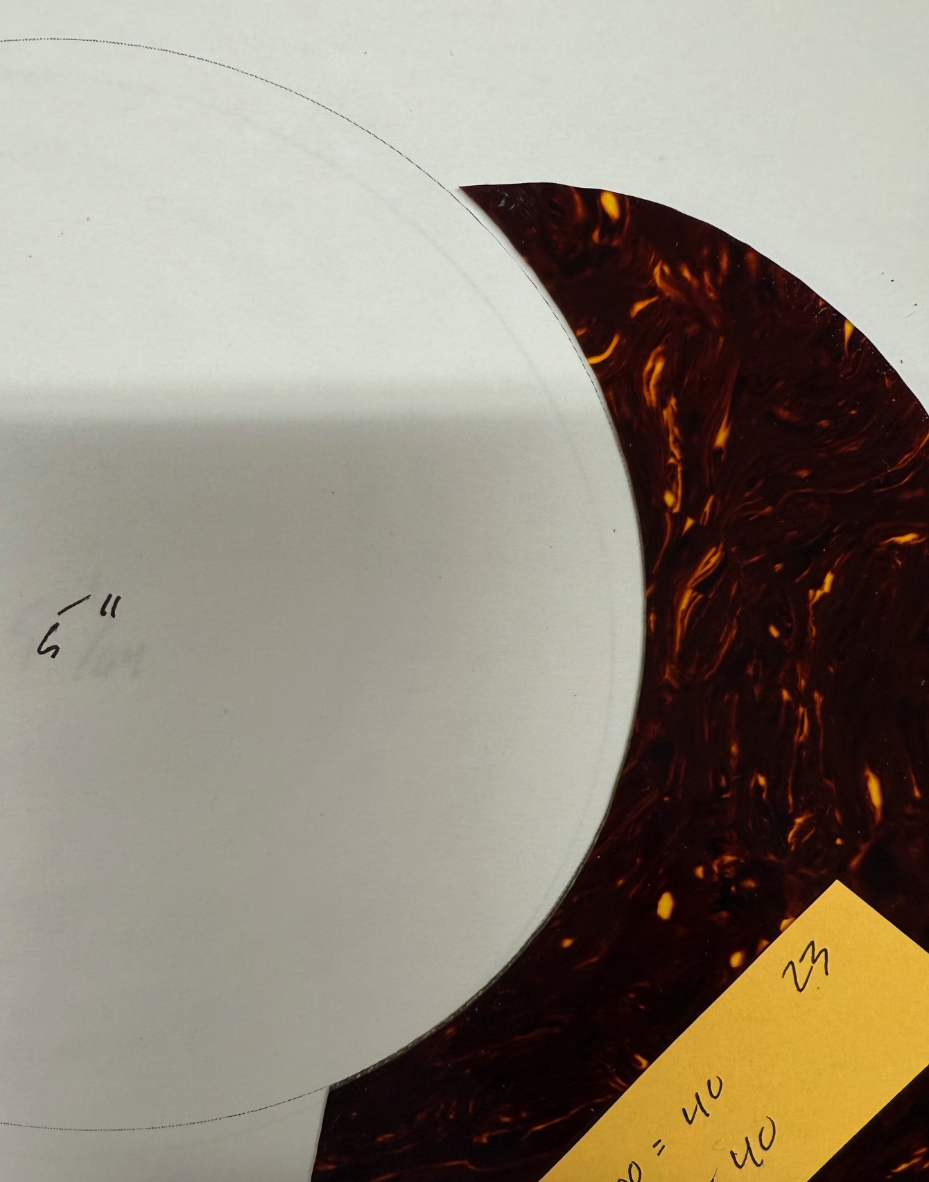

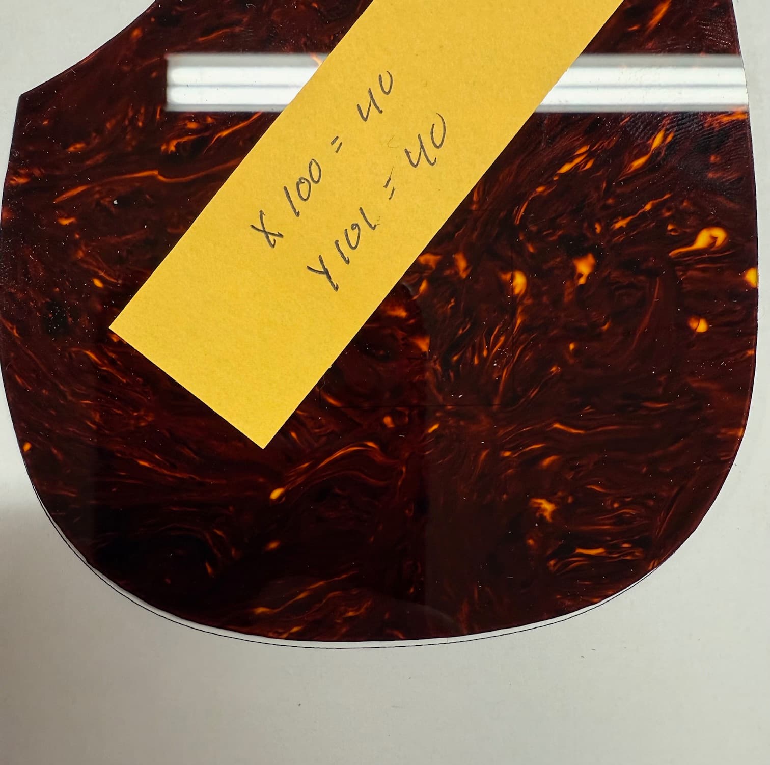

In the meantime, I’ve attached some pictures to illustrate what’s happening. As I mentioned earlier, I’m cutting with a #111 bit (for soft plastic), using contour cuts with the offset set to outside/right. In the photos, you’ll see a PDF template with a 1” x 1” box. You’ll also notice in the other three images that the pickguard’s radius is larger than the 5” diameter circle, the pointed tip is off (with a jagged cut), and the lower rounded bout is too short.
