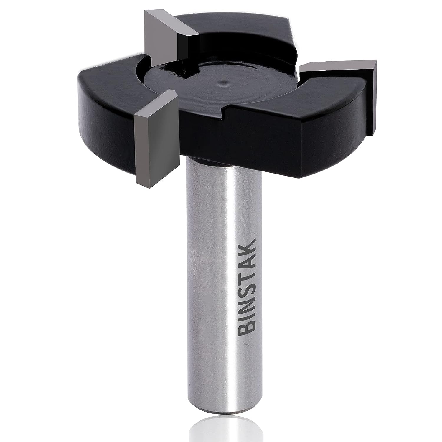

Yes, I have surfaced using the jog function before only because I didn’t allow a big enough cut area in my design. Just disconnect your bitsetter and set the z-axis height to the top of your material. Move the bit off your piece, turn it on and start jogging until flat. Drawing an oversize rectangle and completing a pocket toolpath with a .001 pass is easy as well if you want to run it in CC. Either way you will have to disconnect the bitsetter.

Many surfacing bits have a central area that is not at the same depth as the cutting edges. If the BitSetter fits into that central area, then you get an incorrect value for the length of the tool.
