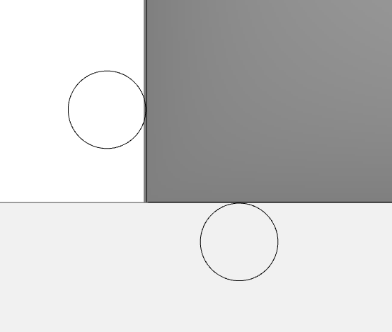

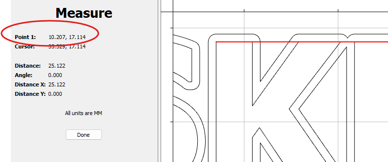

If the original corner or feature you used to zero is gone, cut away, Find a point in the design that is easy to pick up.
Now using a V bit, pick up that point, and set the X & Y values accordingly.
If just the top surface is gone, but the original edges are there, touch off a tool to the front & left edges, and set the XY values to the negative radius of the cutter. For a 1/4" tool, set X -0.125, Y-0.125
