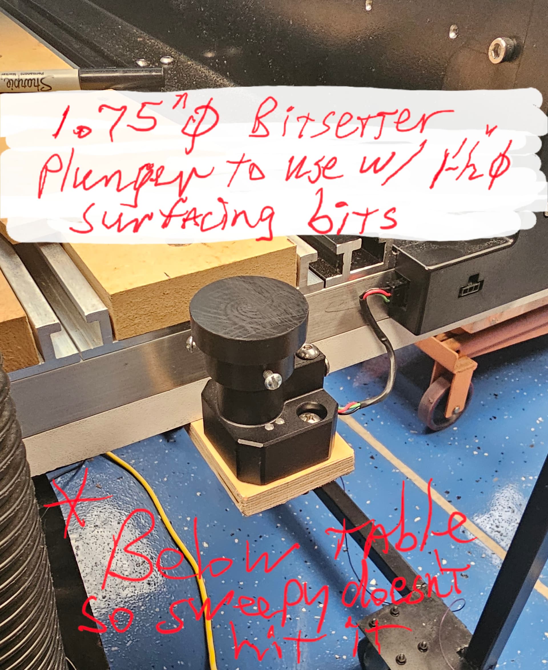

I have relocated the Bitsetter below the waste board surface on my Shapeoko 5 to clear the sweepy vac attachment if cutting in that corner. Note, I have offset my gantry to allow 3.5" of Y axis over-run for joinery or oversize machining. I also made a larger Bitsetter button to accommodate my 1.5" dia surfacing bit; that way I don’t have to disable the Bitsetter when using the surfacing bit.
I built an aluminum relocation bracket to allow me to use it while cutting 4x4 Sheets.
You can use a bit setter with a 1.5” bit without an issue. There is no need for the bit to contact the center of the button. I set mine up with a v bit to contact the back left corner. Did the same for years on s3.
You just need to line up the cutter with the button.
I like your adapter. I simplified mine a bit.
It works
My surface bit inserts only contact the surface on the outer edges
The flat of the bit setter is 7/8” dia. If you x enter close to the edg of the bit setter like I said a 1.5” diameter but works just fine. I do it daily with a 1.5” surfacing bit.
