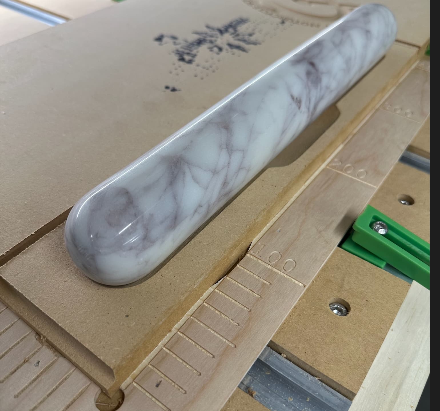

In CC Pro Is there a way to reposition the 3d model after its done? I’ve been working on a stock size that is much larger than needed and would like to reposition everything to the lower left before making it.
My alternative is to base it around a center, but I prefer a lower left zero and a stock size that is accurate.
Thanks.
kitchen roller holder.c2d (276 KB)
No.
You can export the 3D model as a pixel image, make a new file, then re-import the pixel image at the desired position.
Thanks William. Using the center zero I was able to make a good test cut. Now I just need to prep some walnut for the final version.
