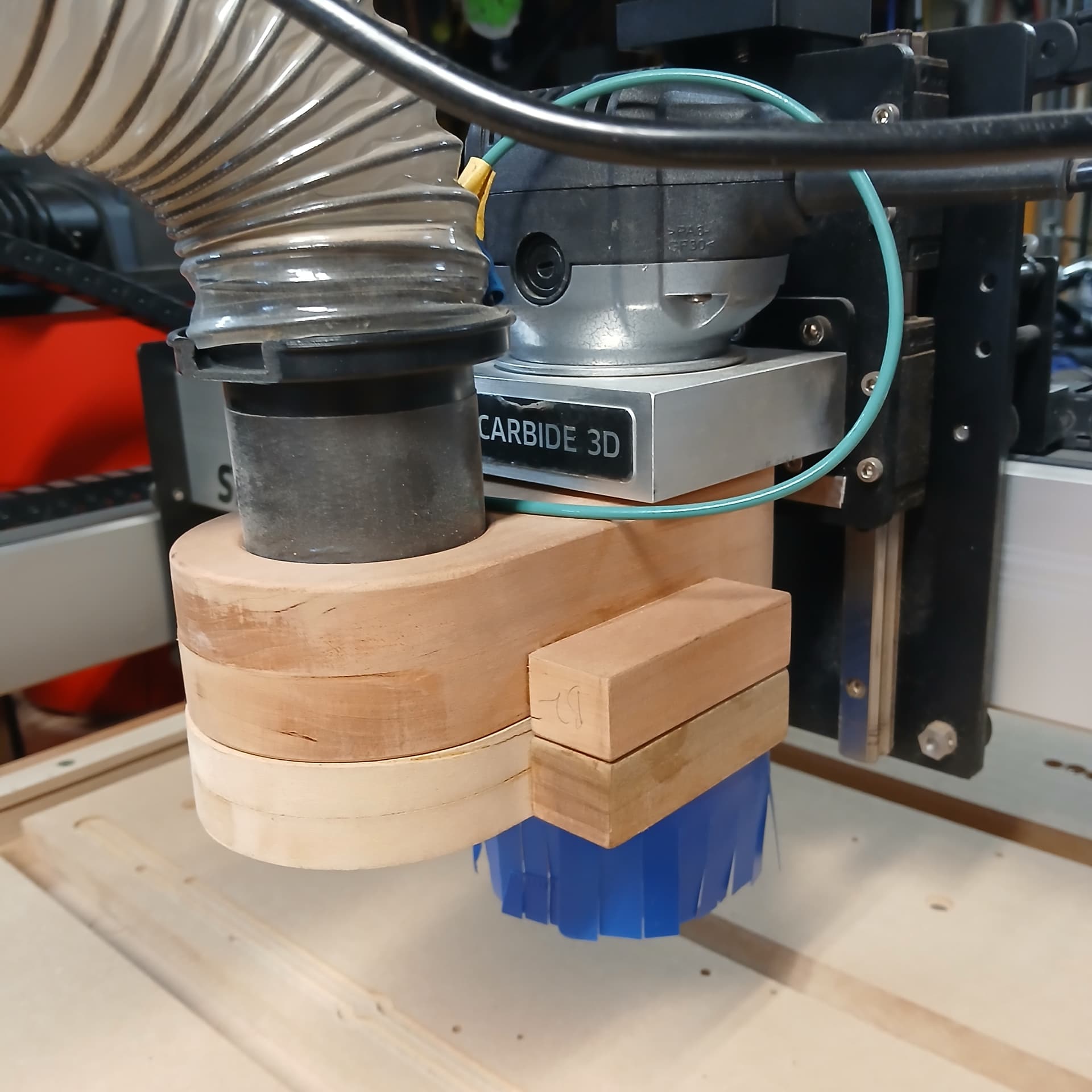

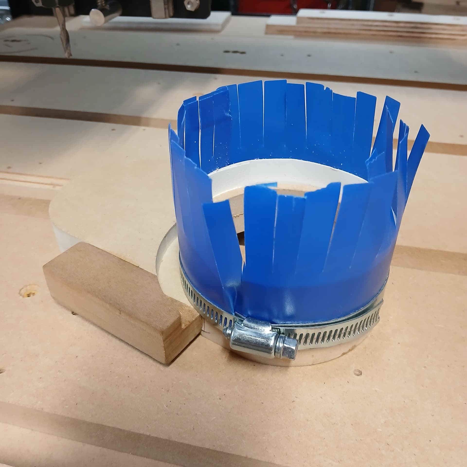

You have a CNC router. Make your own.

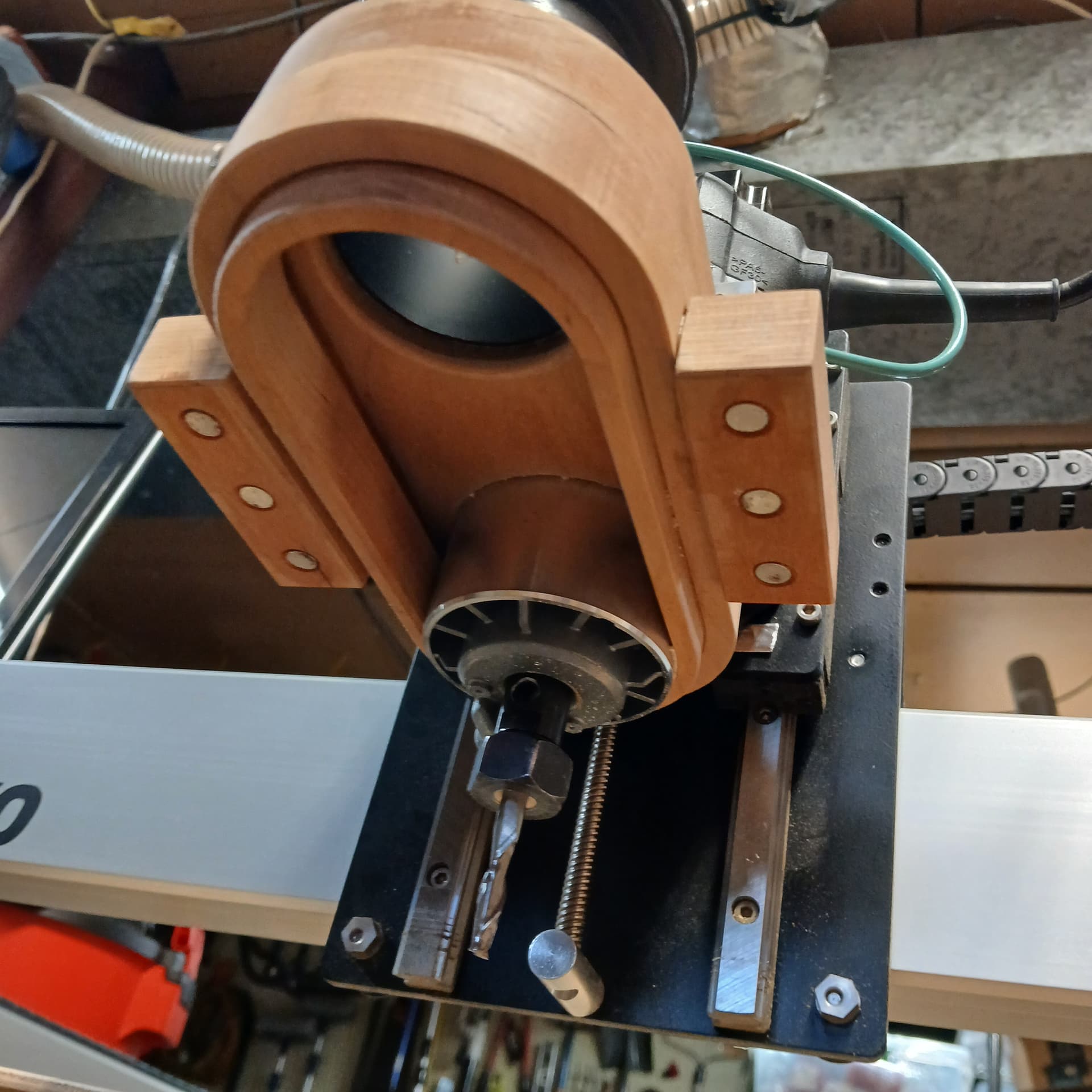

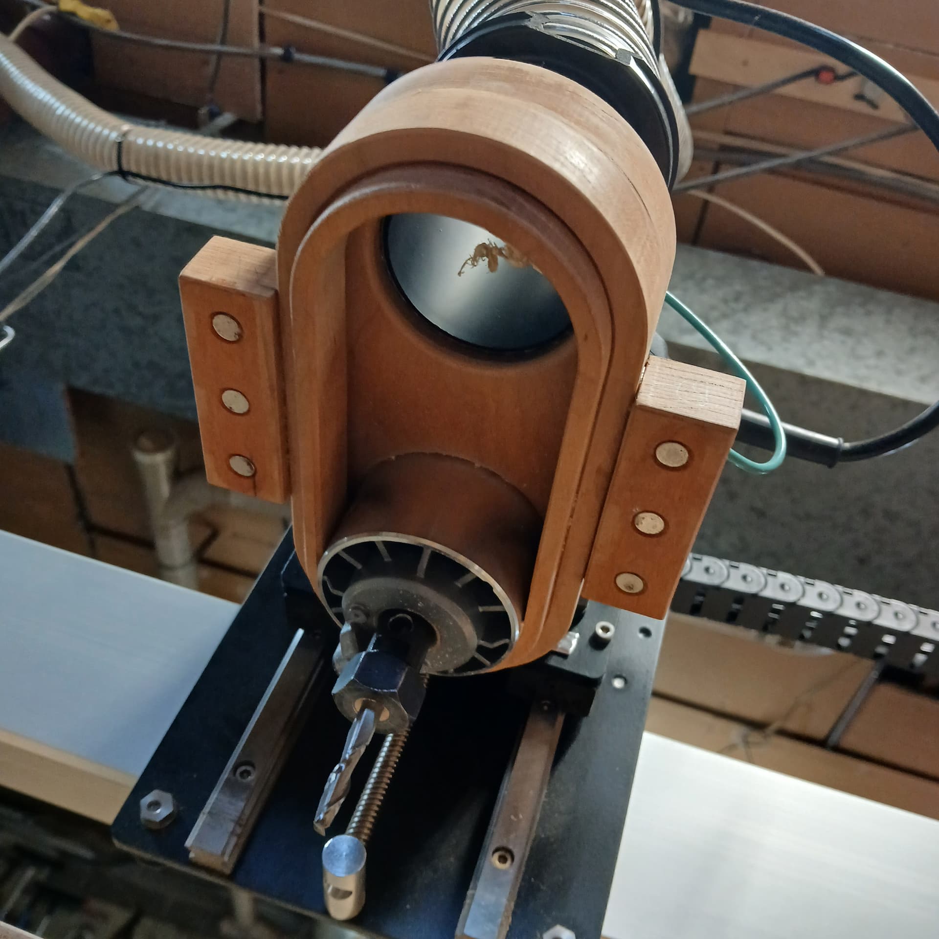

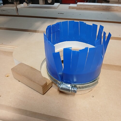

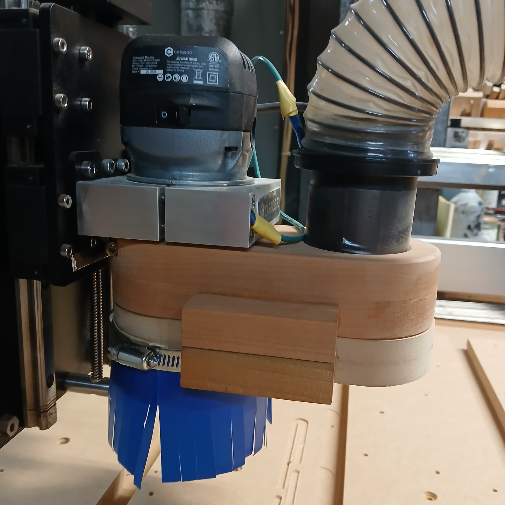

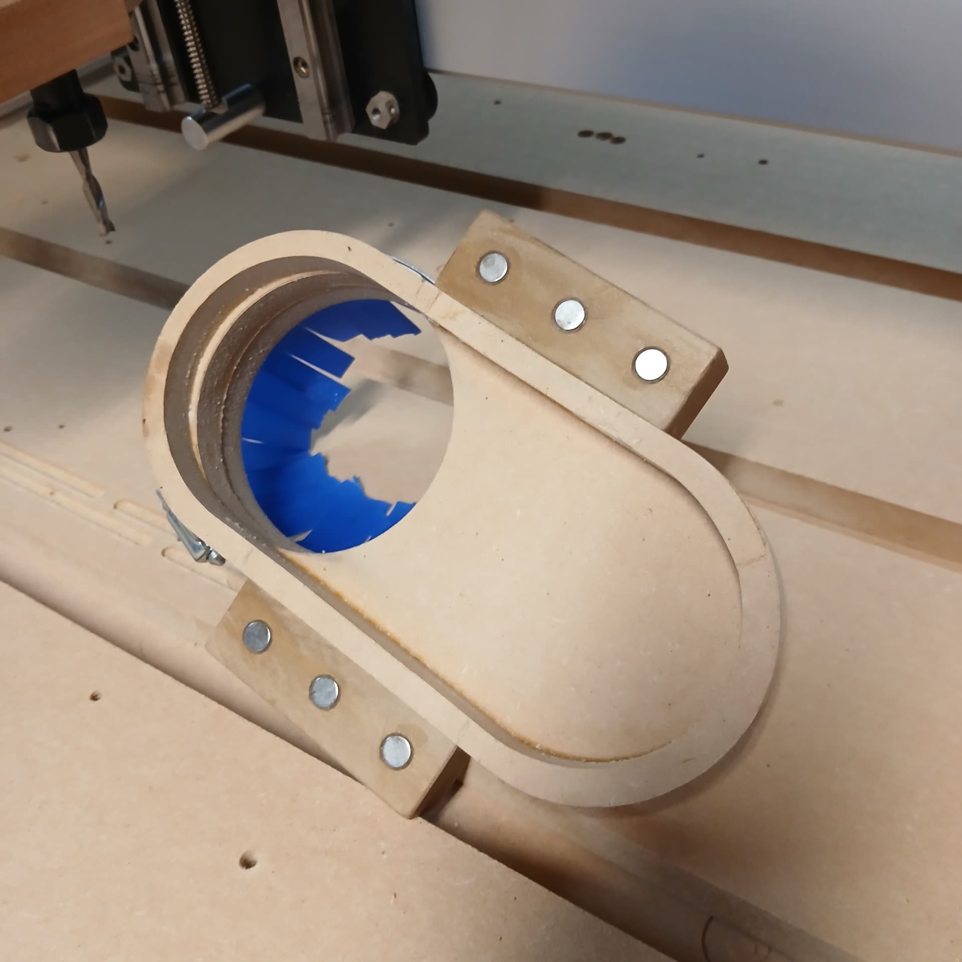

Yeah, if you are already invested, I can understand. I tried a couple of the plastic versions and found them very lacking for my applications, so I just made this. Easy to use and I can use just about anything for the “brushes”.
Just a thought for future endeavors.
