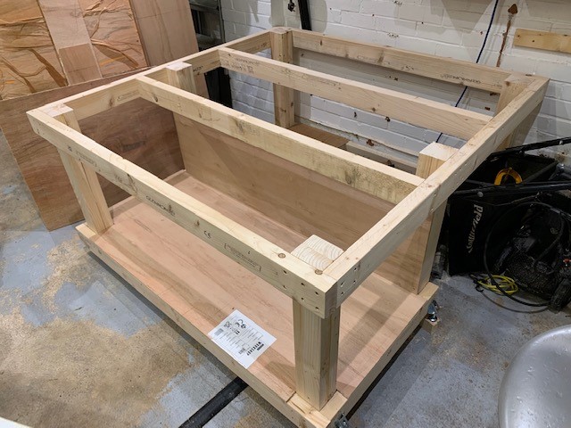

I know a lot of people in the US are going with the Kreg table kit. That extra 4 inches would actually have made enough difference that space would have been too tight. I also needed to work around other things, like fitting a lawn mover under it, which the Kreg wouldn’t allow.
Add to that, the Kreg kit looked like it was about £300 without casters or top/base so I went with a self build option. The frame was all 2"x4", with parts glued and screwed together to make 4x4 for the legs. The top is basic plywood from B&Q @ £45 a sheet. It took fractionally more that one sheet the way I did it, but I had some spare to work with. The bottom shelf has 9mm ply for the surface.
Add some casters from Amazon for about £15 (will take 400kg) and then some height adjusting small legs (can be seen in the image above) for about £20 and that’s it. My garage floor slopes away so I had to raise the front left by about 10mm and the front right by about 35mm!
Total cost for this was around £170 plus the 9mm ply I already had. You can also see that I had a lot of 2x4 left over (in the front shelf).
Here is the basic frame before I added a couple of extra cross pieces where the top boards would join.

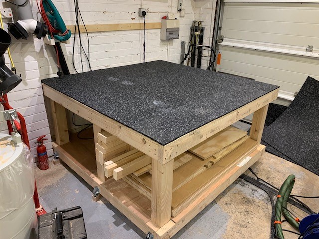

The top was made up of 4’x2’ pieces stuck together because this is all I can get in my car. I used Dominoes to join them, but you could just as easily use dowels or other methods. After that I ran a flush trim bit around the edges and round over on the top to make it fit.
Gluing the top
Top complete
Add some rubber matting
With Rubber
