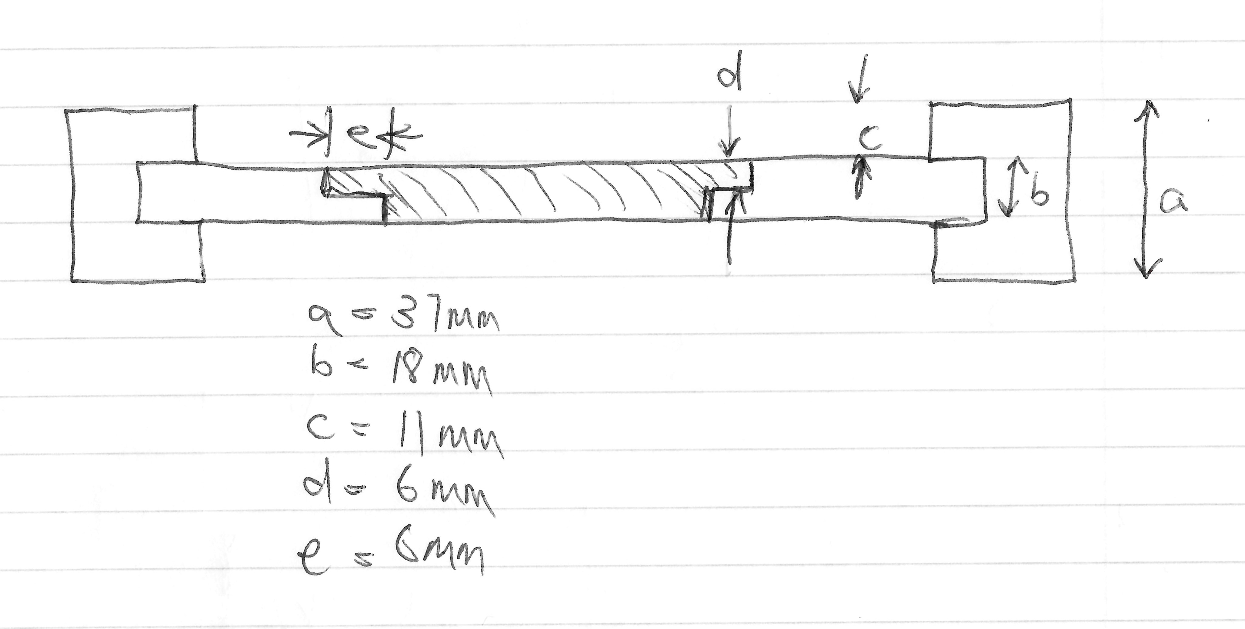

I want to cut a window frame out of an enclosure door to fit a perspex sheet, but the door is glued so I can’t take it apart.
In profile, it looks like the image below (sorry about the crap drawing - I’m left handed :wink: ) and the shaded area is what I want to cut out, with a 6mm rebate for the perspex to sit in.
I’ve used (a = 37mm) as the stock height, (c =11mm) as the start depth, (d = 6mm) for the DoC for the rebate, and (b = 18mm) for the DoC of the cutout, but this looks wrong in the simulation.
Would it be better to use (a - c = 26mm) or (b = 18mm) as the stock height, with a higher retract height to miss the frame?

I would fully support the center of the door panel you want to cut, and then zero your bit to the top surface of the panel. Then the dimensions a and c are not needed.
That makes sense to me!
Would it also make sense to zero the workpiece at that height, too, and adjust the workpiece dimensions accordingly?
