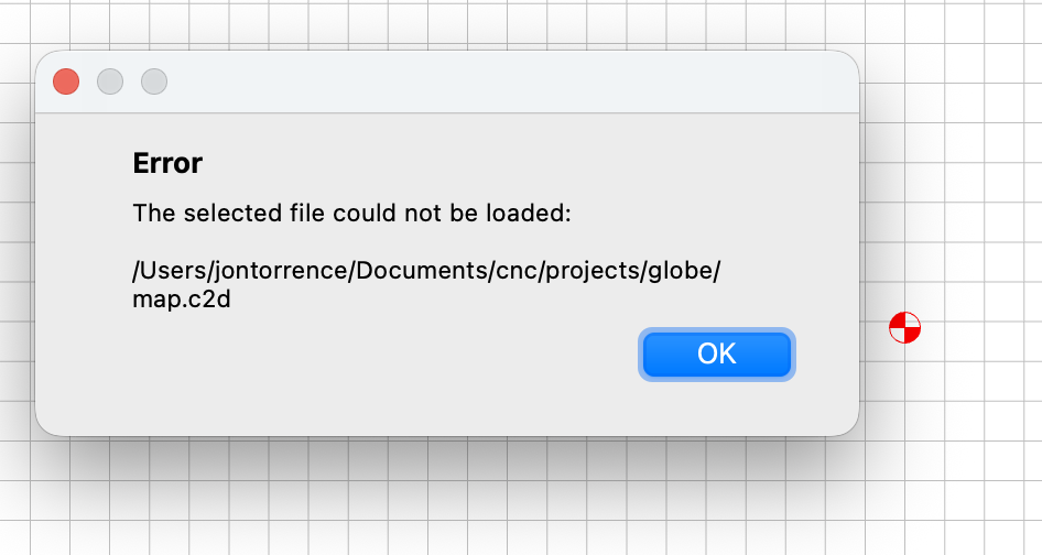

I have opened and saved the file but CC gives a message that it is unable to open after the save?
What version of Carbide Create are you in?
Upload a screen capture of the message please.

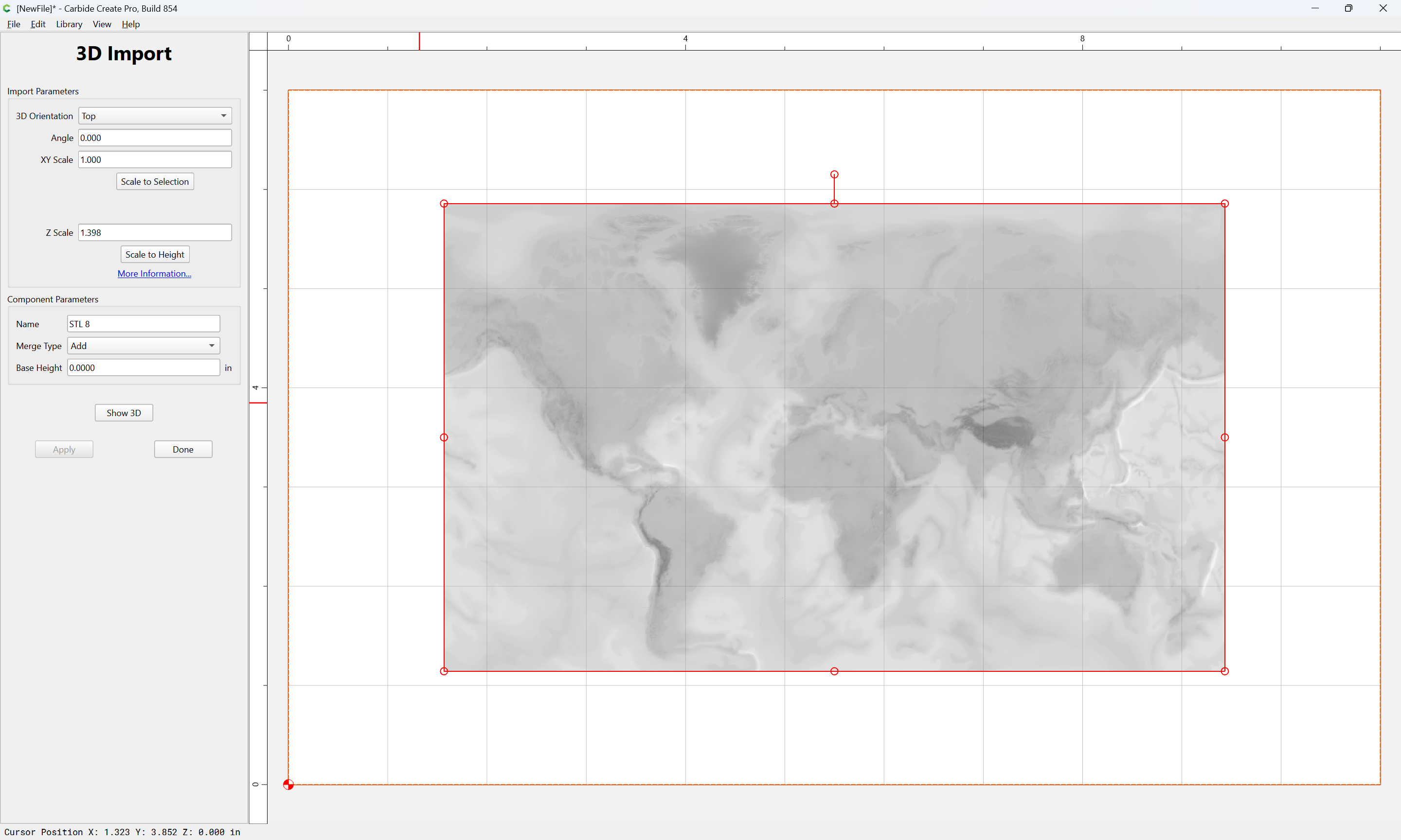

Yeh, we may need to see the whole process. It should look something like…
Start CC
Job setup, set stock size, set thickness, choose zero point…
Model tab, Import STL File, select the .stl file
Select the orientation, XY scale, Z scale, Merge type, base, etc… Done
Show 3D
Save File. (This will save a .c2d file)
Close CC
Open CC
File → Recent File → The file you saved.

Uploading: Screenshot 2026-07-22 at 12.11.43 PM.png…
Screen shot of the message
i have the cc pro version
Jon,
Try saving it to your desktop and opening it there. Carbide Create has no idea when a file is from a 3rd party. Let us know what happens.

I have the file saved on my Mac. I have tried several times to download save and the reopen and always get the same message I posted earlier.
I gave up and found another stl file. This one seems to be working correctly.
Thanks for all the help folks.

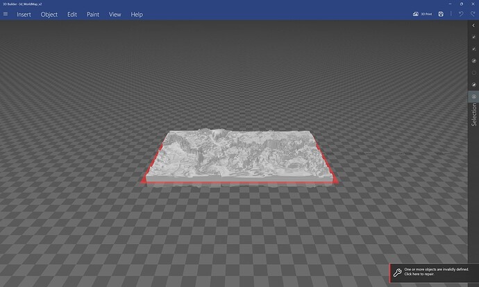

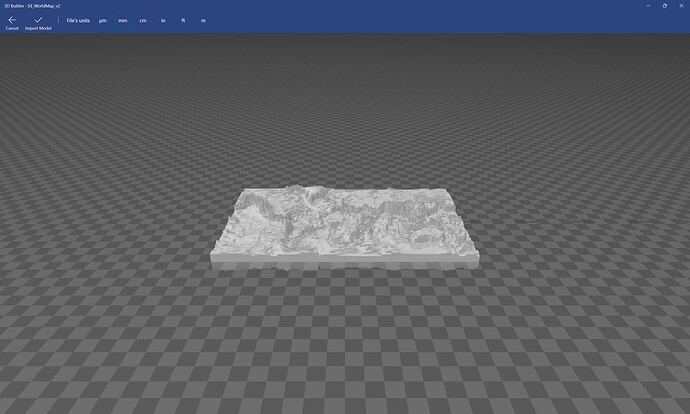

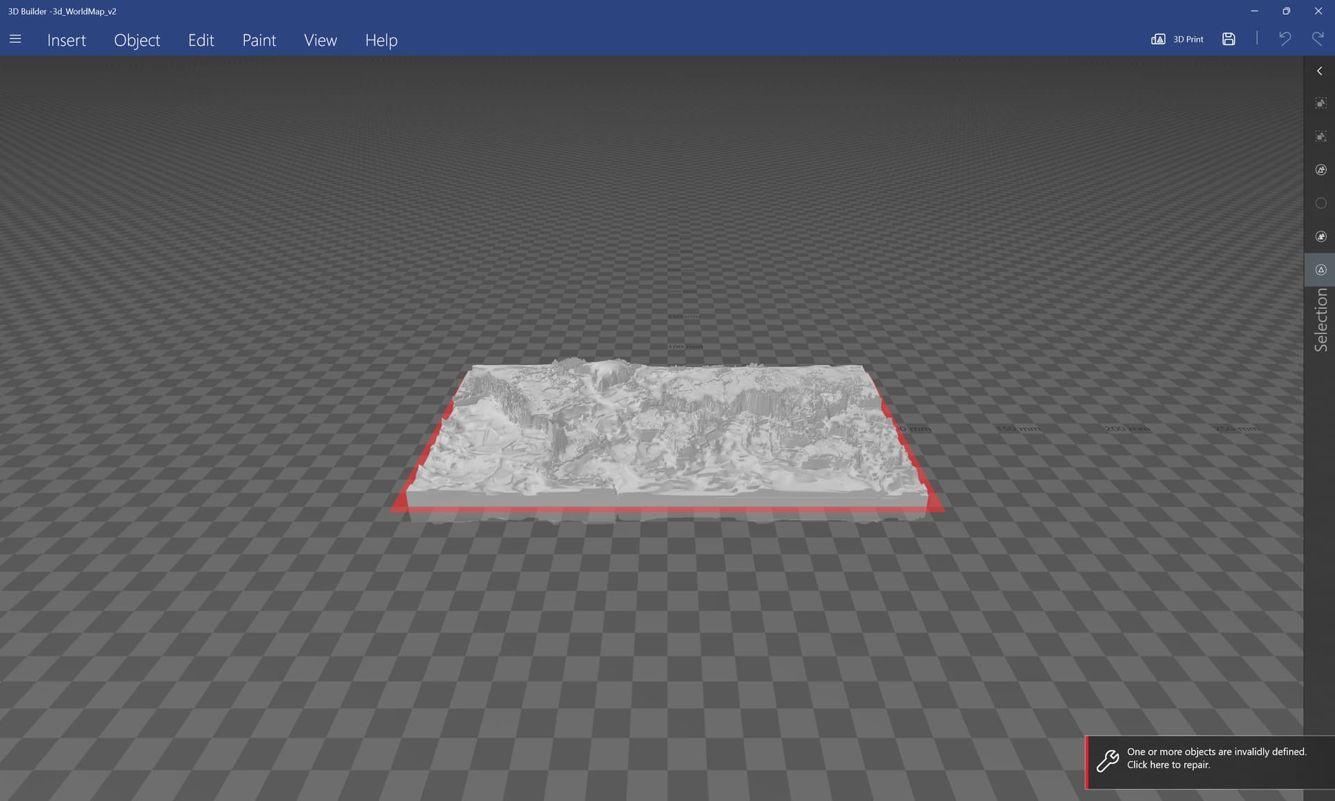

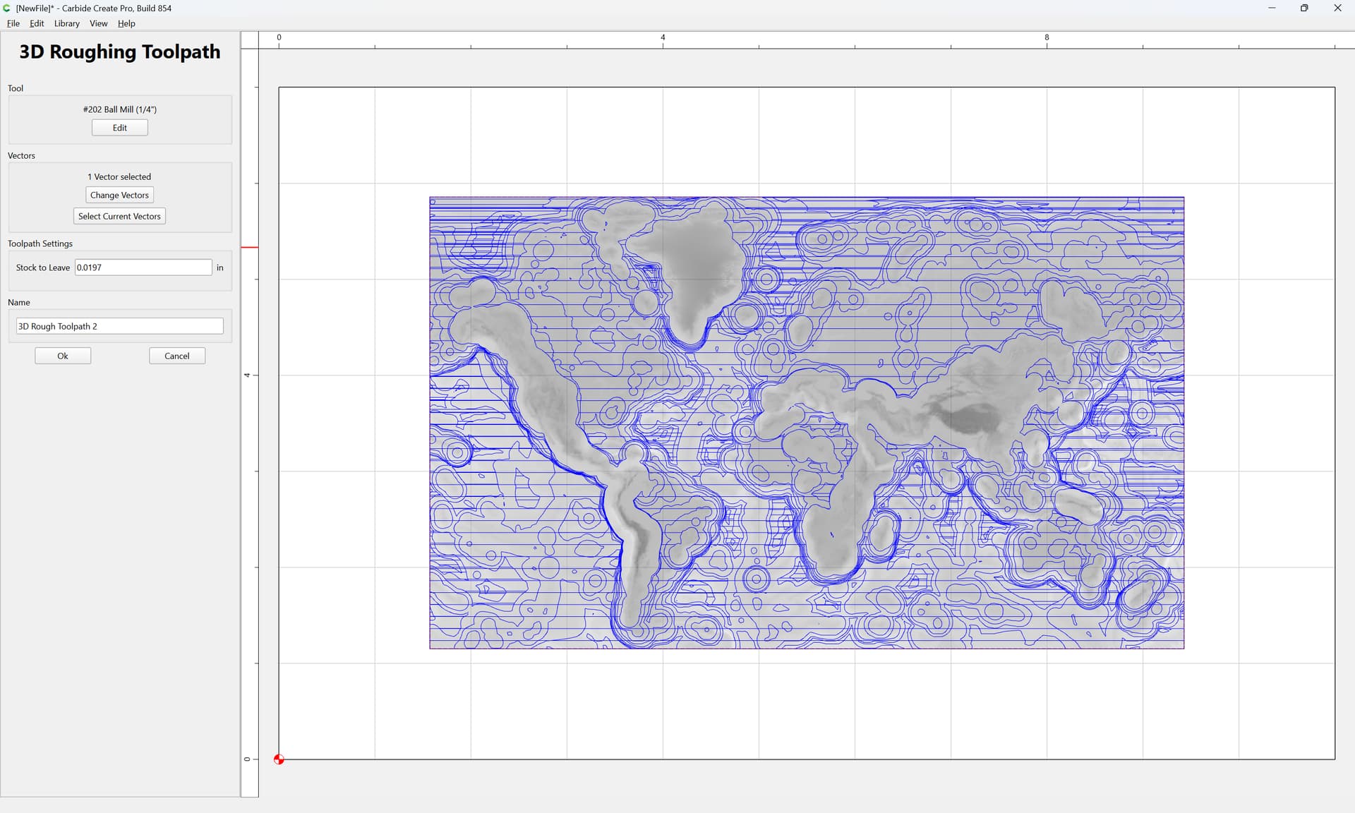

The STL seems straight-forward:
aside from needing repair:
(which probably does not have anything to do with these issues)

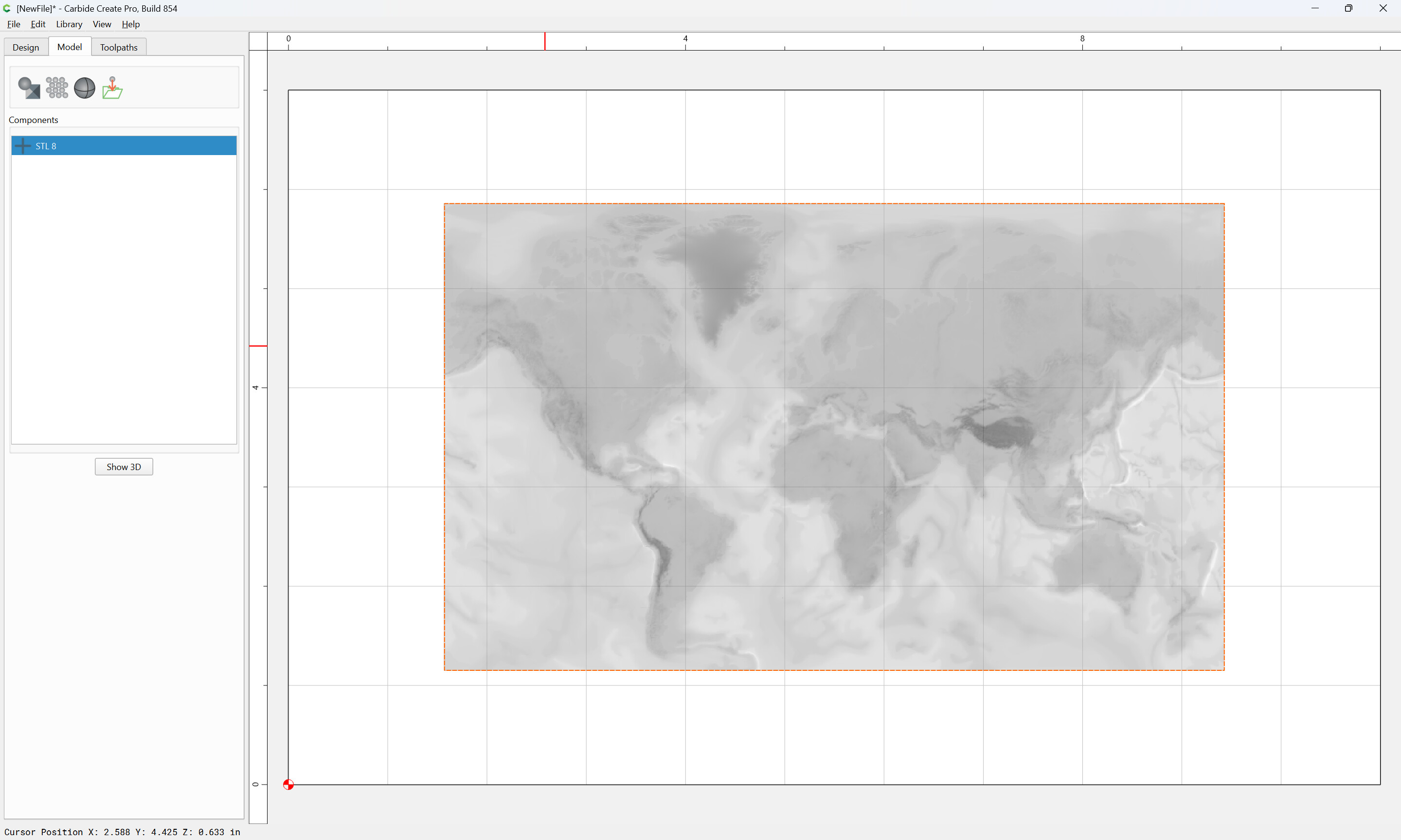

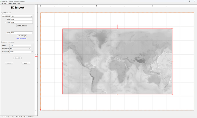

and when downloaded locally imports into Carbide Create Pro as expected:

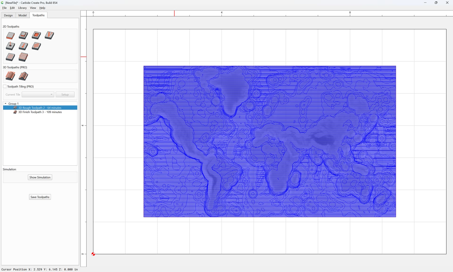

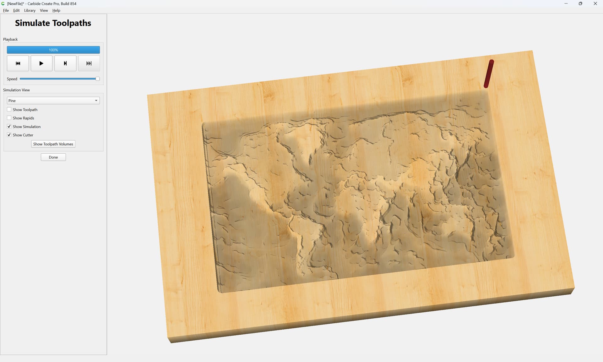

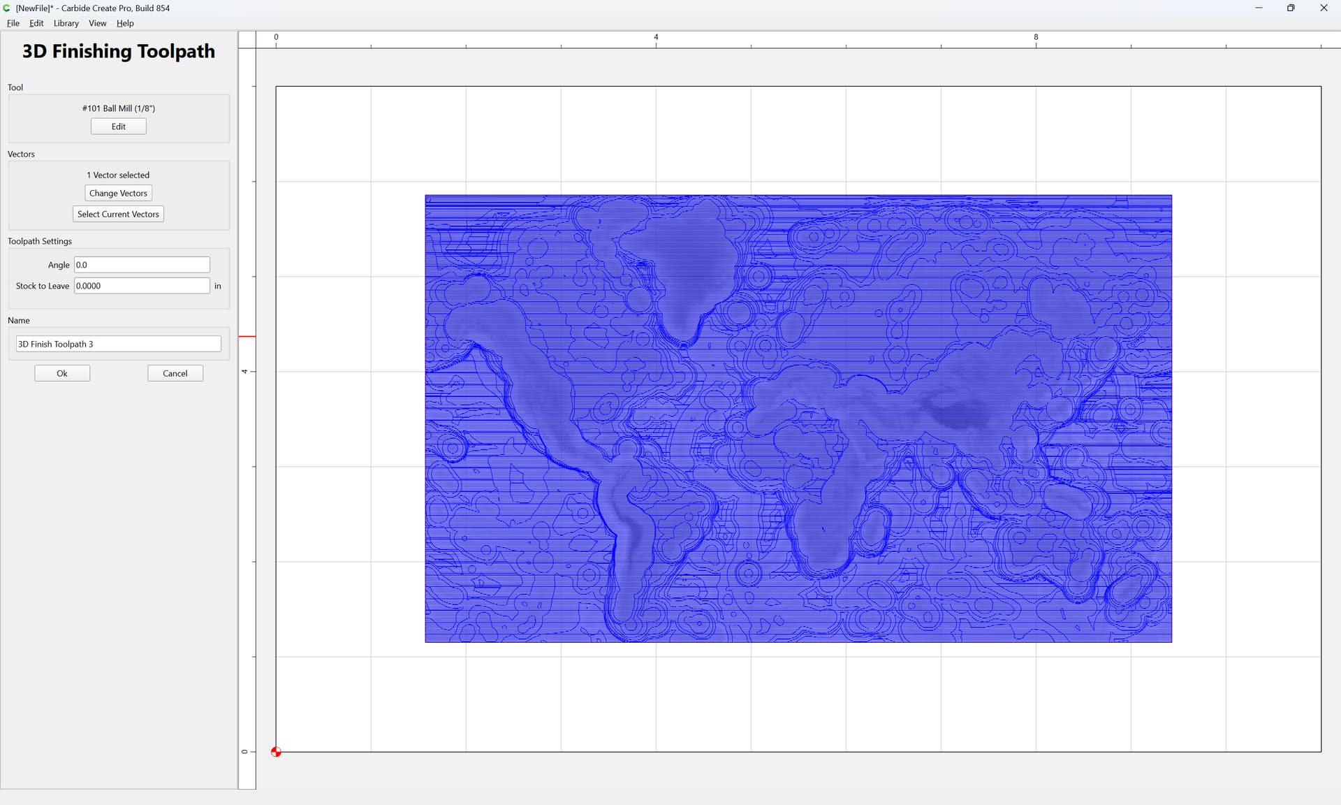

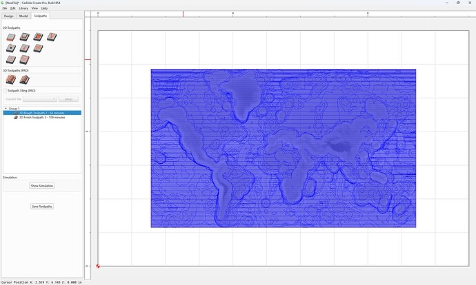

If we add toolpaths:
it previews as expected:

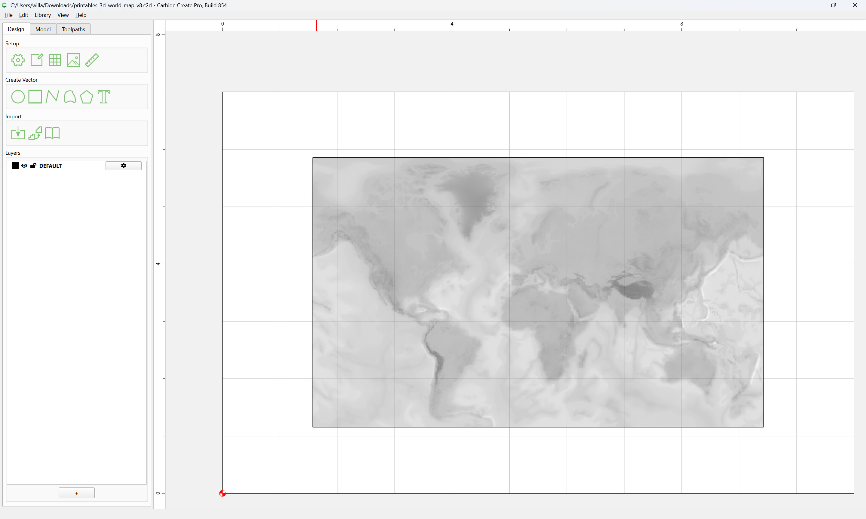

and if saved locally, and one quits and relaunches, loads as expected:
Too large to attach, copy on a Google Drive:
35 MB, be sure when saving to save to the local system drive.
