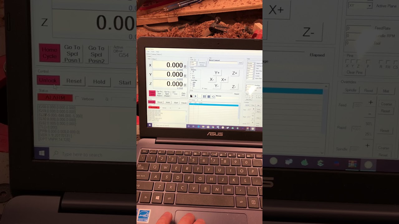

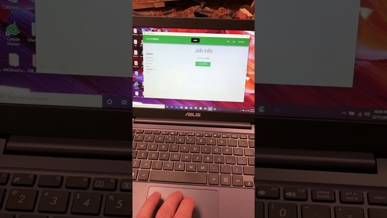

Links to GRBL Panel working fine and CM (Build 428) sending X and Y into runaway.

Carbide Motion (weirdly? I’m sure there is a reason, but why not just use a G91?) uses a jog command that uses absolute machine position. I suspect that, combined with your custom config (home front left) is causing an issue.
Copy and paste the log output when you hit that jog command, and it should be clear what’s going on.
I believe your suspicion has been confirmed. I used G91 commands last evening and got it to behave differently…but still moving X/Y simultaneously, just not to infinity. I changed $23 from 3 to standard 0 and things now seem to work fine. I’ve utilized $23=3 forever, so this will be a bit of a change for my work flows, work offsets, etc.
