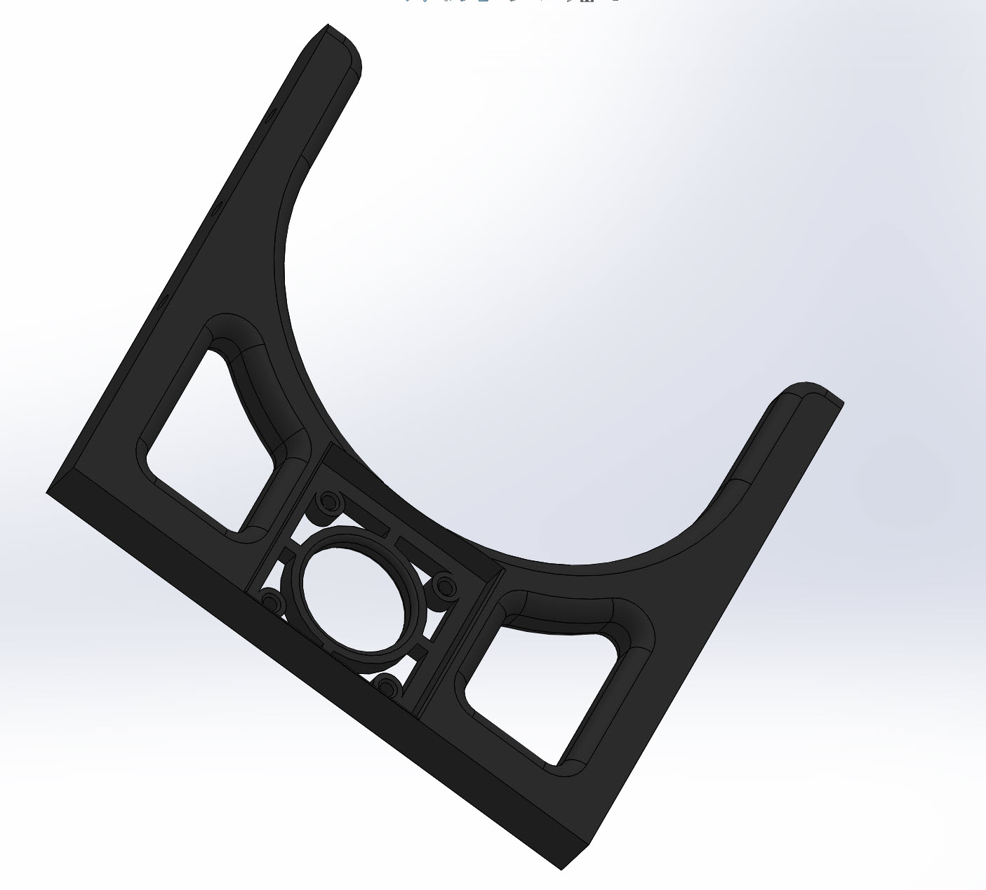

I later purchased my Shapeoko XXL about 6 months ago. I wanted to use the laser from my 3018 on the shapeoko. I designed a mount to fit the suckit dust boot. Ill share the STL files in here if possible. Suckit Laser Mount.STL (614.6 KB)
Here is a Solidworks mock up.
So now I have a mount. I went to connect my laser to the Control board. I didn’t want to use a external power supply so i designed a 24V to 12V buck converter. I pull 24 volts from the Power rail on the Shapeoko and down convert it to 12v I also pull the PWM signal from the PWM pin in the Control board. For my laser module driver it is using a negative PWM input to work. The PWM from the control board on shapeoko is sending a +5v signal as you would expect. Why the inverse on sainsmart i have no idea. I read that you could invert in GRBL. I did not want to modify the GRBL settings. so i used a 7400 Inverter IC. pin 1 and pin2 connected together and Output pin 3 to Sainsmart driver. IT works perfectly. the laser runs at full power though the buck and gets the appropriate pwm to fire the laser and Burn with Lightburn.
