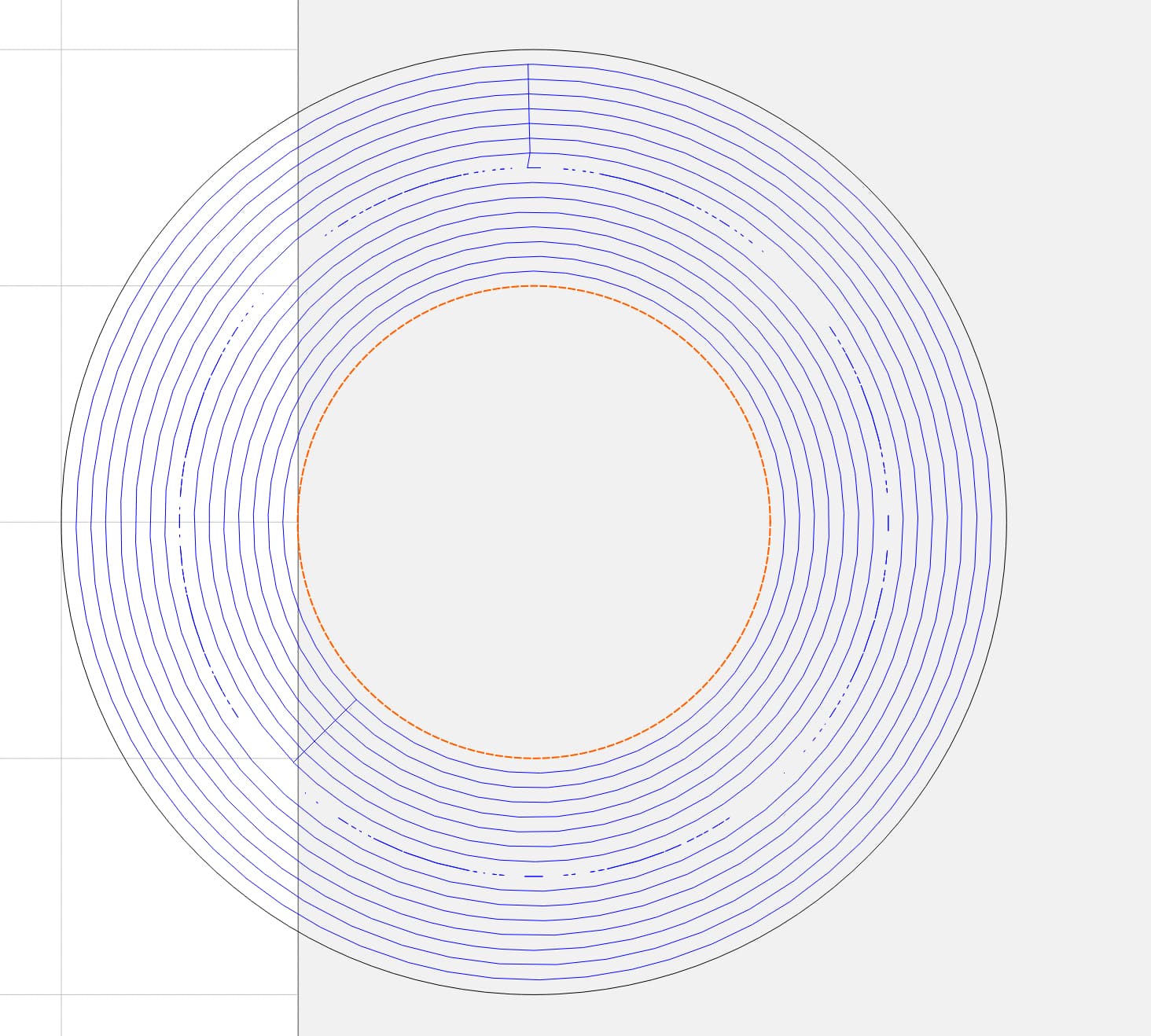

Thank you for your answer. I’m now thinking that wasn’t my problem now. I have what I’m thinking is a basic pocket operation that is acting funny.
I have a 4" circle, and a 2" circle and I wan’t to pocket in between them.
It gives me a broken path with many different paths that aren’t very efficient. I have to be missing something.
If I create a 4.2" outside circle and a 2" inside circle the pocket path looks ok.
What you show happens when the stepover exactly matches the area between geometries — try slightly changing the stepover value — that should allow you to find a value which creates regular toolpaths.
