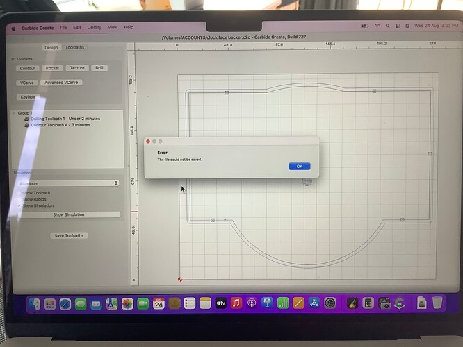

I need a little help,I can not save a tool path from 727 to anywhere but a USB drive.It says file error each time I try and save apart from the USB.Have CM 566.I think I have missed something.Thanks for the help

Hi Rob,I am on a bare Mac Book air M2 with nothing else on it apart from Cc and CM,not even email system.
This what I get
Macs have some funky permission systems where you have to click ‘ok’ to a pop up when saving to a new directory. It does this to me every time I install a new release.
Hi Rob,nothing pops up,both saving options give me the error,do I need to set up a new directory or pair CM or something.Nothing is being saved apart from the USB.
I think I have the problem solved,I named the Folder,Carbide Motion,so the Mac book obviously tried to send it to carbide motion.I renamed it and all looks good,I will try the air cut in the morning.Thanks for the help
