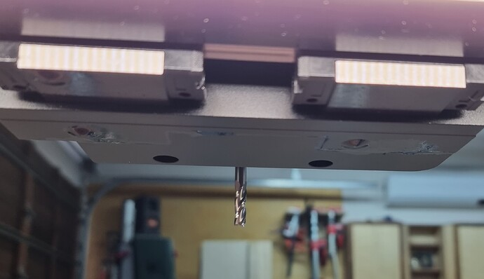

Hi Guys, I’m very new. Just got my machine running two days ago. I was hearing a strange noise, but being new was not even certain it is abnormal.

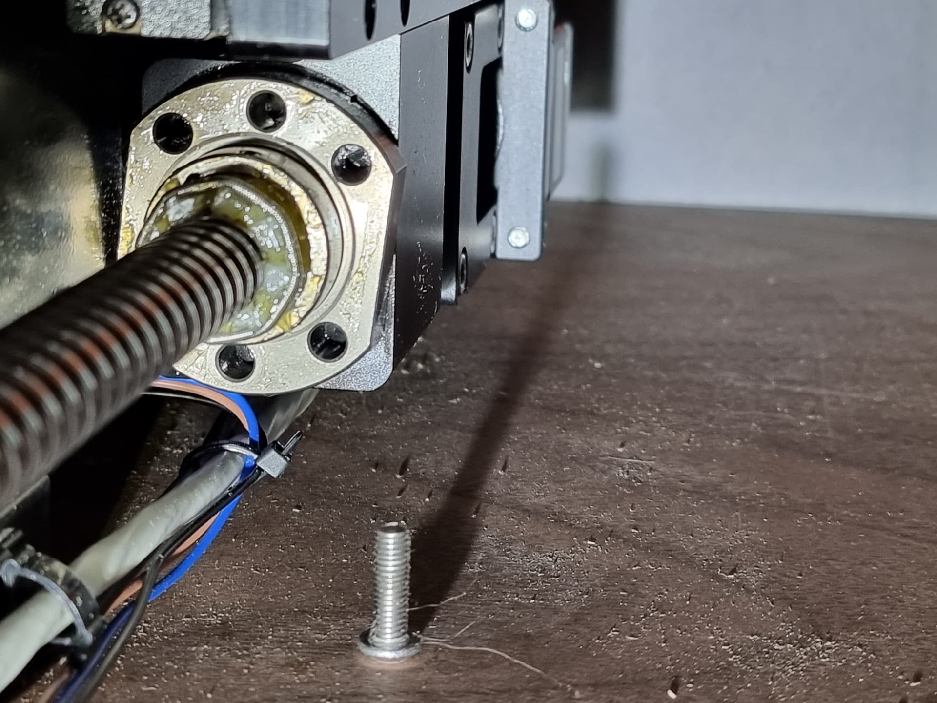

Starting looking around and found both screws out in the picture below. Only 1 screw was on the table and I’m unable to find the other one. It must have gone missing before this point.
I have about 4 hours of total work time on the machine. Can I just screw it up tight or could there be further issues with alignment or something?
Not sure if the picture upload will work.

Start looking for a replacement and get them back in place, but definitely test your machine on scrap before working on a good piece of wood.
The other day, while noticing some rattling noise, I took out my allen wrench and tightened all the screws on the z axis. One rotated almost 5 turns. Then, since I had the tool out, I started checking all the other bolts of that size, and found a bunch that needed a little extra. Long-term I wonder if it would be a good idea to use some blue threadlocker.

Obviously the two y rails weren’t in sync while the screws were out, so I’m not sure if it is as simple as tightening it up and get on with it.
The answer from support was that everything should be fine so I guess luckily no major problem.
