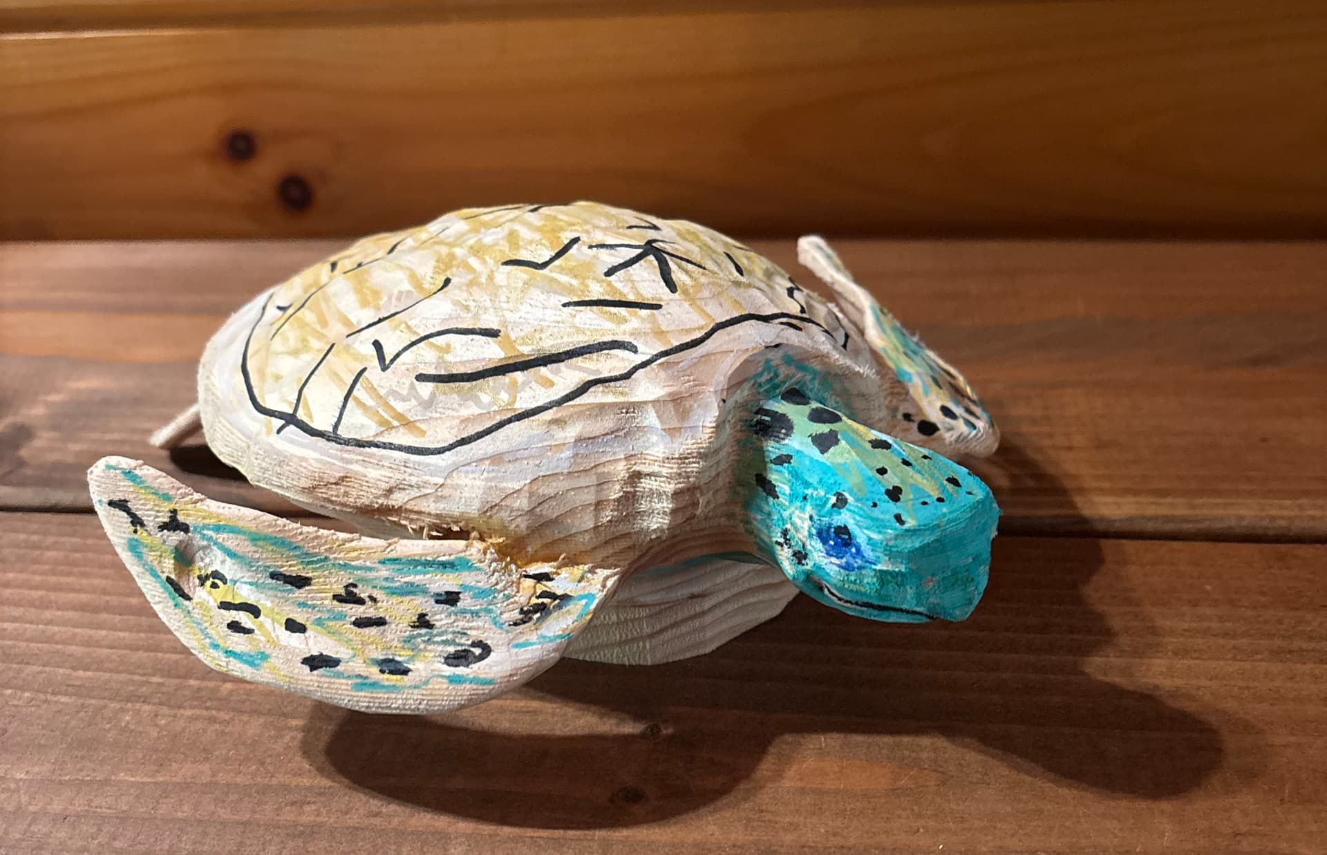

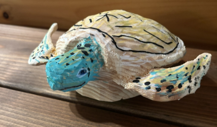

The sea turtle model 3d model was downloaded from SketchFab. I used Blender to convert it to STL (binary) format. I scaled the model once inside the design software.
Here is the painted Sea Turtle. She loves it.
