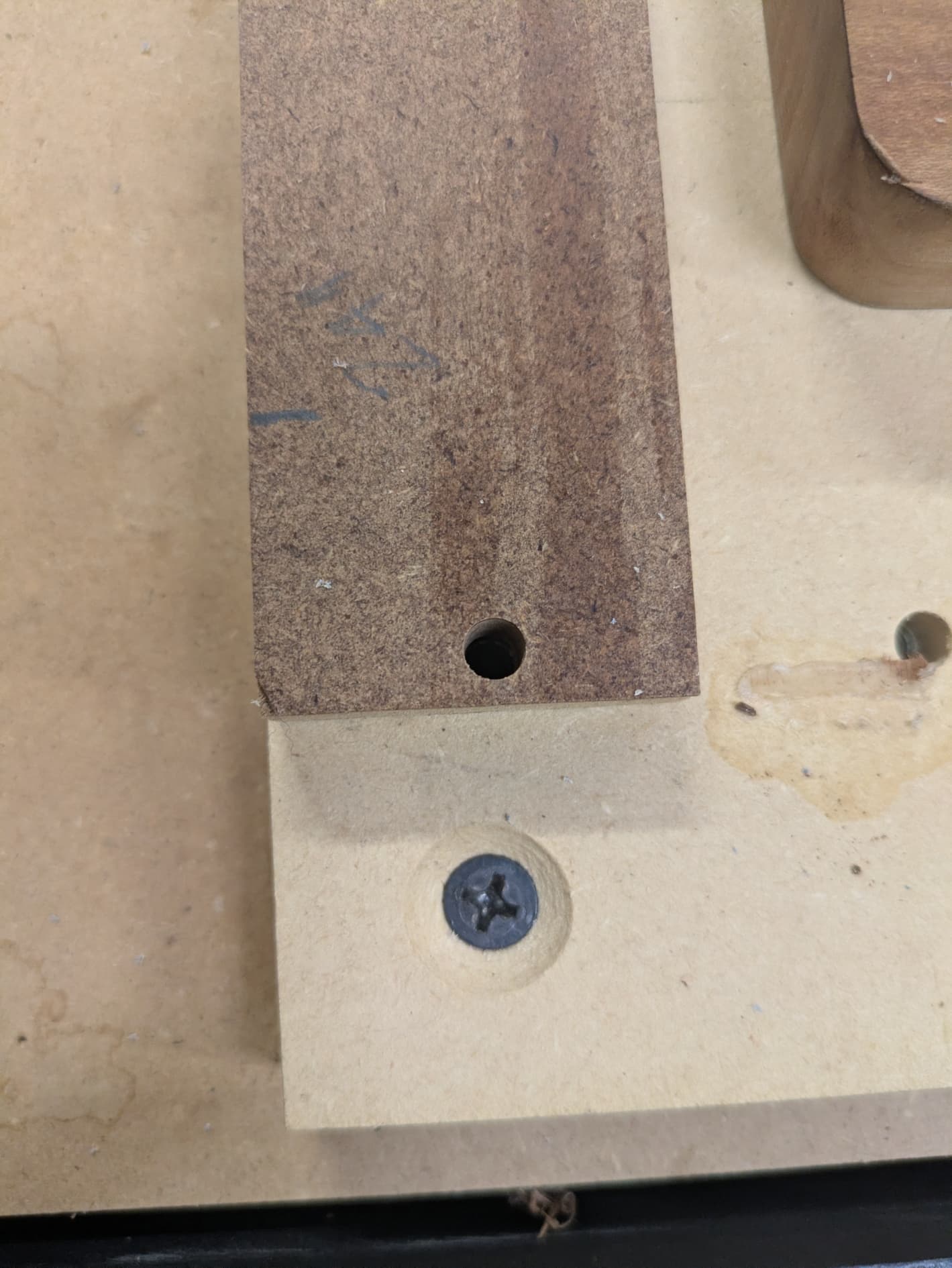

I have an SO3 and my spoilboard is MDF with 1/4-20 tee nuts. The corners of my spoilboard are countersunk and under on the factory MDF spoilboard are brass threaded inserts. I have counter sunk the holes enough to last the lifetime of the MDF spoilboard and not hit the heads. I used flat head screws.
There are 4 screws, one in each corner.
(1) If you screw into the MDF, be sure to drill pilot holes first – you need to clear out some of the MDF to make space for the screw.
(2) Counter-sink your screws deep enough that you won’t hit them while surfacing. Also, use brass screws, not steel.
(3) If you do use threaded inserts, then you can use nylon screws
