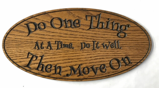

@erica I’ve added a couple of flat magnets (9mm x 3mm) to the back of many small signs made from ¼” plywood and stuck them with CA glue. I haven’t heard of any problems, but I had a heavier piece where the CA glue popped loose.
I’ve also embedded the same magnets into the top and bottom of pieces designed to fit together. I use a 0.36” pocket for a 9mm magnet which leaves about 0.003” all the way around for the glue to squeeze upwards after pressing the magnet into the pocket. I think it gives a better hold to the plated magnet.
