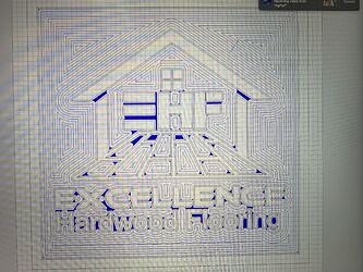

I’ve upgraded to Carbide Create 520, and this is the weirdest thing…
The issue:
  • When I create a file and send it to cut, it’ll go deeper than expected by a ton.
Steps to reproduce:
  • Create a file from importing an svg and then creating toolpaths (as you normally would, we’ve all been using our Shapeoko’s for years now.
  • I am currently working with imperial measurements (yes I know the best are Metric, diff discussion for different day :slight_smile: )
  • I use an advanced v-carve with 1/4’’ pocketing tool. settings:
    • Stepover: 0.125
    • Depth per pass: 0.063
    • Plunge rate: 8.0
    • Feed Rate: 55.0
    • RPM: 18000
  • The V tool settings:
    • Stepover: 0.008
    • Plunge rate: 12
    • Feed Rate: 55.0
    • RPM: 18000
  • Advance V-Carve settings:
    • Starting Depth: 0.000 in
    • Max Depth: 0.125 in
Actual result:
I recorded the result and uploaded it to a private listing for YouTube, so you can check the video out here, it’s about 15 minutes long so you can skip to the end to see the terrible result here
Cut will start at 0.125’’ instead of the 0.063’’ set in the program. Then it’ll just cut whatever it wants to cut because it goes off script. I’m going to try and attach video / image!

gotcha thank you, I do not mean to start all over with my mills and collets, I did get the collets for 1/4 and 1/8 shanks and I think that should be sufficient. I tried a simple v groove + contour cut and it all seemed to work :slight_smile: Made the file purely with metric measurements and it went well. Now I’m having some issues with advanced v-carving where it does the clearning correctly, but the v-part of the cut just moves to the origin and starts cutting from there… this is what I was talking about when I upgrade carbide create versions issues like these happen
post your file here and someone will help you figure out what is going on. I suspect that you have not selected the correct post processor. For advanced vcarve to work you must pick Shapeoko for a post processor. The generic gcode and GBRL do not support tool changes and would just sit there.

So I tried the same exact file on CM for Pi, and it worked as expected… I was initially trying to run the file in CNCJS but now I see there might be some issues there… so I’ve gotten rid of my CNCJS pi, and replaced it for regular debian + cm on it.
Had a successful piece! So I’m a happy camper now.
