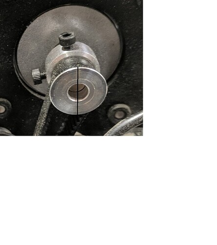

There are two possible issues to look at. First is your setup does it match where the machine is cutting. Sometimes we think we have set one position but really set another. The second would be possibly a loose v-wheel or other obstruction causing the SO3 to miss steps. Things like a drag chain, dust collection hose or the stepper motor pulleys are loose. Each stepper motor on an SO3 has two set screws. One of the set screws is positioned over a flat on the stepper motor. Some people have the stepper motor pulleys come loose and the SO3 moves randomly. If you have check your pullyes put a black magic marker across the end of the pulley over the center of the stepper motor shaft. That gives you a quick visual reference if a pulley has come loose.
