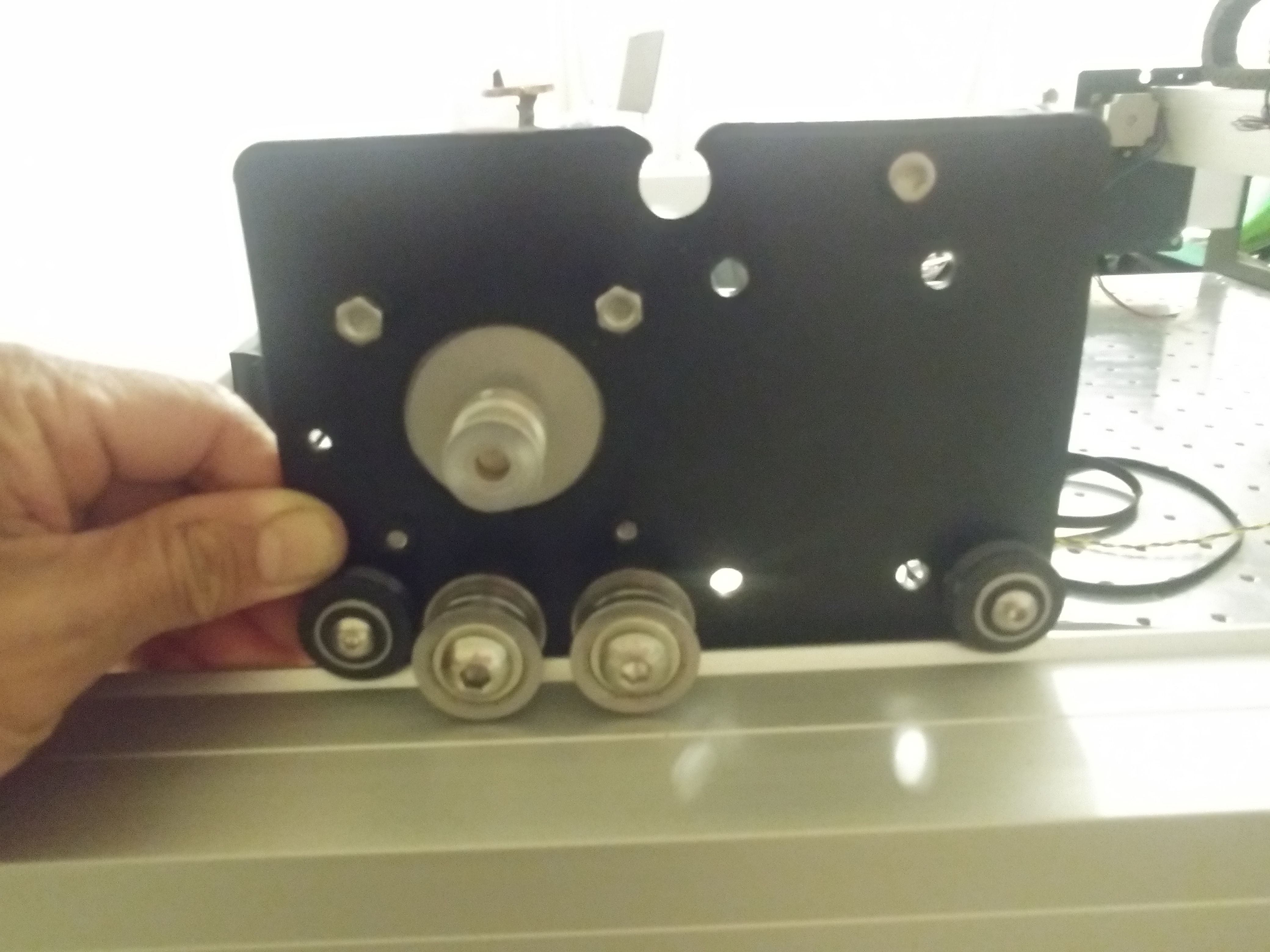

Eccentric Nut Initial Setting
It is recommended to set the eccentric nuts before placing the carriage on the rails
Set the eccentric nut such that the eccentric nut position the V-wheel futher apart (Y right/left or X axis) or closer together (Z axis). The objective is to obtain a loose fit when the carriage is on the rails.
Placed the carriage on the rail with the top V-wheels resting on the rail’s V-guide.
Install the both lower V-wheels. It is important that the flat washer is between the V-wheel bearing and the carriage plate. The purpose for the flat washer is to compress only on the inner bearing wall and not the outer bearing wall. Hence the hex bolt head compressing on the inner bearing wall.
Verify that both lower V-wheels are position on the bottom rail’s V-guide.
Snug the hex bolt but do not tighten.

Lift up on either corner of the carriage and take note of the up and down play.
Adjust the eccentric nut “Equally” and in small increments such that there is no up and down play.
With both hands on each upper corners of the carriage plate, moving in opposite up and down direction, feel for any play. The objective is to creep up in adjustment by rotating the eccentric nut thus removing any play.
The pix only shows me using one hand. That’s because my other hand is taking the pix. Using both hands in on opposite corners/ends give you the added leverage as you rock the carriage up and down feeling for that minute amount of play.
ALWAYS verify that the hex bolt is snug during each adjustment of the eccentric nut.
Additional upward and downward force will reveal the play/gap between the V-wheel and V-guide.
Tighten the V-wheel hex bolt. Note that by tightenning the hex bolt the adjustment will change to tighter or loose fit. Verify for any up and down play on both corners.
With your fingers in this position, move the carriage plate back and forth. Feel for any lateral play. Do the same for the opposite end. There should be none. If there is, check and see if the hex bolt is tightened. Also check if there is up and down play. Adjust as necessary.
This pressure, back and forth seats the V-wheel onto the V-guides and checks for additional minute play. I discovered this verification check by accident when I noticed a bump while traversing the carriage along the rails. When I applied this back and forth motion I noted additional play. Readjusted both V-wheels and the bump went away.
