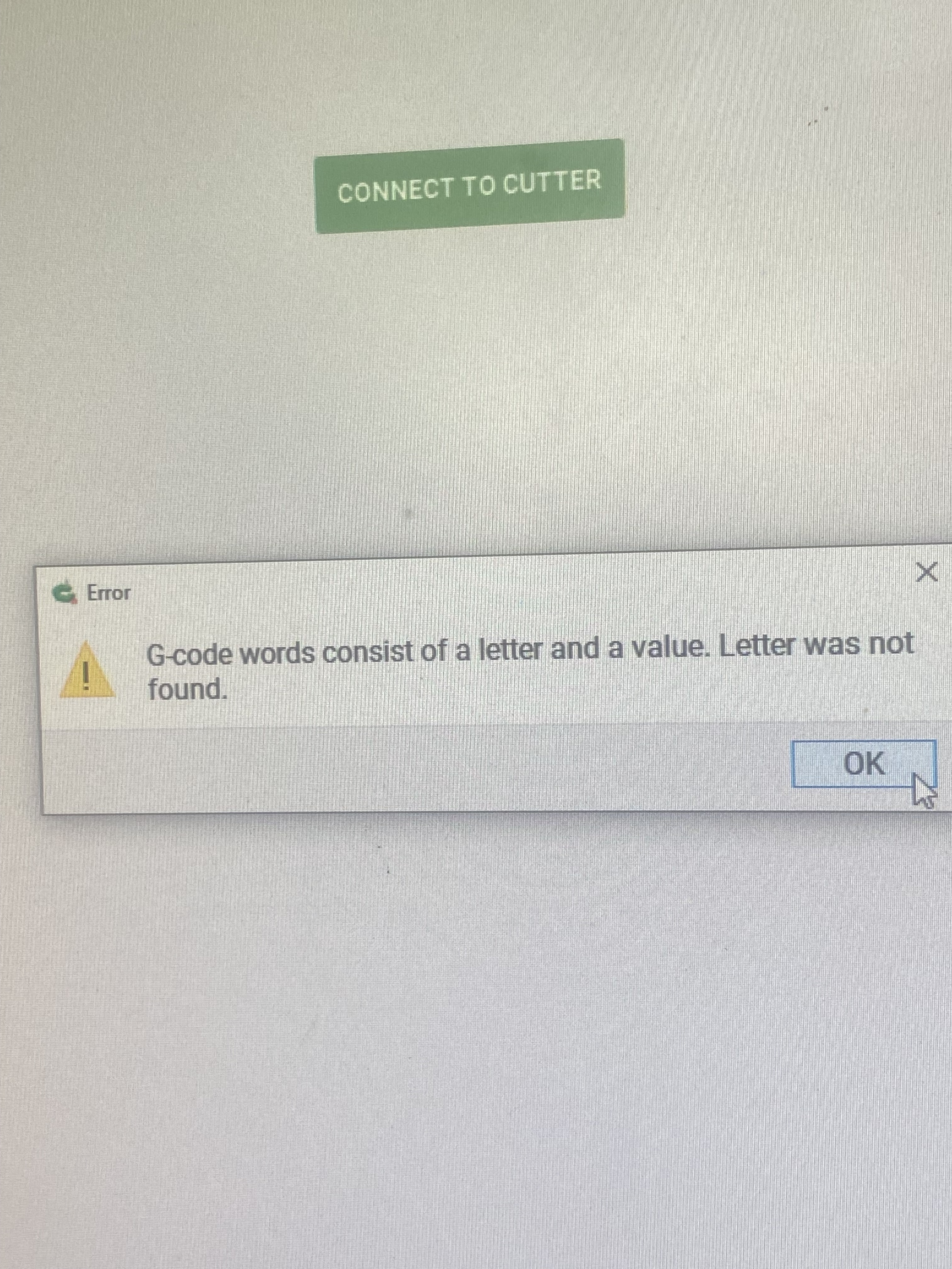

I’ve tried 582 622 640 644
I’m getting this now with the beta version
That’s something which you should look into with the folks on support.
