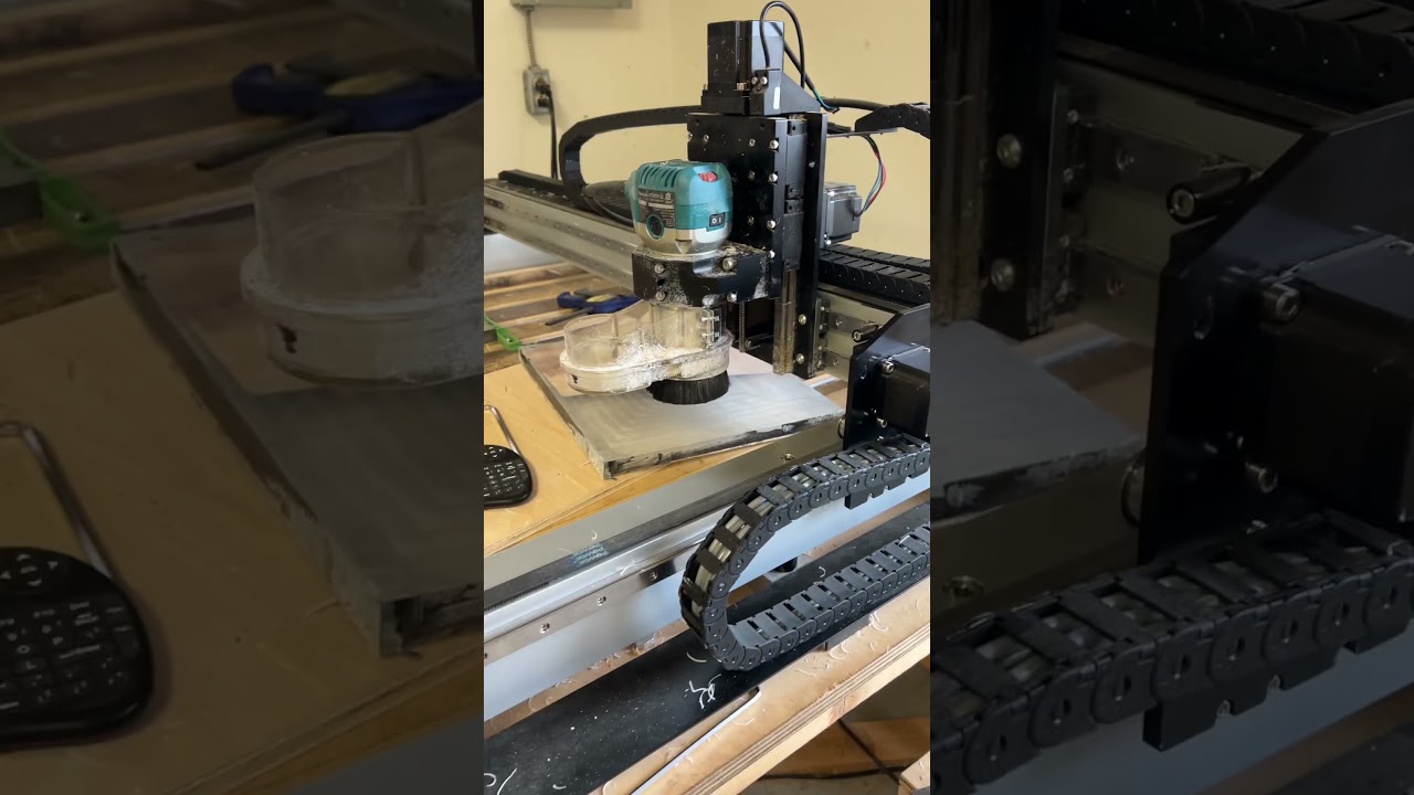

Using MDI and sending home command, sometime it goes to the correct location(side bar I am getting a Y limit error), other times it goes back left or front right. I used it a few times last night with zero issues. I have had it for about 4 months.
Y limit switch LED light lights up when metal is near it, but if I get the gantry to go to the proper home, it gives me a Y limit error. Light is lit up while it is giving me the error. Sorry for 2 problems in one post. I have emailed support, but I figured I would reach out to the hive mind as well. Thanks in advance.

Send photos of all your wiring and connectors, esp. the logos on them and a video showing the homing in the wrong direction.

I can send you photos of the connectors, but I just didn’t just set this up. It has been running for months. So unless someone came into my shop overnight and switched connectors, I doubt it is that.
Emailed it to support, but here it is as well
It’s possible for connectors to develop problems over time. For example, even the tiniest amount of corrosion in the wrong spot could make one of the wires in the connector an intermittent connection.
Something to check is if any part of any connector is discolored. That can indicate arcing, and if so is a sure sign of a bad connection.
