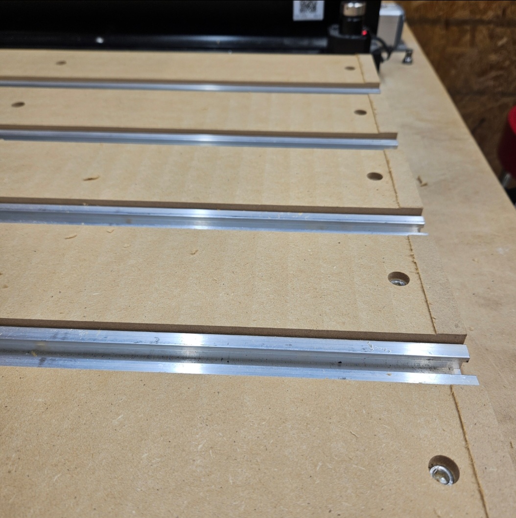

I wrote my own program to resurface my Shapeoko 4x2. I was using a 3/4" diameter cutter. I measured my exact spoilboard size and allowed slightly more to clear. I set my zero with a Vee bit to ensure I had the zero correct. I moved my machine to the front left position and found out that I ran out of travel. This left a ridge of unsurfaced material about 1/2 inch the entire width of the table.
So my question is if that normal or is there a way to resurface that area as well?

I was thinking more on this. I don’t think is a program question.
I jog forward on the Y axis as far as it will go to zero but its still short about 1/2" from the edge. The ridge that remains is all the way along the front X axis edge.
Post a photo?

I’ve added a picture of the ridge left behind but today I have come across another issue and I don’t know if it’s related. I tried to run “Indiana 5” attached and the text with a vee bit plunged .75" rather than the .06 that I have set. I tried to compare this one to the Flag file I attached which ran perfectly.
So what am I missing? It’s too hot to keep screwing up.
