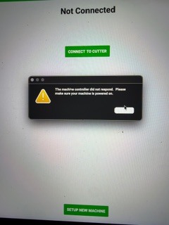

Shapeoko 5.1 Pro doesn’t turn on
Might be regretting this machine. If it’s not one thing, it’s another. Now the machine won’t turn on.

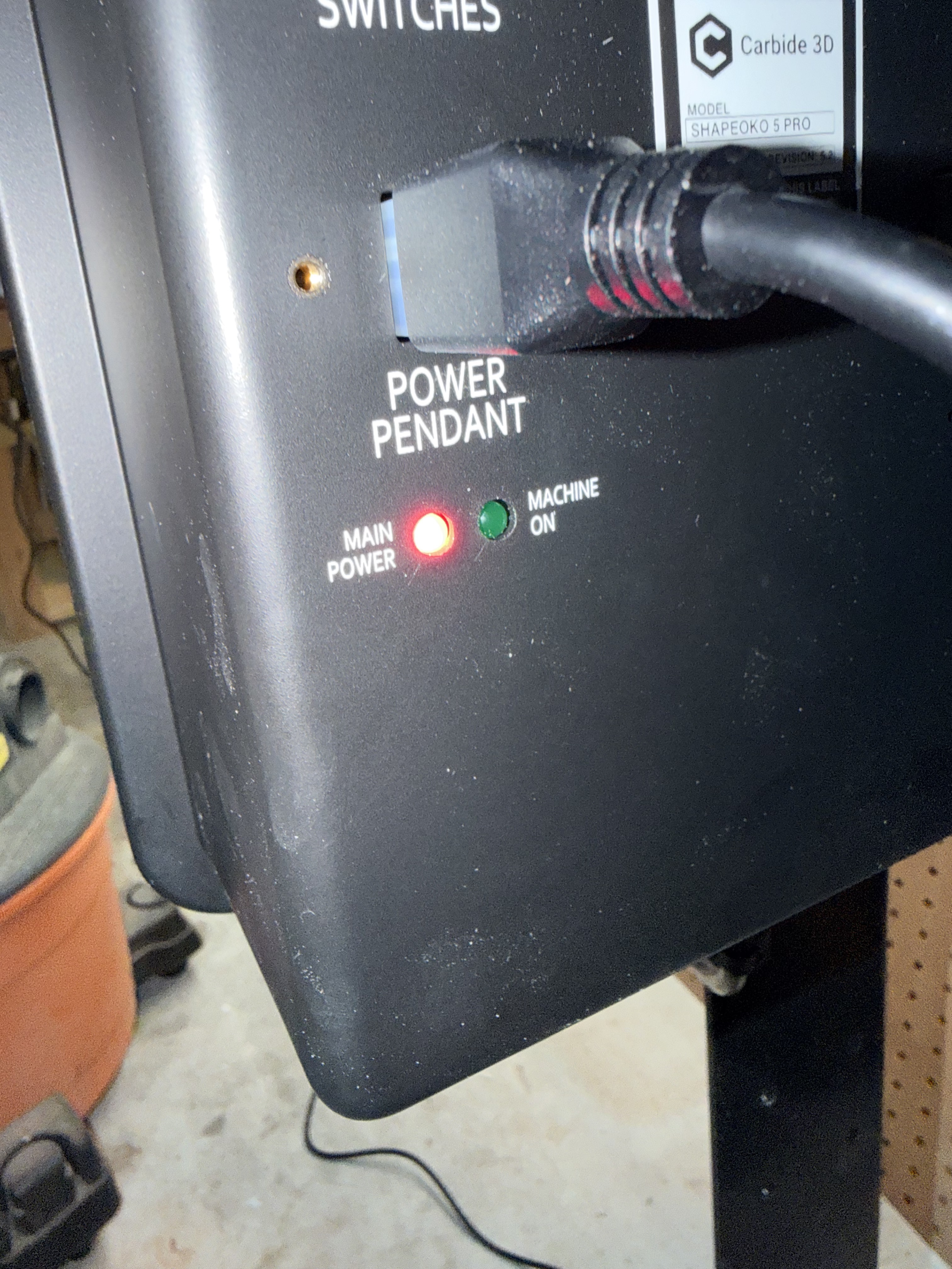

Is the E-stop pendant pushed in?
See that you have a ticket already, we’ll have someone contact you as soon as we can Chicago–California business hours tomorrow.
The E-stop is not on, and it’s connected properly.
It’s a twist knob to release. I brush by mine from time to time and have to reset.
If the machine is brand new the knob needs to be released.

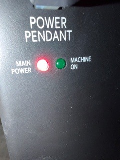

any results i currently have same issue waiting on support to open
Our E Stop pendant was replaced.

It wasn’t the pendent. It’s doing it again with the replaced pendant.
