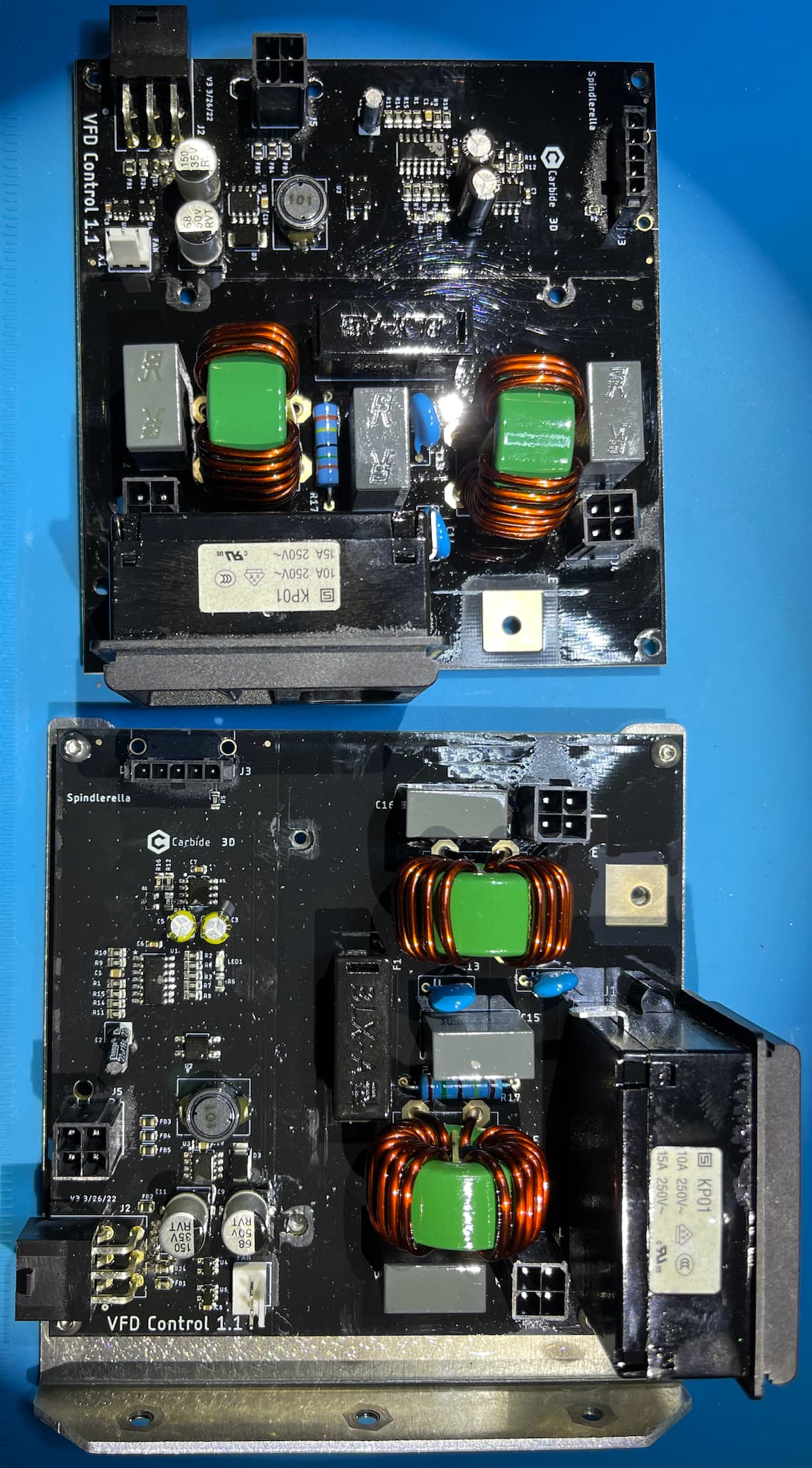

Received another VFD Controller 1.1 board today. There is no continuity between the black pin of the 6 connector molex input and chassis. Identical to the original controller board. If that is the definitive test for defect, then I received a 2nd bad board.
Only continuity to chassis is from the internal SK-W1 red lead connecting controller board to the larger VFD driver box.

Brand new SO5 and VFD. Received notice replacement SO5 shipping today. Received the VFD replacement controller 1.1 today and by all appearances it is also crap (signs of repair / modification). Support doesn’t respond (emails / phone calls). Feeling like I might have made a bad decision with this purchase.
I wouldn’t mind a delayed response, as long as it was informed / straight forward. Support (Oscar) can’t advise if a “good” VFD should have continuity between black control control pin and chassis, so I have to assume I received a 2nd bad board. :rage:

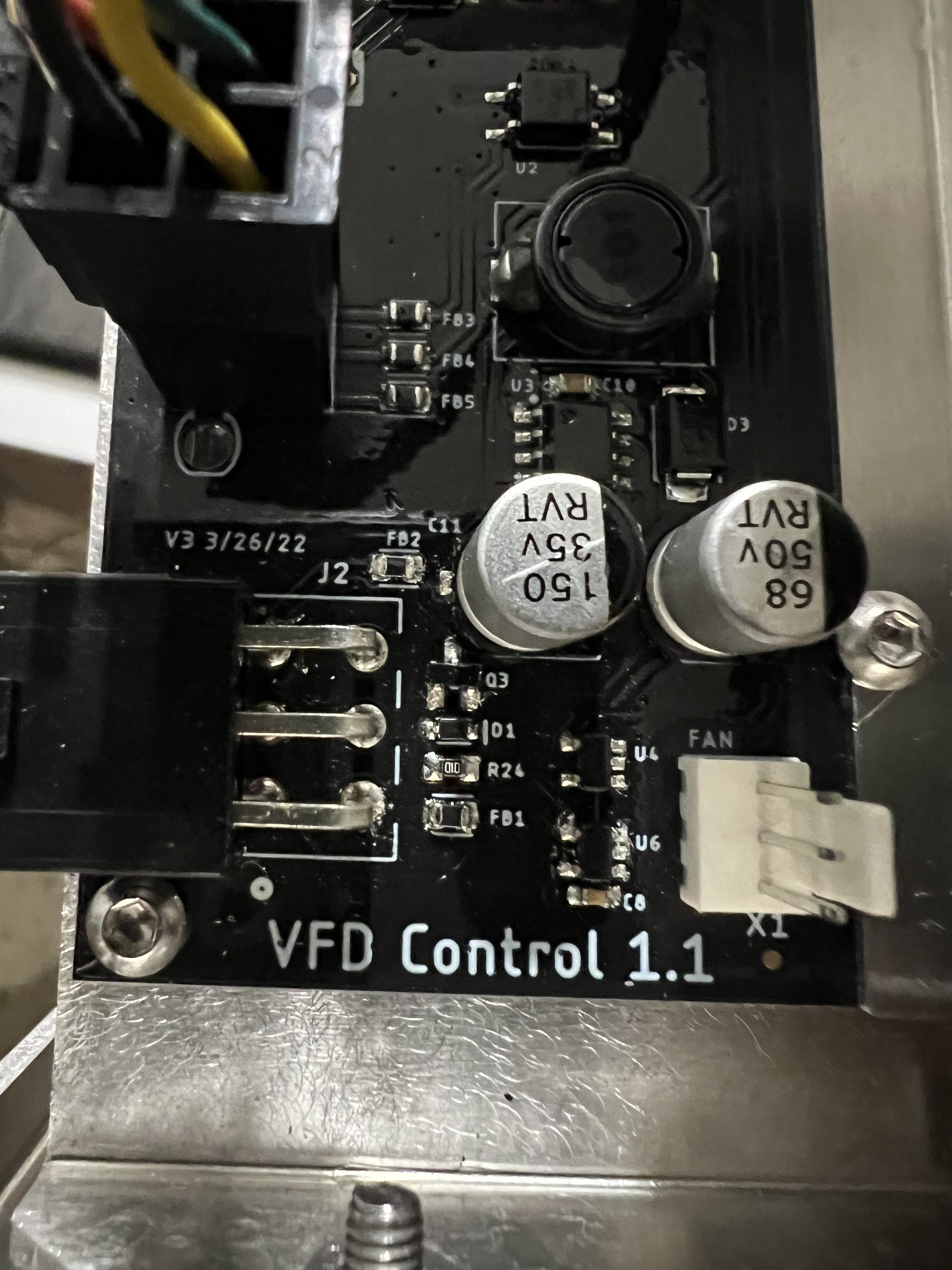

The red lead for me on SK-W1 goes to VF1 inside of the VFD box which is the control signal pin and should not have low resistance to ground. The black wire on SK-W1 is ground and does have low resistance to chassis. I also have a 1.1 board but I still have the transistor occupying Q3’s spot instead of the having the base and collector shorted so there are some differences between my board and yours.
For me, my VFD box low power side gets grounded to chassis from this specific screw. I am not entirely sure if this was done on purpose or if somebody forgot to exclude ground pour next to the mounting screws.
Thanks for the feedback. I just rechecked board and in both of my boards the epoxy coating has preventing the frame screws from establishing ground circuit. With a test probe I can see that ground is in fact under the epoxy… All PCB screw holes have ground under the epoxy when tested.

Envious of your pristine VFD controller… My 2 thus far are, well…
Incidentally, here’s my before (with frame) and after boards in full context…

The more I look at this I am pretty sure it is actually a LDO occupying Q3’s spot on my board. Or at least that would make more sense with the way the traces are connected.
