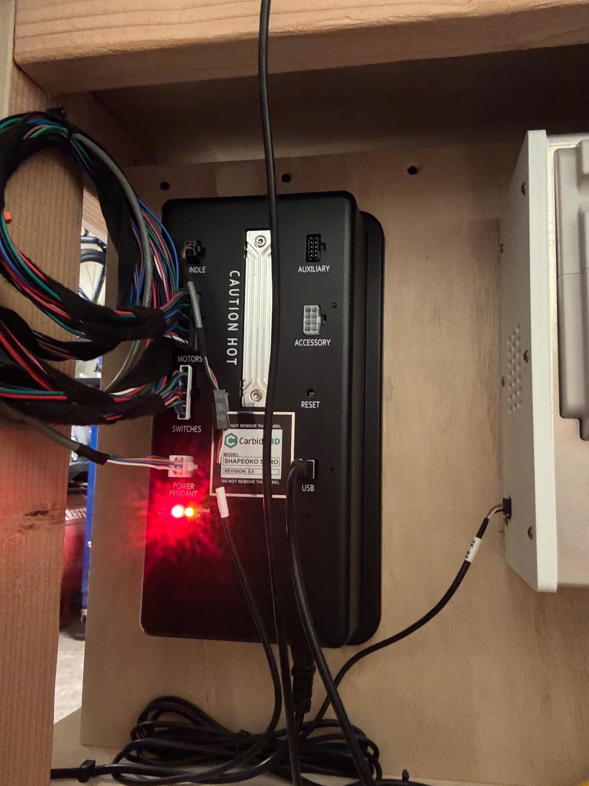

Hello everyone,
First time poster here in the forum! Pleased to talk with you all.
So, I am looking for information/suggestions on how I can get my computer to detect the Shapoeko 5Pro… I have tried a multitude of different things from swapping the controller, ferrite core USB cable, new EMO switch, swapping computers and redownloading the software. All without any success.

First up — is the SO5 Pro itself reliably getting power and staying powered up?
When connecting the computer to the machine, how is the USB cable arranged? I like to set it up so that there are weights at each end holding it unmoving, and have a coil from there to the connection so that the connector is being pushed in to the connection with a bit of tension. Post a photo?
If you are losing the connection while cutting, please try an “air cut” where you run a job which has disconnected w/o the vacuum or spindle on (and no stock in place) — let us know what happens.
Please also post an overall photo of your setup.

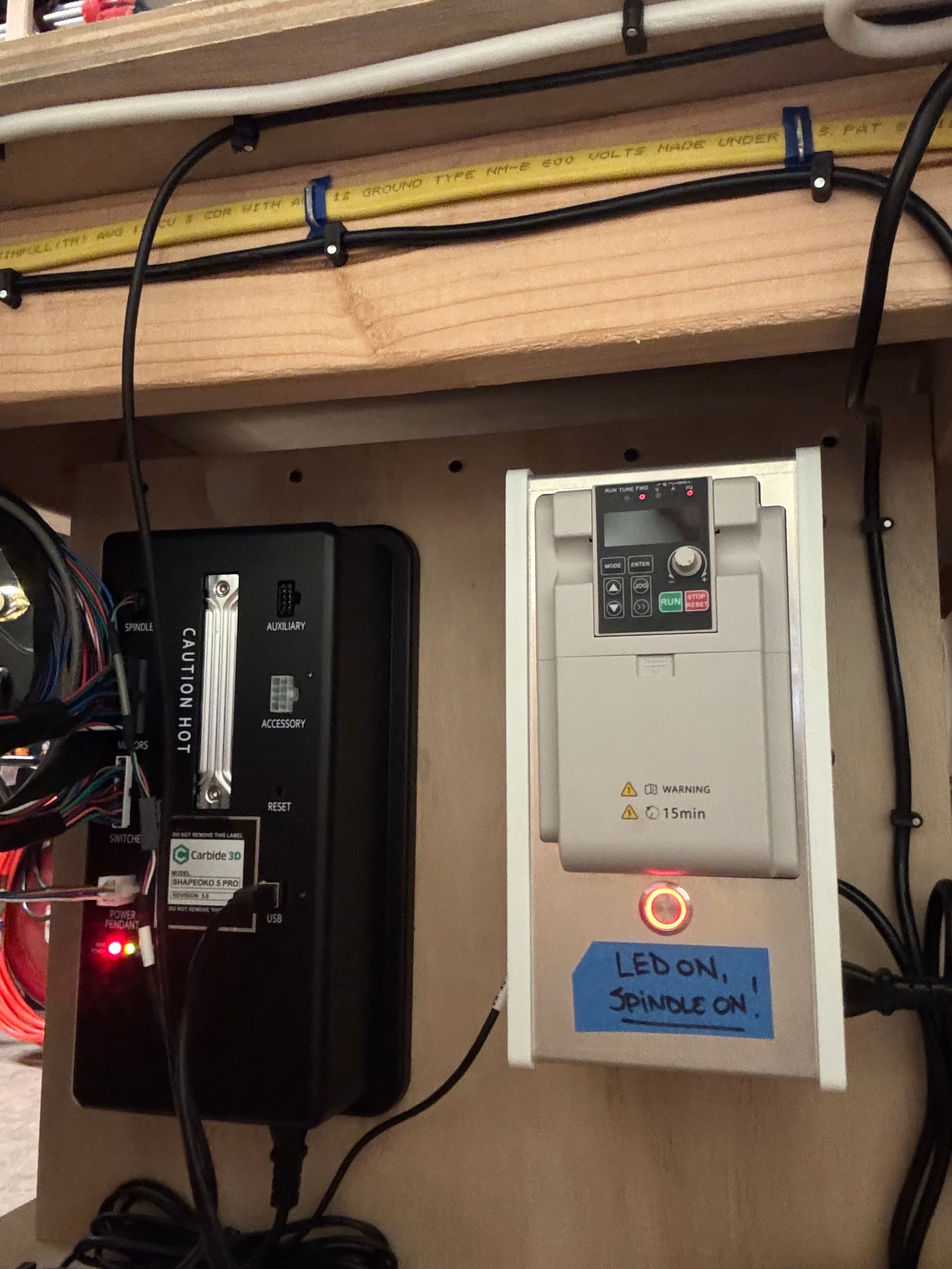

A few images of the system are shown below… I hope that they have come through.
I built a table for the unit and have secured the connections as you see.
The machine is powered on in a reliable manner as the EMO (red twist button) turns the system on in a distinct manner. I should mention that the replacement controller I purchased was working for a short period of time until it lost comms mid way through a project.

When the USB is connected, you should hear a bit of noise from the Controller for a short time (2 seconds). My PC USB connection is usually my problem.
The noise will happened during PC bootup before the OS comes up ( hardware handshake ).
I expect to see 0.0 on the Spindle display when not running but ready.
