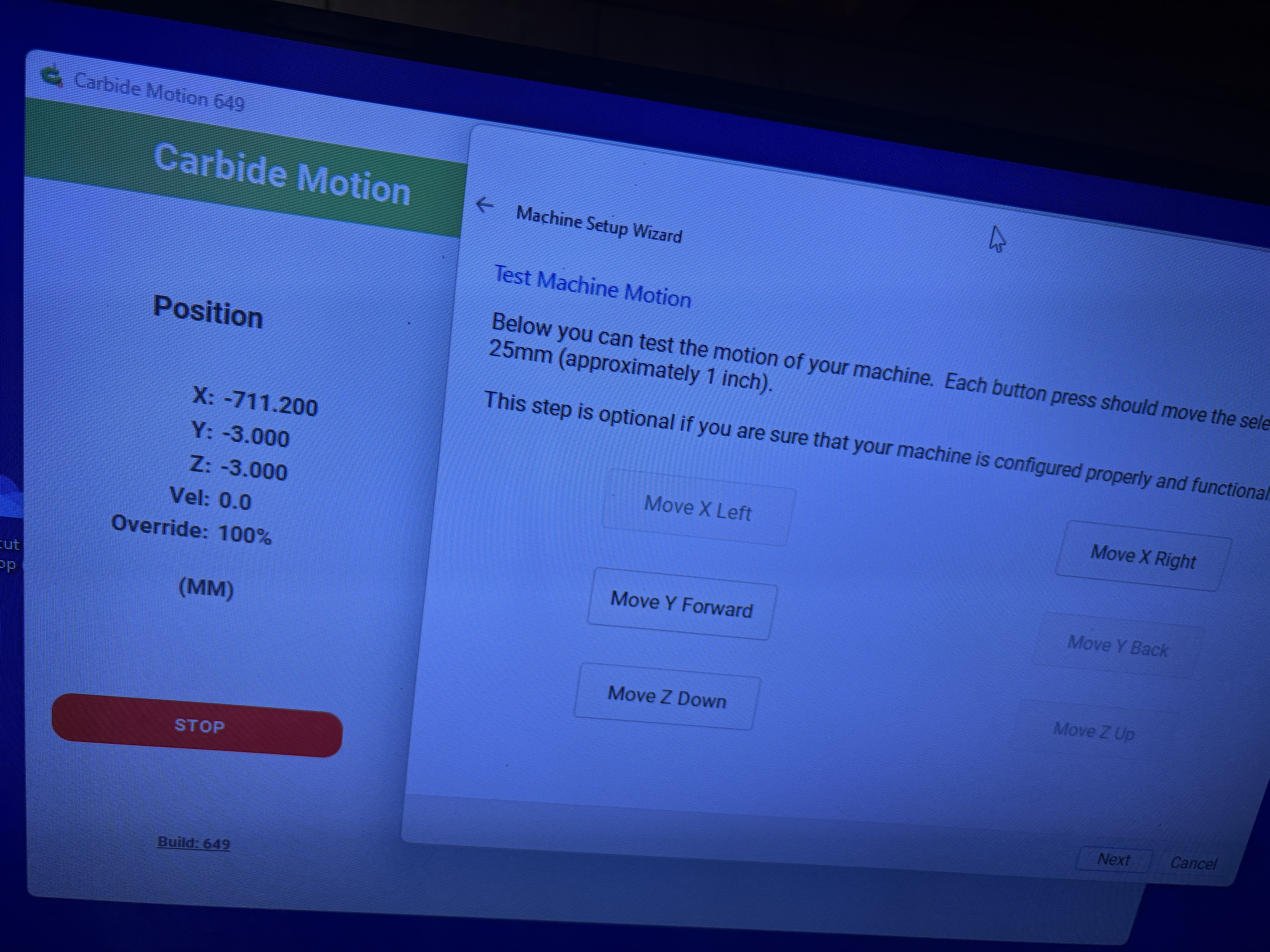

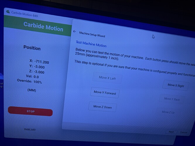

I have been running my S4XXL with UGS. Previously I was able to switch between UGS and Carbide Motion but for some reason, now I cannot get CM to function properly. I have tried going through the entire setup new machine process and I have tried deleting the files in the directory and try setup again. But no matter what I try, the first time I initialize after the setup process, CM sends the gantry -X further than X can go. The thing initializes as it should no problem. Also, during setup if I use the test motion during setup, it will move 300 and some mm instead of 25mm. What am I missing here?

Thanks WillAdams, unfortunately that didn’t change anything. I can run it on UGS just fine but not on CM. Every time after the initializing and CM sends the machine to front it sends it too far and every time I test movement during setup it moves 300 plus mm instead of 25. I can command X to move 5mm in MDI and it seems to move 5mm.
Which size machine do you have? Which did you configure for?
It might be that either adjusting the position of the homing switch or calibrating for belt stretch will adjust this:
After selecting move left once, it moves this far.
Configured for XXL and I have XXL. Also used MDI in CM to move the 5mm

9 HOURS LATER…Finally fixed it!!! $N0=G20. Yep. found my log sheet. SMH I changed it about a year ago to help my son out while using UGS.
