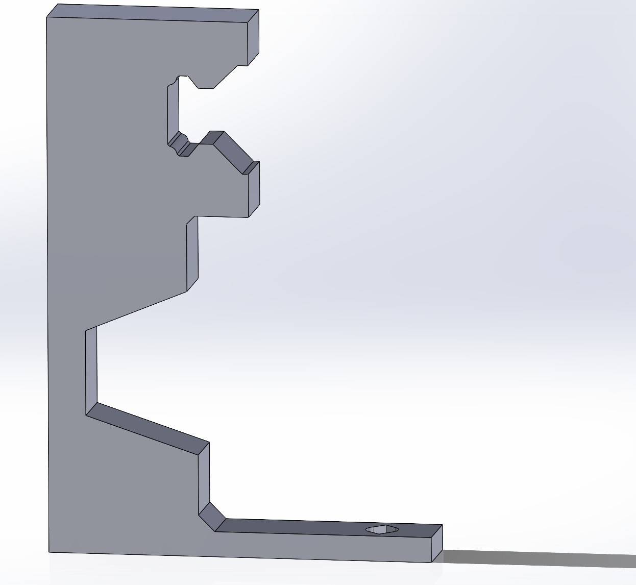

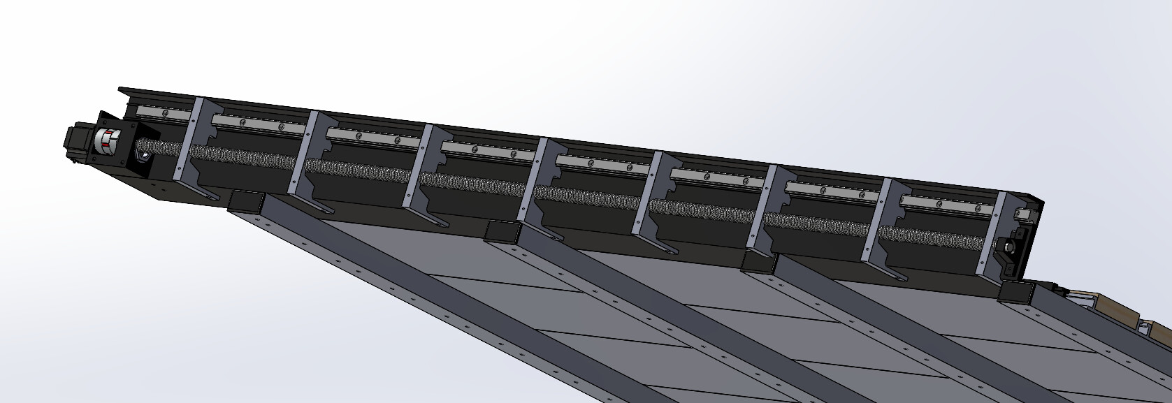

Hey folks I wanted to protect my y axis ballscrew while I’m moving and I thought I’d share what I came up with. the pilot holes on the back are for #8 wood screws to attach a PVC board or something to keep the ballscrews from being bent during transport. To attach remove either of the front plates, unscrew the hybrid table slats and slide onto the linear rail. It should have clearance for the ballscrew mount and m6 screwheads
It’s tight enough as well it should retain the X axis gantry mounting plates which should be moved to the back of the machine.
