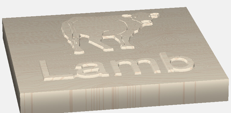

I am trying to make a sign with a raised letter name and 2.5 d pic of a show lamb. trying for hours and online videos never answer the specific questions I have. Can I take a pic of one, converter it to greyscale and send it to carbide create? Am I wasting my time? Do I need to pay for an image to 2.5 d it into the sign? I.E. fkn lost on this one. Want height of lamb to be height of letters for name. Contour the background. The laptop is about to be converted to a frisbee at this point.

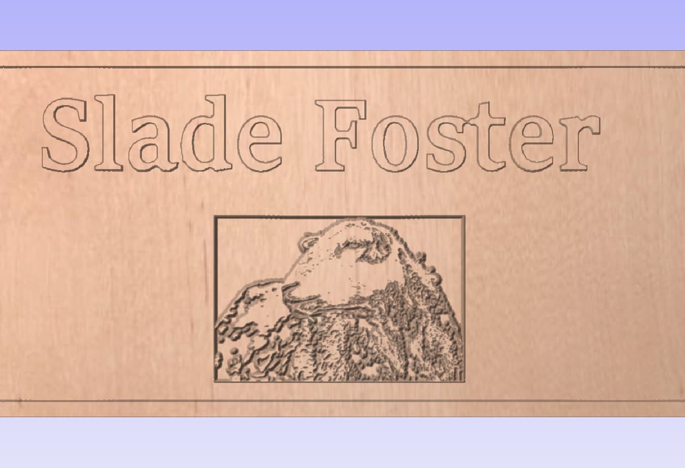

slade 6

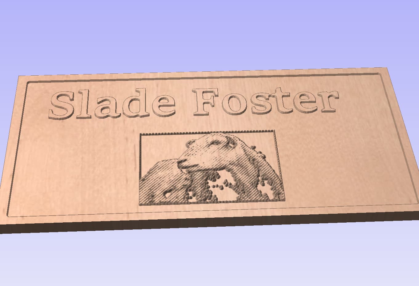

I used Vectric to do a Photo V-Carve, then did a line trace and V-carved out the remaining areas. The little square outline is very narrow and can easily be sanded off.
Better yes, interestingly now that I see that it looks less of what I am going for. This is to be a sign to put on a show stall when he goes to 4h shows and fairs. Not sure that is proper for what I want. Doesnt look like a stall sign really.

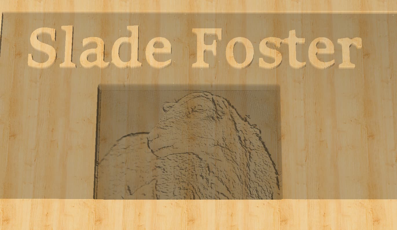

Removed Photo V-Carve
I added Multiple line traces using different threshold intensities.

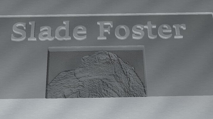

Converted the image to an STL.

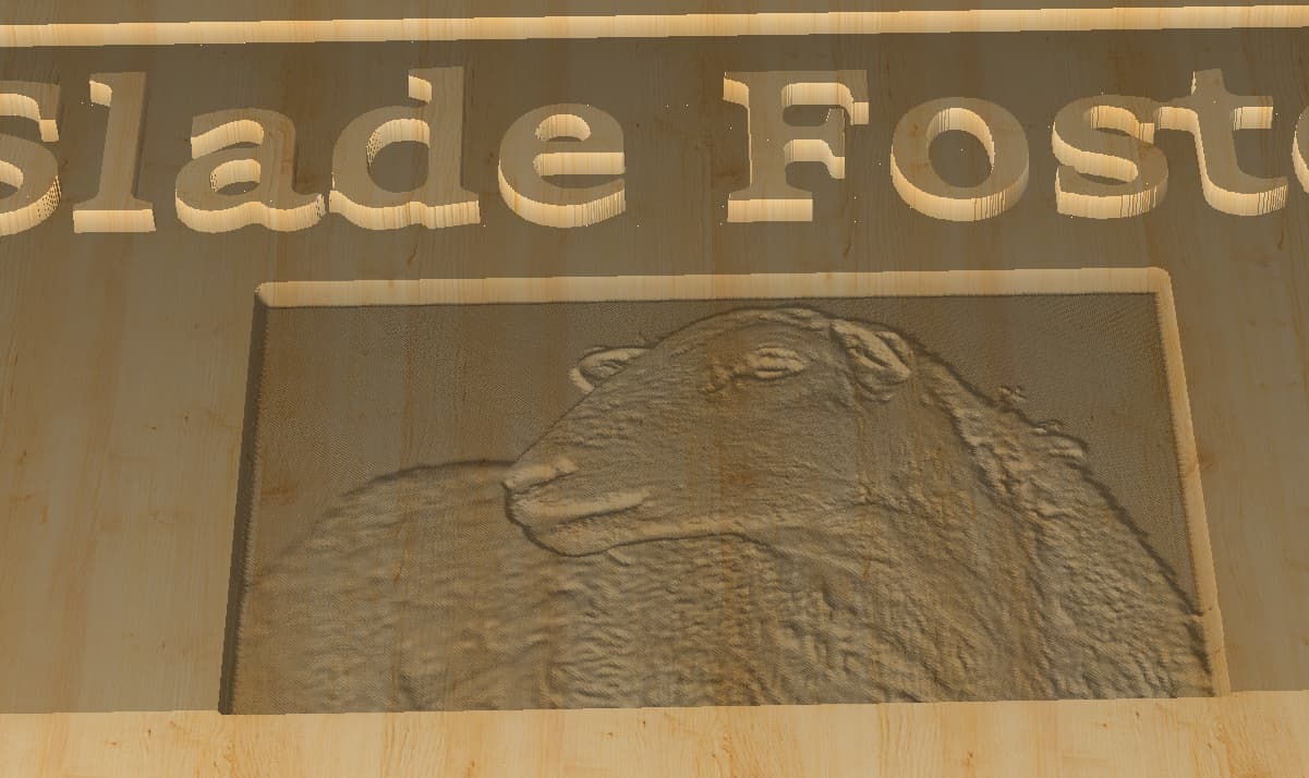

I adjusted it a little bit, and it looks better.

That looks really good. Let me ask, what tools are you showing to use? Possible i dont have the best tools for 3d?
A way to eliminate the dip in the photo and make the lamb height same as lettering?
And i did screw up, the name is Slayde that was me trying too hard too late at night
Yes. You just have to adjust the Z height in the modeling tab.
Tools are .25 EM and .125 Ball Mill
