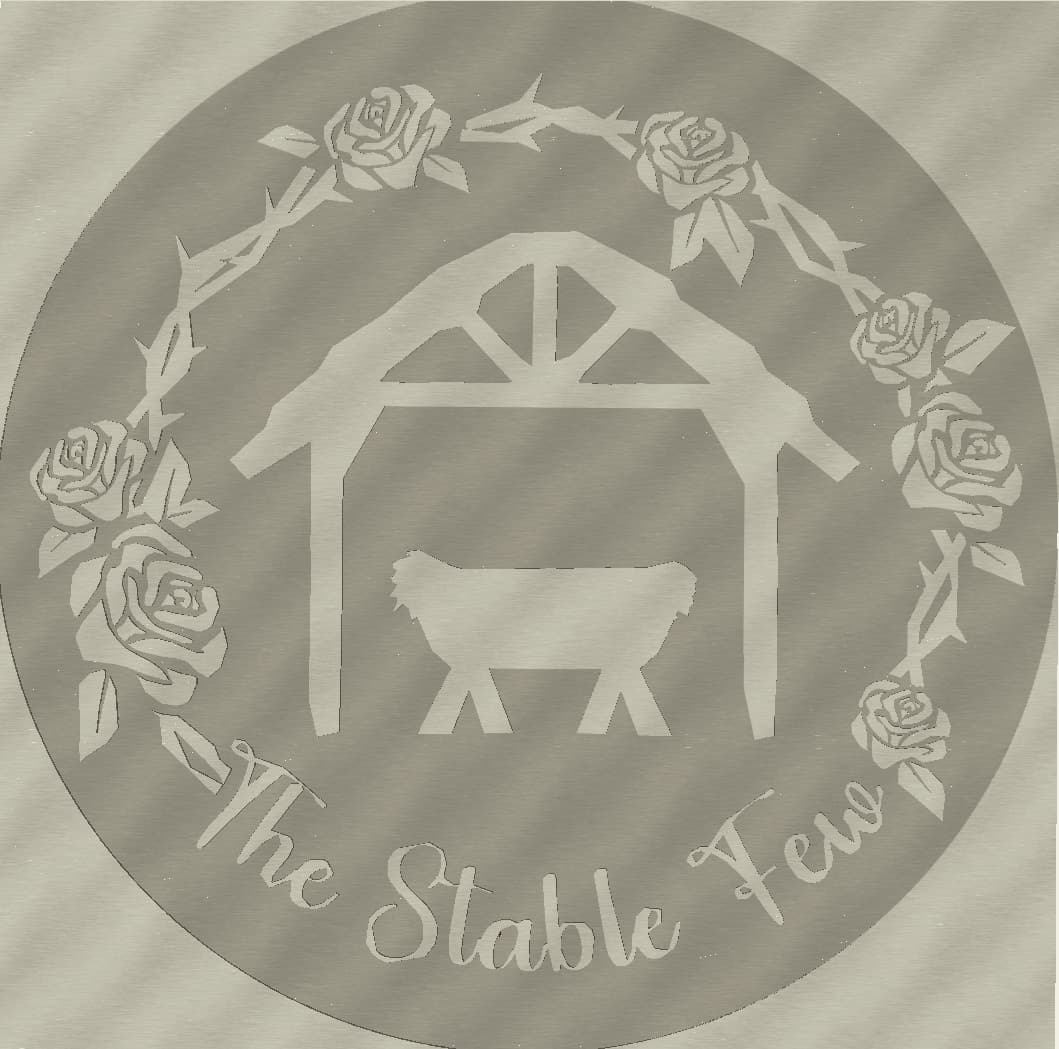

Now all that said, I tried to see how much detail a 1mm bit would provide, and it’s actually pretty good. This is not a VCarve, so no VBit, just clearing using endmills down to 1mm in size:
So, paint-then-pocket could also be a viable approach. The pocket could be very shallow, so that might reduce your cutting time.

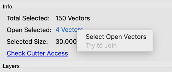

The software does warn me that there are 4 open vectors and gives me an option to select them, but I can’t seem to identify them or do anythign about it.
On to figuring that out!

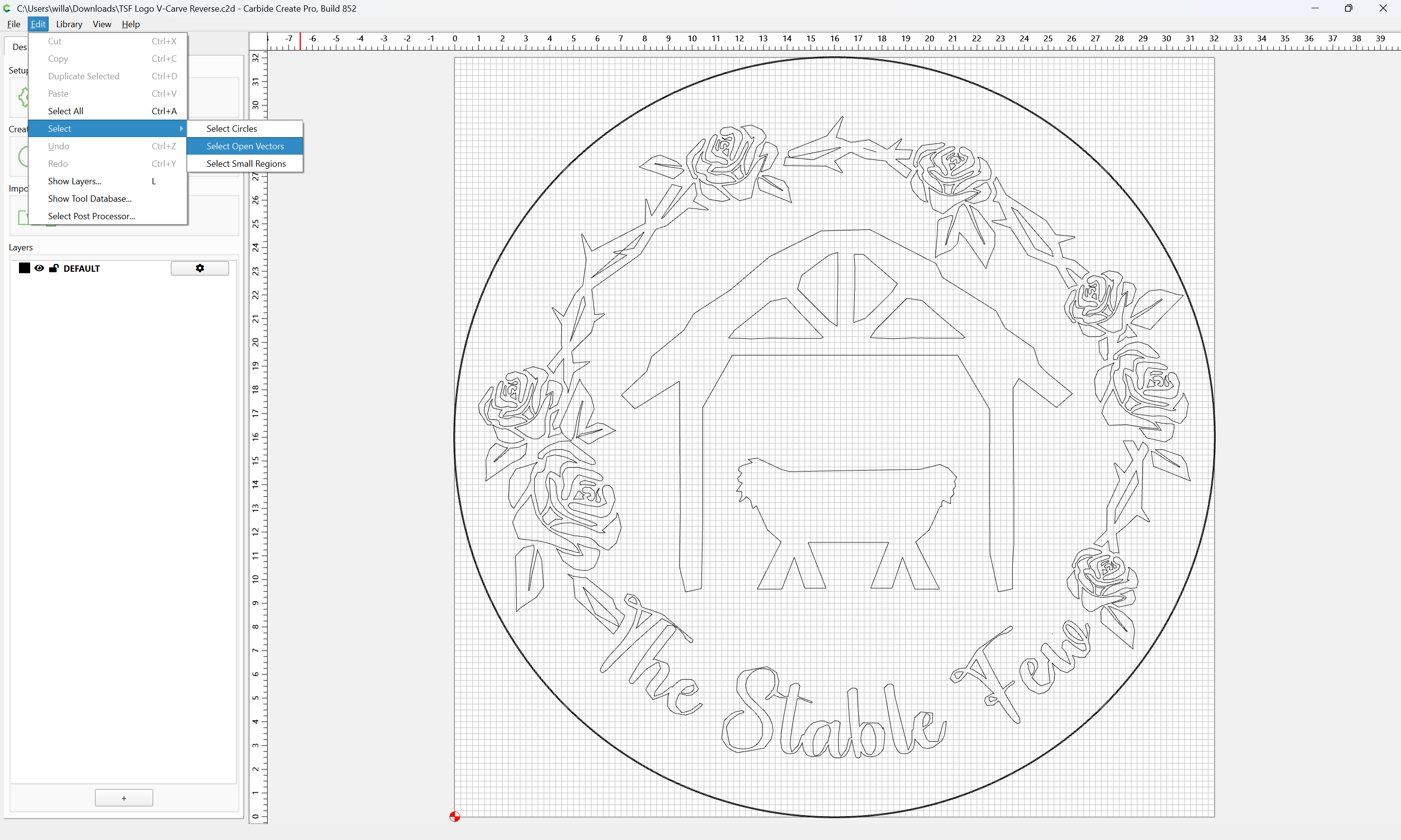

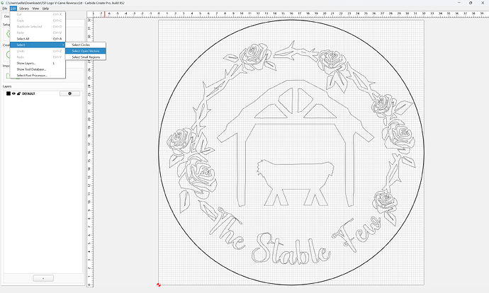

For finding the open vectors use Edit | Select | Select Open Vectors:
and as noted, you’ll want to address all instances of overlapping and self-intersecting geometry.
I was able to select the vectors and move them to another layer, but, like you, couldn’t do anything with them. I suspect they are individual nodes - I’ve seen other cases of ‘phantom nodes’. I would just select and delete them.

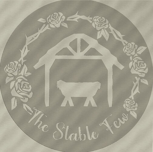

If I was creating this sign, this is how I would run it.
The Stable Few raised logo.c2d (672 KB)
Much easier to paint the surface of a raised image. Carve out the “white” with a 1/4" or 1/8" endmill, use a 30 degree vee bit to get nice sharp corners. Those who know me know I am partial to HDU. That is primarily because I know that it will stand the test of time. Wood has a tendency to age and I’ve not found an exterior clear finish that won’t need to be refinished every two or three years or so. If done like this, prime the whole sign, paint the white, then paint the raised logo. Go in with an artists brush at the end and do touch up on the white.
My 2 cents for the day :slight_smile:
Please note, the feeds and speeds are for HDU, not for wood!
I took the image of the logo you posted and traced it in Carbide Create. It came out very clean. No overlapping vectors.
