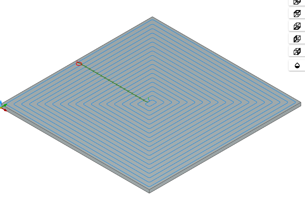

I have a Shapeoko 5 Pro that has been upgraded to a 5.1 with the upgraded base kit and leg kit. After surfacing the spoil board, I cut a part and I noticed a slight cup to the flattened spoil board - the middle is slightly lower than the edges.
The evidence is that the witness lines (I don’t know what else to call it) of cutting through the material are cut deeper into the spoil board on the outer edges than they are in the middle of the spoil board.

Which spindle do you have?
What tool was used to surface the MDF? Did you go back-to-front, side-to-side, or use a pocketing operation which worked its way in?
Photos showing the part in question? What toolpath was used for the cutout operation?
I have an 80mm spindle from PwnCNC and I used an Amana RC2251 2-1/2" spoilboard surfacing bit.
Spoilboard surfacing was done using a an offset pattern - I’ve found this lets me spot tramming issues immediately and fix it before breaking out the magical piece of granite.

How much time between resurfacing and you noticing this? What’s the humidity your shop?
Oooh, great question. Maybe a week, but I live in coastal Maine, so humidity in my shop varies between “none” and “swampy boi”.
I’m looking for recommendations on sealing the MDF after surfacing. Looks like a 1-pound cut of shellac might work, so I’ll be trying that in the near future.
After poking the machine with an old screwdriver a few times, I think the issue is either:
A) the screws came loose and the slats have some spring that coincidentally looks like something else, or
B) the moron who tightened the screws securing the slats to the base didn’t do a good enough job.
I will be tightening everything and testing this tomorrow. I bet it’s a combination of humidity and not tightening things.
