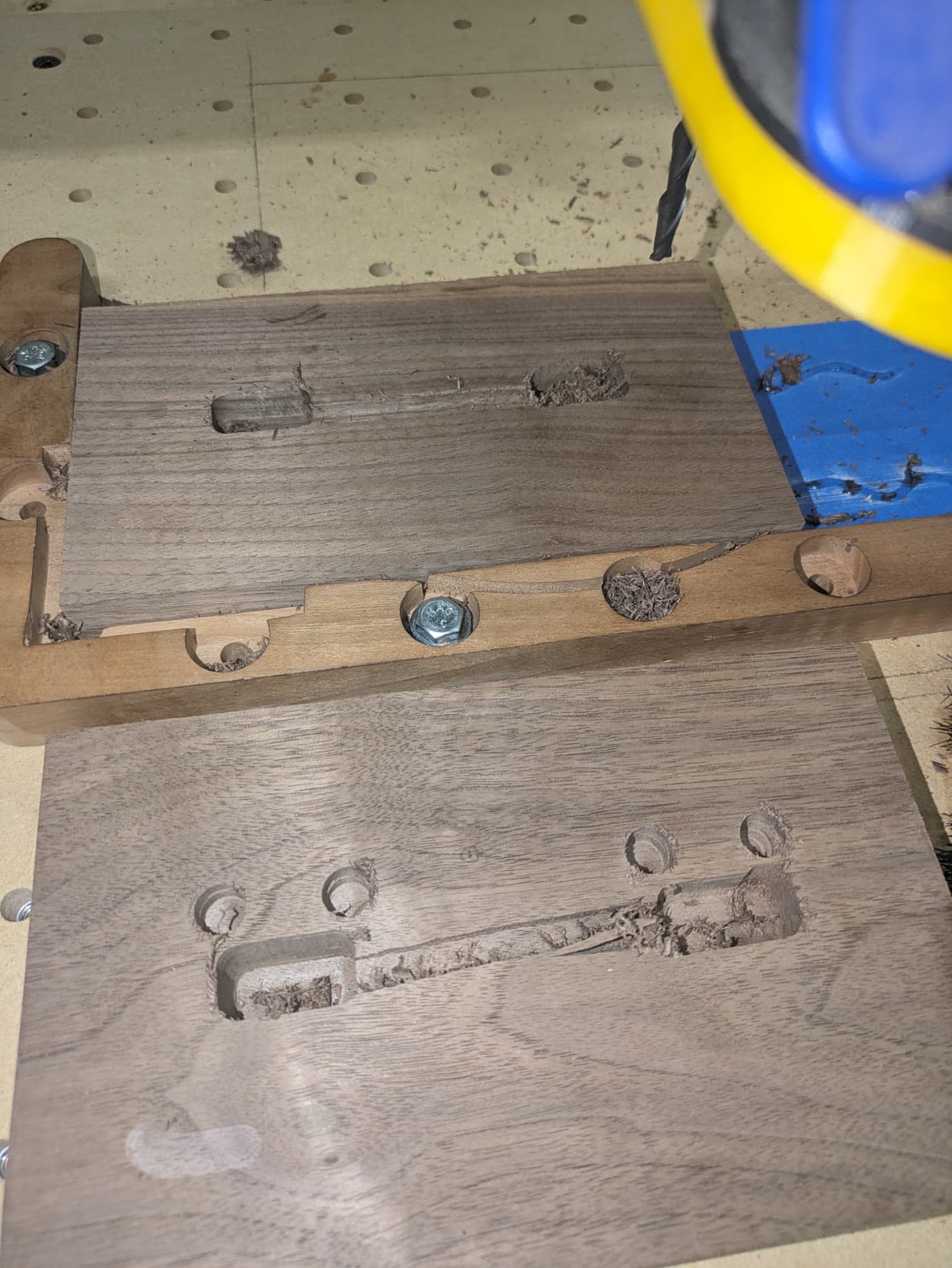

I am trying to cut a ring box out of walnut. I had made two previous versions and everything worked well but I needed to make some changes to the holes for the barrel hinges. The problem is twice the machine did not retract high enough and cut across the material.

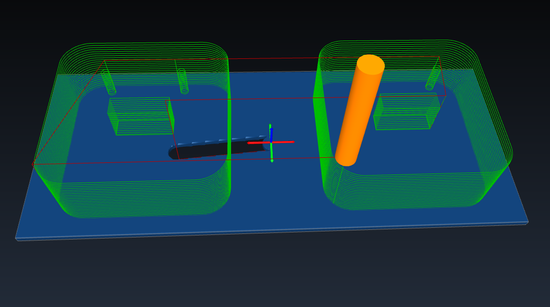

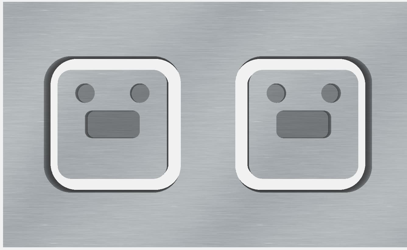

Here is the CC simulation and the Cambotics simulation
Here is the c2d file:

I have never had this happen before. I can only speculate the machine lost Z steps. I did do a lubrication of the top bearings and lubricated the rails of my HDZ. I will jog up and down to see if that helps.
Please take a look at my file. In the first one I had a retract height of .15" and changed it to .2" for the second one. I do not see anything unusual about the file and have cut this same file with some modifications twice before.

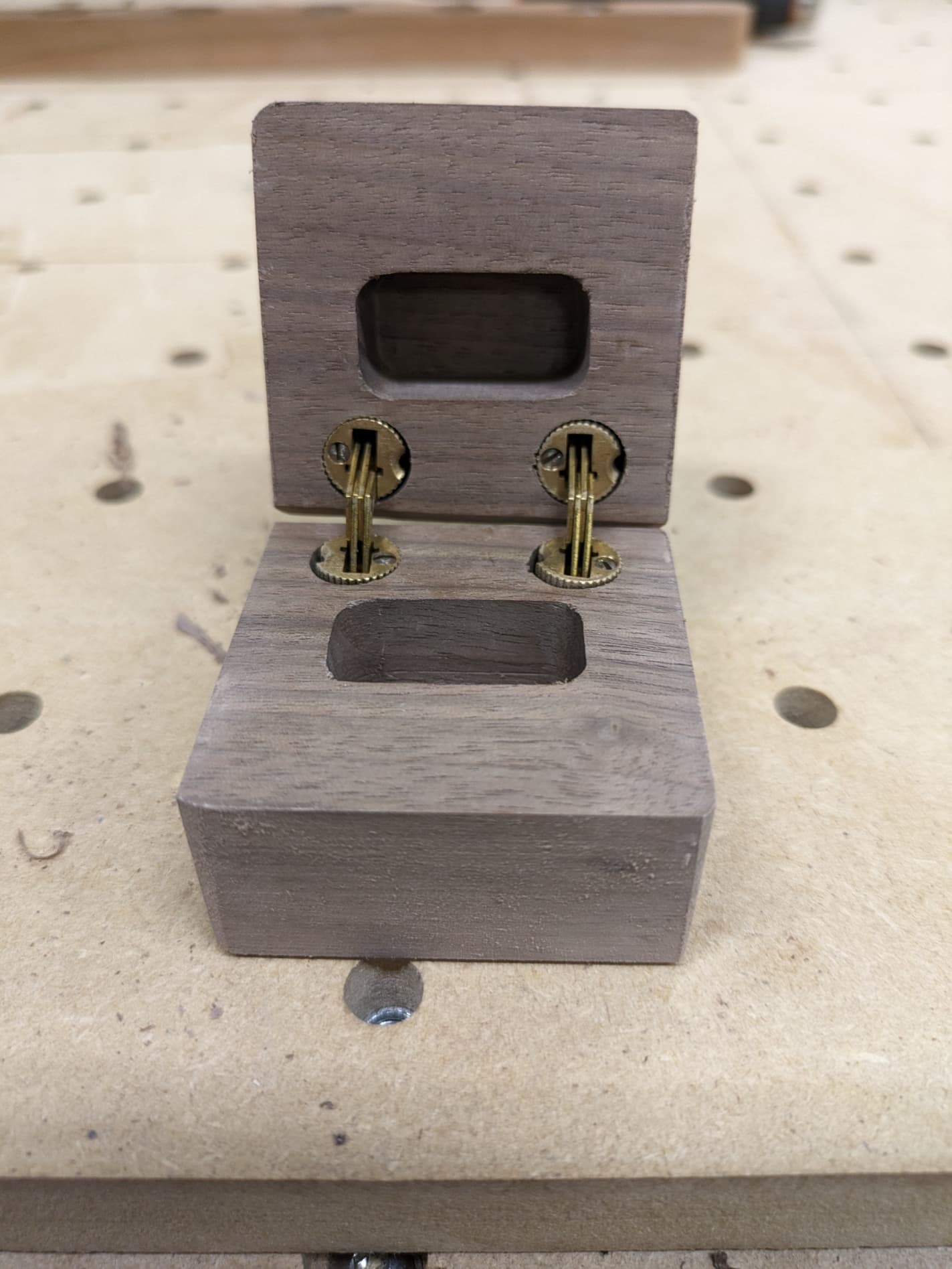

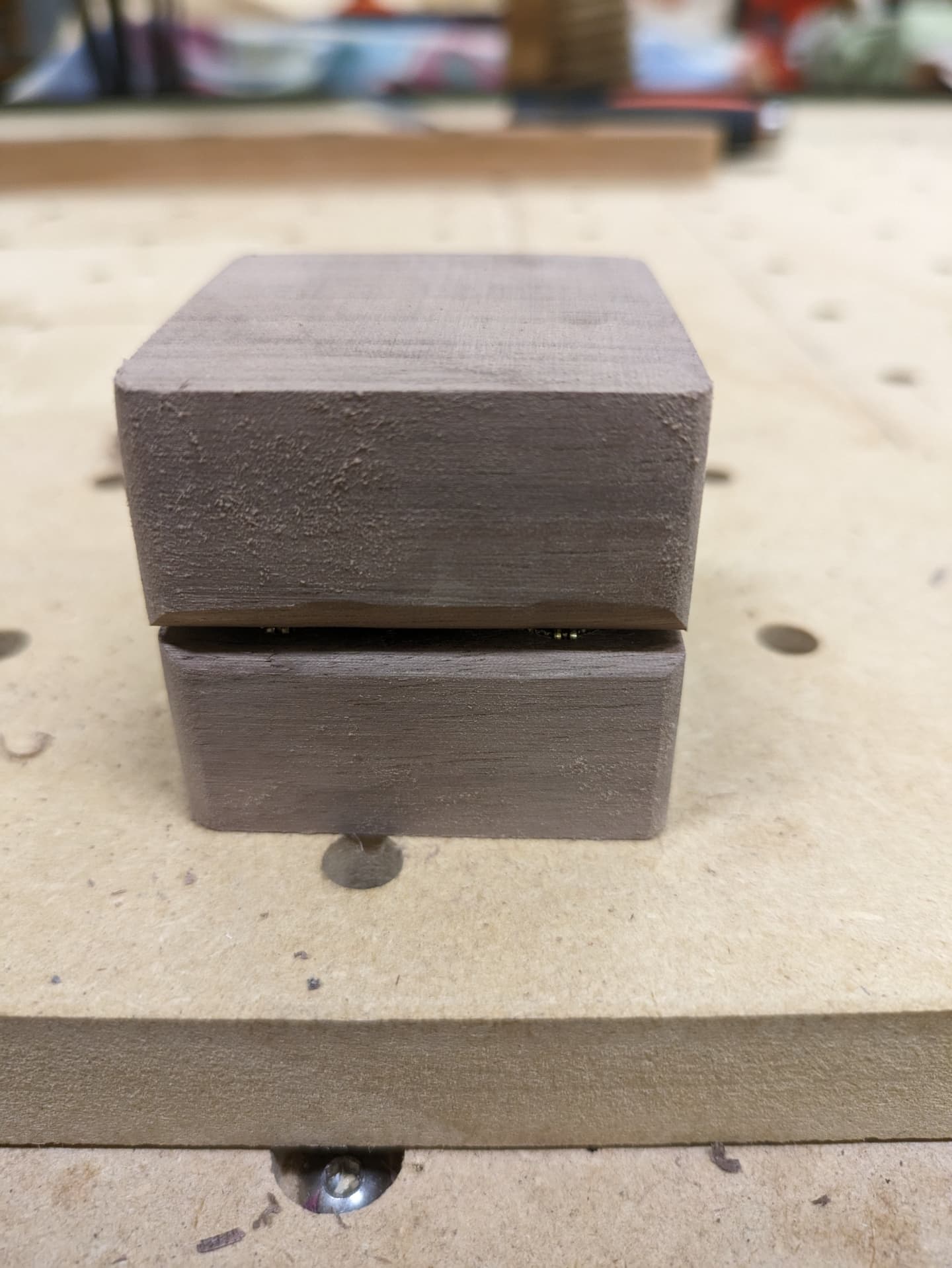

So I kept doing a 0.002" offset until I got the holes just right. Here is a few shots of the ring box unfinished and initial sanding done. I rounded over the back top and bottom of the two halves so the barrel hinges open properly.

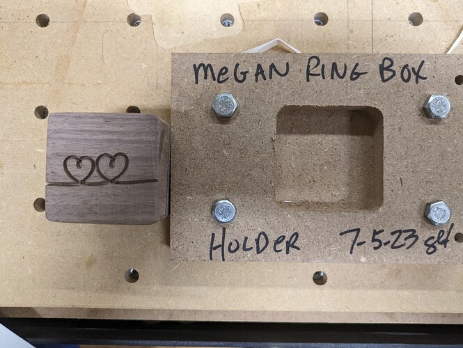

Now on to sanding and finishing. The first one I made I put the bride’s name on top. I did not like the way the epoxy filled it. I think I will seal it with shellac and then paint it white or red. The white would match the box but the red is more heartsy.
The box top engraving was done with a 15 degree vee bit. I let the line run over the sides of the box.
The barrel hinges fit well but when final assembly is done I will put some Titebond Medium CA glue in there for belts and suspenders.
