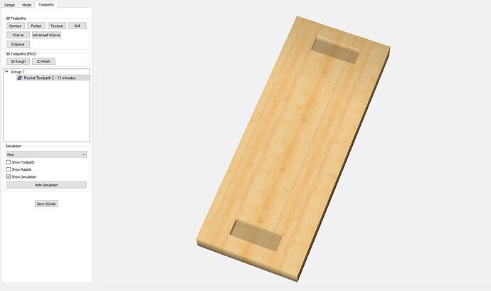

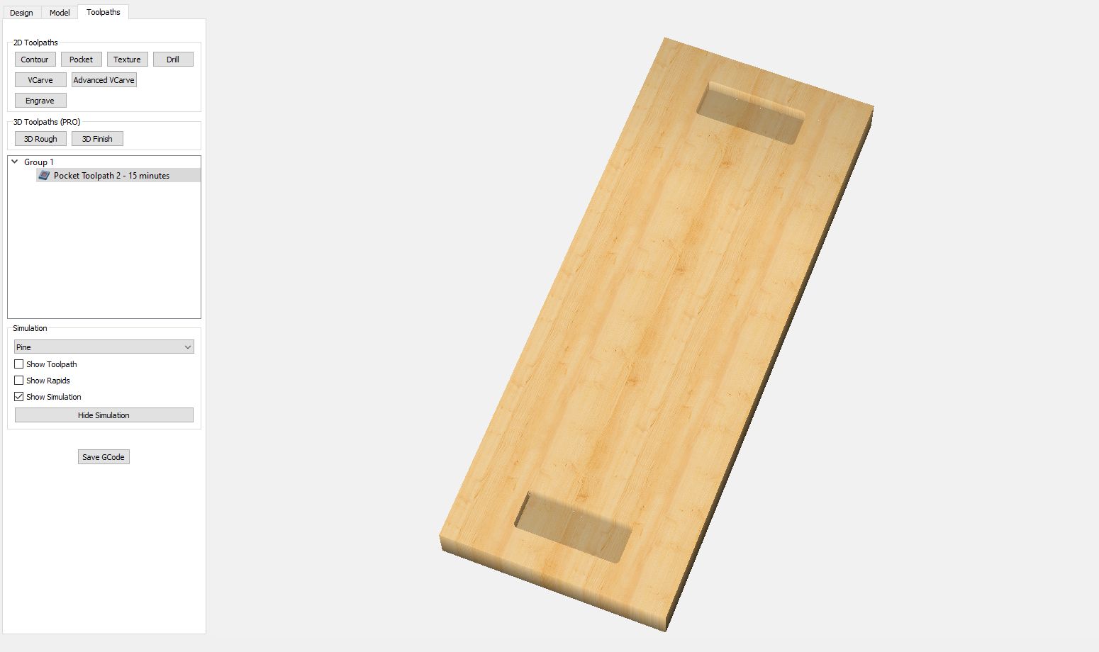

I am trying to cutout these rectangles using the pocket toolpath. They are to be centered in the workpiece. But everytime I make the cut they are not centered. Worse, they are off centered in opposite directions. Everything else about the cut is accurate. Depth, dimensions all good., just not centered. Any ideas?

I have remade this file several times. Two boxes, single box. Vertical layout, horizontal. All configurations result in off center cuts. The cut outs are 3.25” wide. The material is 7” wide. There should be 1 7/8” of material in each side. There’s 1.75” on one side and 2” on the other.

I’ve thought of that, since there are 2 rectangles needing cut out I can’t do that because even if I cut one rectangle and then spin it to cut the other, they’re off center in opposite directions. My material is the exact dimensions I inputted.
