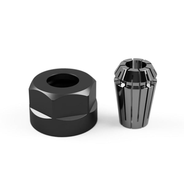

Source for spare ER16 Collet Nuts
Does Carbide 3D offer spare ER16 Collet nuts for the 65mm spindle ? Or if not what’s the aftermarket recommendation for one with the correct threading?
I bought a few additional MariTool collets for my 5 Pro and I’d like to pair them up with nuts to make tool changes a little quicker. I found a few prior posts but nothing definite. Thanks…
Do yourself a favor and reach out to Ron at Precise Bits, you will learn more that you ever need to know about, collets, nuts and deflection. A wealth of knowledge. They have three different levels of accuracy with their Collets and Nuts.
We now have ER-16 collets and nuts in our shop:
Thanks…does this mean the nut isn’t sold separately, only with the collets? Probably for the price it isn’t bad to have some spare collets, just making sure.
Correct, only sold as a pair.
That said, Collets and Nuts should be considered a consumable, and one should keep spares on hand if unwilling to wait for replacements from the magical land at the other end of the FedEx/UPS/Amazon/DHL van.

There’s a few ways collets and nuts fail over time. Most shops I know that track it use an hourly range and/or track runout and physical signs.
So you can track runout and it will get worse over time. How long? Depends on the cutting forces and the tightening torque. This is probably the most reliable but requires measurement equipment.
A simple thing you can look for is in the bottom of the nut and the short taper on the collet. Over time those surfaces will wear and/or get material stuck between the collet and nut tapers when tightened. Some wear is fine and not going to do much. However, if you have transferred metal on the short taper of the collet or swirl marks in the nut taper those are bad. This is probably the most common failure we see.
The collet can also get “sprung” an easy way to tell this is to take the collet out of the nut and put a correct sized shank through it. You should not have to “force” it in. It should be minor or almost no resistance. It should also be consistent in the friction it produces inserting the tool. This one is not as critical but is is a sign that something bad will happen soon or that it’s going to start wearing more quickly.
On the collets you can also sometimes see other wear signs. Typically either “rings” at the same depth of the collet, or fretting across parts of the collet. These CAN be caused by spindle issues. But it’s much more likely that they would be from a worn collet.
Something that you can see in odd cuts is if the tool starts breaking at the face of the collet. Pretty much any cutting tool should be weakest at some point in the flute or carryout (ground part behind the flute). If a tool is breaking at the collet face it is “pinching” somewhere in the collet and allowing the tool to “wobble” inside. That over time breaks it at the collet face.
The other obvious ones are that you no longer have enough slip resistance. Either the tool pulling out or the “spinning” inside the collet. That one’s pretty obvious though.
That’s the ones off the top of my head. Let me know if you want more details on something.
