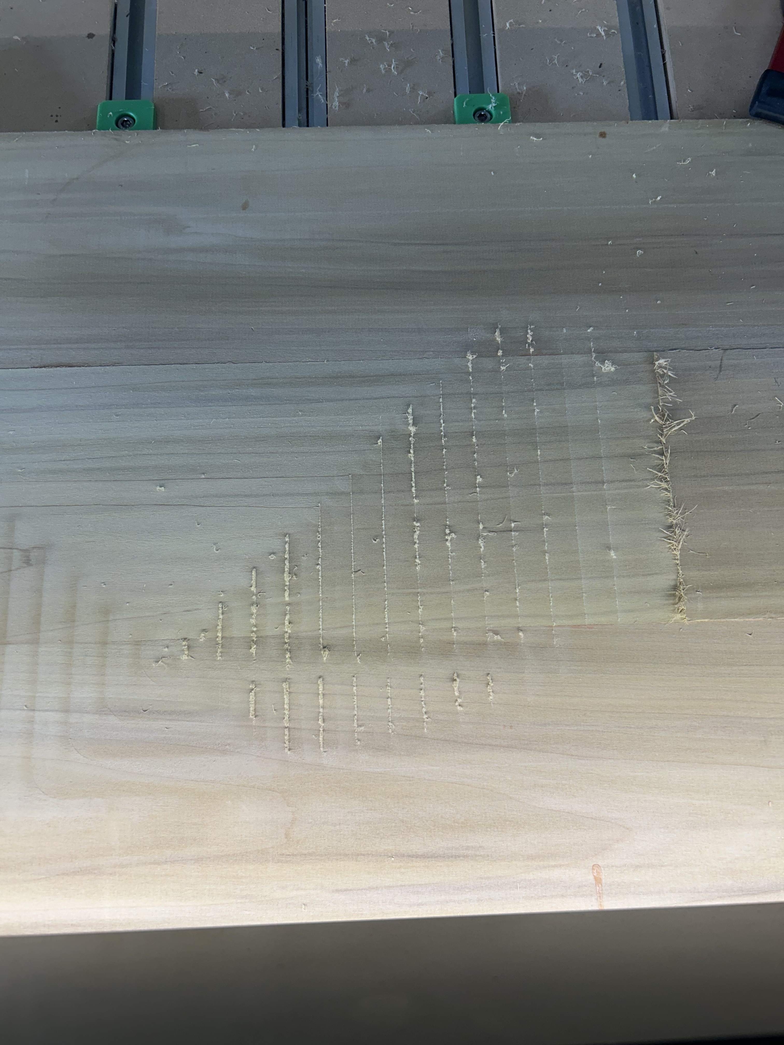

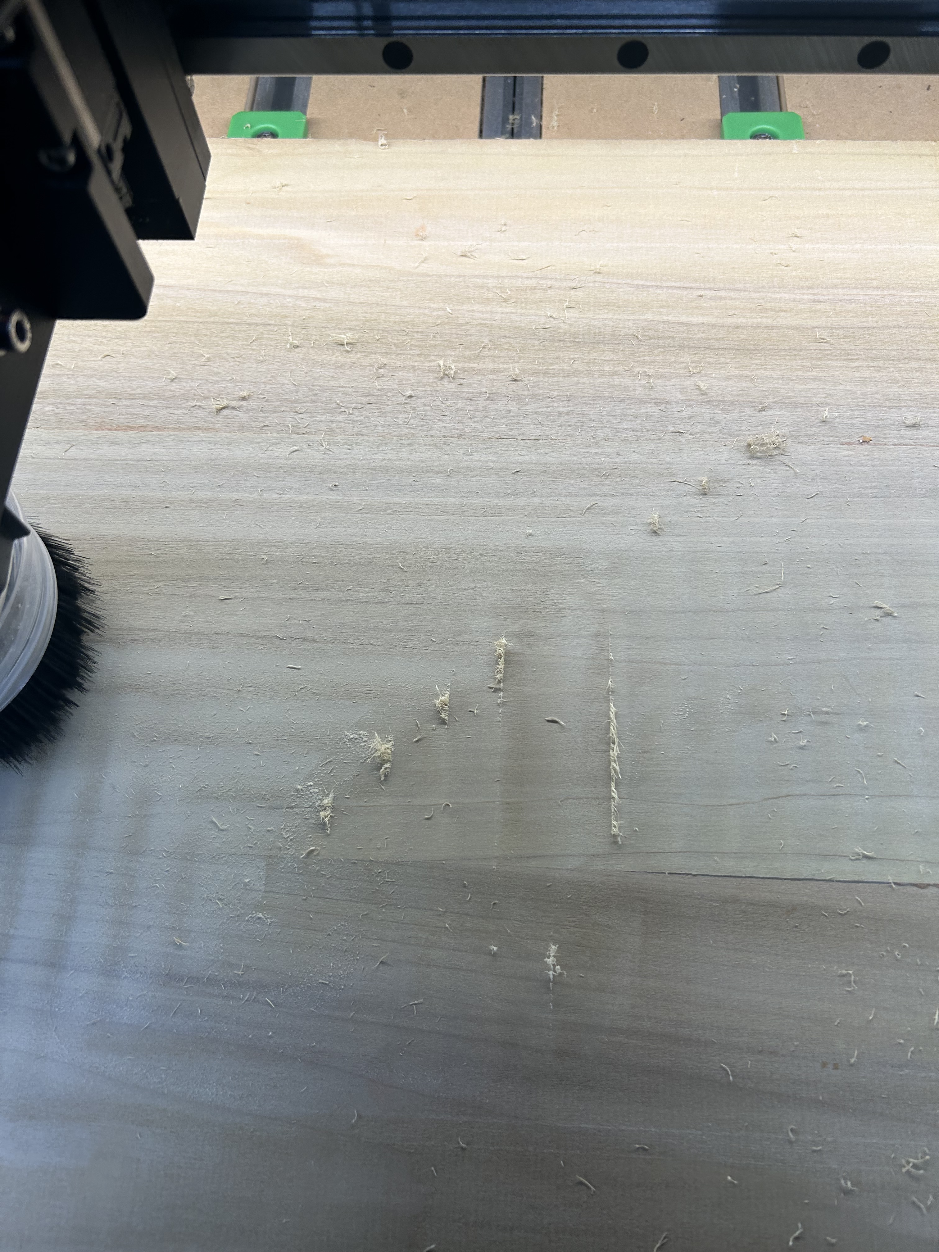

Any using the SpeTools W05004 surfacing bit?
I am not getting good results with this bit. See picture.

Your router/spindle is not vertical. It appears to be leaning over to the left at the top of the router/spindle. You need to ensure that it is vertical in the front to back plane and the left to right plane. The process you should undertake is named ‘tramming’ and here is @wmoy to explain it.
Got it straightened out! Thanks.
No worries. You’re very welcome. I am glad it has helped.
