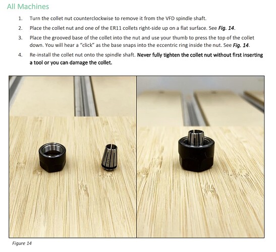

Is it me or are the collets that come with the VFD spindle kit too small for the 1/8 and 1/4” bits?
#1) I put the collet in first and then I can’t get the bit in.
#2) I can get the bit into the collet and then put them both in the spindle. And then screw on the locking nut. Just doesn’t seem the same as when I put the collet in first sing my Makita router.
Please confirm the way #2 is safe?
Thanks
Mike
#2 is not safe, and is wrong, and could damage the collet, the tool, or the machine.
You need to snap the collet into the nut as noted in the instructions.
Gotcha. Thanks pal! I see that now.
