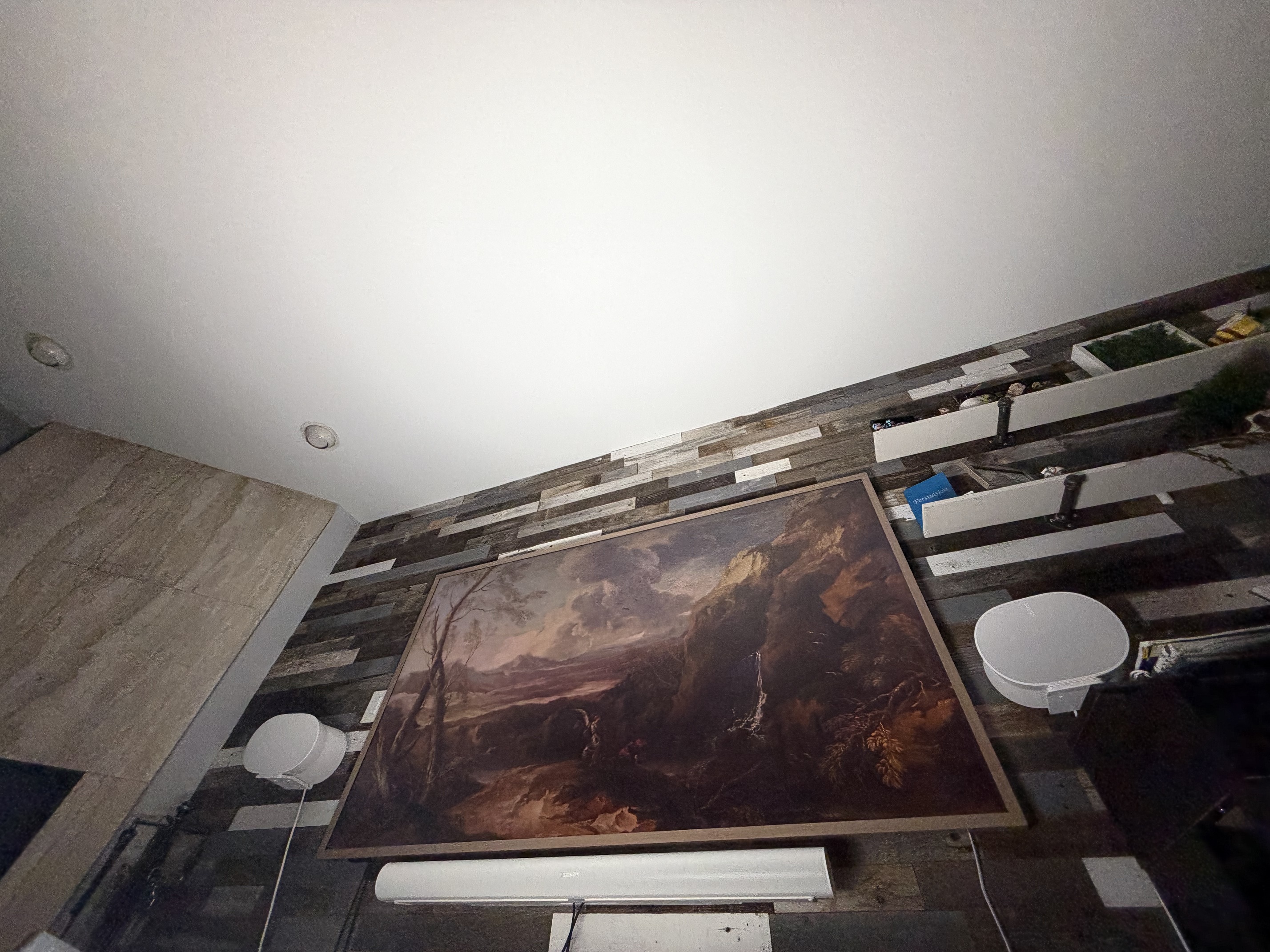

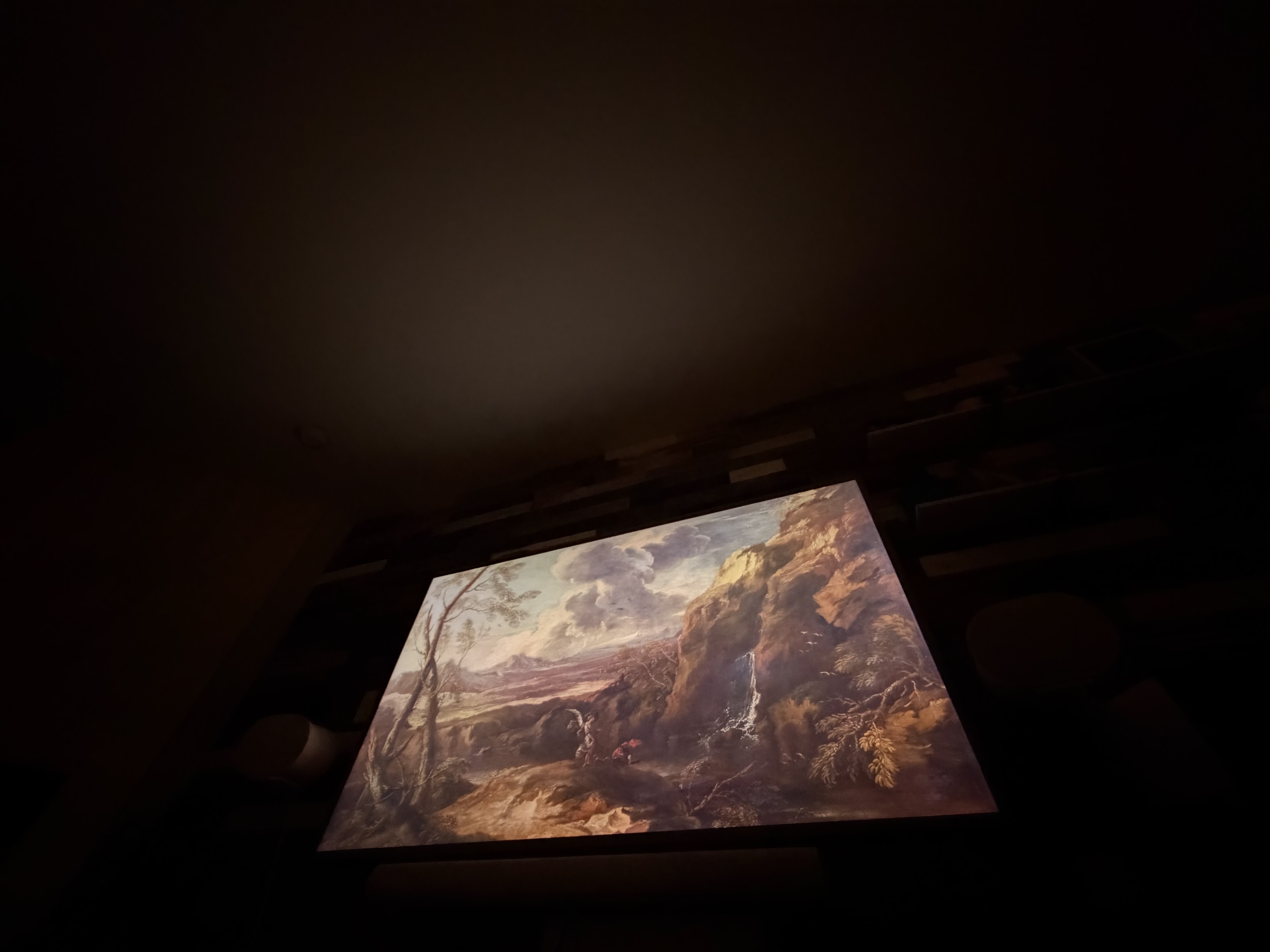

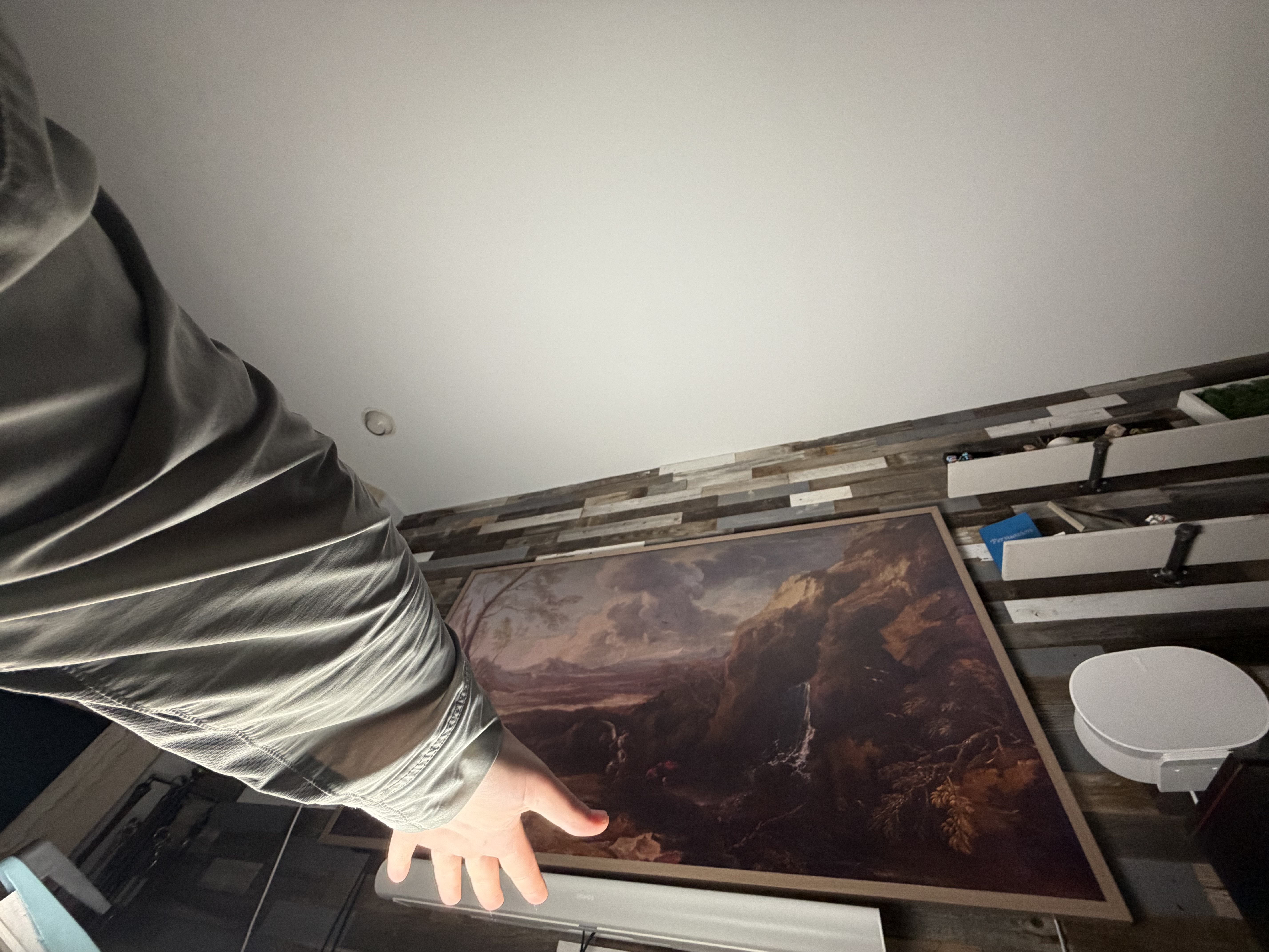

Small tangent to the post, here’s some output from the highly diffused light panel i put together
The lightning is diffused enough that my arm doesn’t cast a shadow. I need to make a few smaller ones for the work shop. This one puts out about 10,000 lumens after diffusion. I wanted it to run about 6000 lumens which puts the LEDs at 60% power via pwm (20,000 hertz so there’s no flicker whatsoever)
Dimmer is a slider pot since I though it would be more fun to interact with than a more traditional rotary :slightly_smiling_face:
I’ll make a post about the details if/when I get around to making one on the machine. Or maybe I’ll do a small write up when I make a couple 8”x8” lights for the shop…maybe this weekend :thinking:
