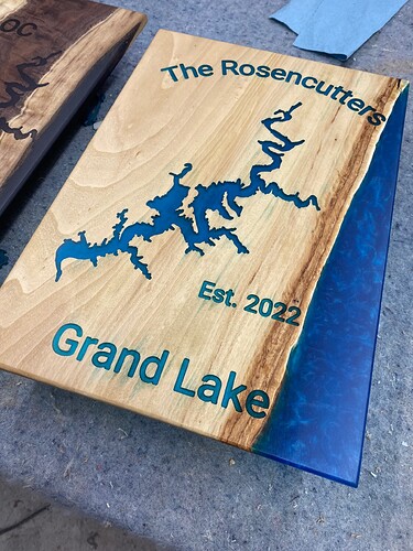

Hello everyone, long time listener first time caller. Wondering how to start a new carve at a pinpoint location. I have a carve already done and need to add to it in a very specific place. Thanks in advance.
Where was the initial carve indexed from? You will have to find a known location, or several if you also need to align it, on the original carve & set your XYZ to that location.
When “zeroing” you don’t have to set zero. You can type in the current location. Using a Vee Bit is a good way to get it pretty accurate.
Outstanding! Thank you Todd. Makes sense.
No worries, Jonn :wink: Pictures?
