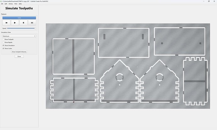

When I first opened your file, the tabs weren’t showing, but once I rebuilt them in the current stable version, 853:

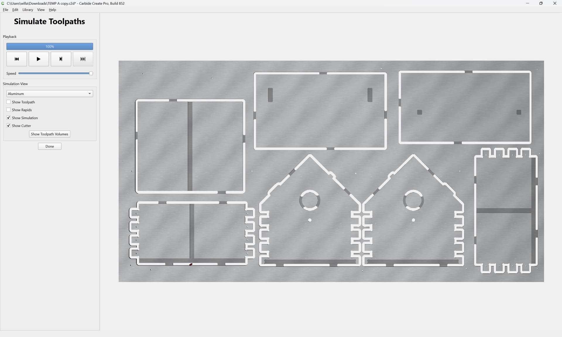

the tabs show as expected:
Like I said, sometimes they do and sometimes they don’t. (Several decades ago I had some experience in software support and I guess I’m the kind of asshole that used to drive me crazy :slight_smile: )

A given preview should be persistent for a given version once toolpaths are calculated, so if you have a file which doesn’t show tabs for the current stable version, please let us know.
