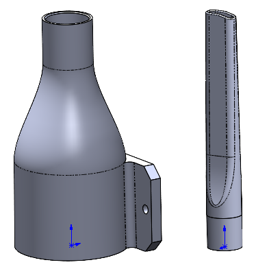

Sorry, I don’t have access to Cutrocket so I’m dropping the screenshot and zipped STL files here. Mods, if this is inappropriate here, my apologies.
I have a 5gal Stealthsonic, which has a 1-7/8" hose and attachments. The vacuum wand is too large to conveniently vacuum the nooks and crannies in my Nomads.
I am a long-time CPAP user and I realized that its hose is nice and flexible while being spiral-reinforced just like vacuum hoses. So I designed and 3D printed a reducer and mini-vacuum wand to adapt the Stealthsonic hose to a spare CPAP hose (they are available on Amazon for less than $10).
reducer+nozzle.zip (642.9 KB)
The reducer has mounting ears (with holes sized for Strongtie screws) which I used to screw it to the edge of my butcher-block workbench top. The reducer STL has a built-in snap-off support to support the inner overhanging lip (I thickened the wall at the bottom edge of the transition to better smooth the flow into the larger hose), so both models can be printed upright as shown with no supports. Use a good brim on the nozzle to keep it anchored.
I printed these in PLA+, .4mm nozzle, 4 layers all around so both pieces are essentially solid-walled other than the thick mounting ears of the reducer.

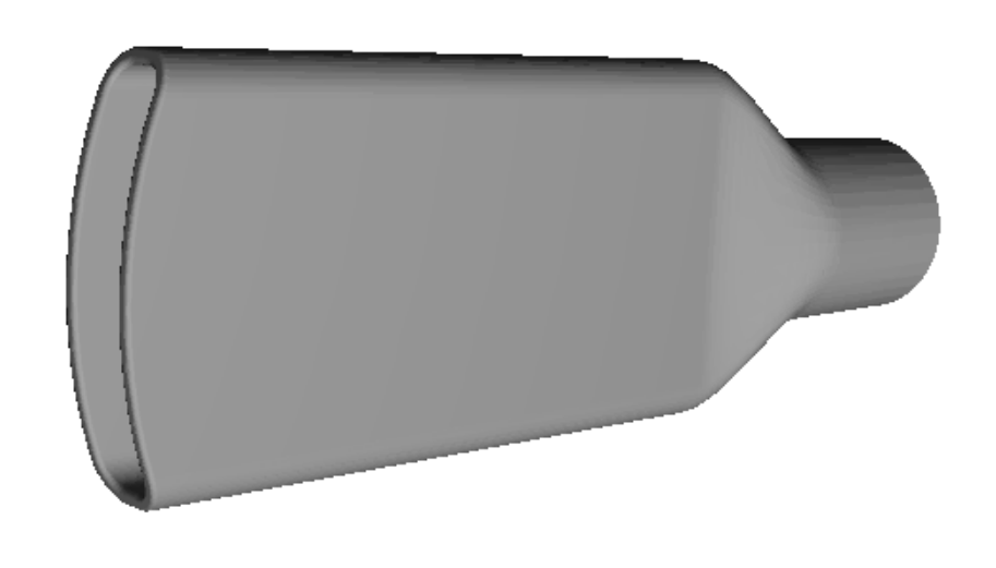

Here’s version 2 of the nozzle. Shorter and broader than the original, roughly the same inner cross-sectional area through its length.
Zipped STL file:
nozzle2.zip (340.0 KB)

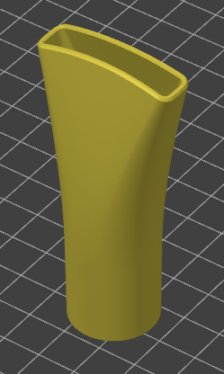

Here is a specialized nozzle for vaccuming through the Nomad’s Y axis slots
slotnozzle.zip (231.1 KB)
